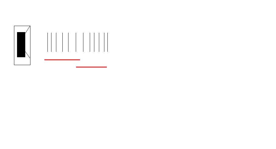

Thanks for the corrections. Uploading some diagrams
The diagram shows a short pulse of sound. Assuming this is from a 6 inch woofer, the pulse duration is very short, and shows one compression and rarefaction. The illustration highlights the short time scales in question.
Given the millisecond pulses involved, I am almost sure that sound is processed and interpreted by the brain, not in real time from short term memory. This has no bearing on sound quality, except for reflected sound, where the reflected sound and the original sound arriving a few fractions of a second earlier is stored and processed as a whole.
Anyone know any references in the literature?

You are on the right track with your assumptions, investigation and questions. You will notice that as you delve deeper into the details, the complexity tends to explode.
I will give you another detail to contemplate:
Obviously, music is not a pure sine wave, it's a combination of different frequencies with different duration and amplitude each, constantly changing, all being reproduced by the speaker's diaphragm. (well, in a multi-way loudspeaker, different drivers reproduce a portion of the audible frequency range).
Now, consider the woofer diaphragm reproducing a low frequency tone as well as a higher frequency tone (say, 70Hz and 500Hz). The diaphragm will superimpose both tones and vibrate both at 70Hz and 500Hz. This translates into an oscilating source (oscilating at 70Hz) producing a 500Hz tone, causing the well known doppler effect, where the higher frequency is sounding even higher pitched when the diaphragm is moving towards the listener and lower pitched when the diaphragm is moving away (back). This causes a vibrato like, flutter effect to the sound that can be called inter modulation.
