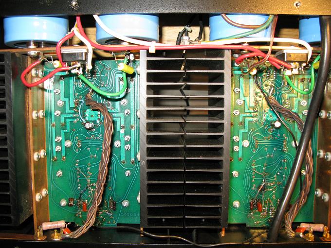

Here's a picture that may help.
The black wire at the bottom is jumpering together the 0V points of the two channels' PCB's. The points at where it connects to the two PCB's are also the points at which the input jacks' shields are connected to the PCB's.
Then there's the second thin black wire that can be seen running alongside the braided output wire on the right. It connects the 0V point of the left channel PCB to the star grounding point in the center of the copper ground bar (the stack of nuts between the filter caps at the center top of the picture).
At the lower left and lower right you can see where this bar wraps around to connect to the - speaker binding posts. On the sides (not visible here) there are some case screws that bolt the case sides to the copper bar. Those points are not insulated.
By the way, I'd be curious to know how much idle noise others are seeing at their speaker terminals with everything hooked up but no signal. What I'm fighting currently at this amp is about 10mV, with the current patch cables, with the amp grounded. This drops to just over 4mV when the amp's ground is defeated.

It looks OK to me.
That is one hell of an earth wire !
I just use a piece of 13 amp mains cable for mine.
How much nosie do you get with the input shorted out ?
Yeah, the copper bars they used in here are pretty neat. The + and - rails use them as well.
With the inputs shorted, or open, I get about 350uV A/C at the outputs.
The problem I'm having isn't a ground loop within the amp (at least, I don't think it is)... it's ground loop between pieces of equipment in the stereo. I mean, literally, there's a loop: crossover ground through patch cables to amp ground to wall plate ground through mains wiring back to crossover ground again.

It might be worth trying a ground lift switch in the amp.
On my setup I have a dual cd player going into a mixer then into a power amp. I know the CD player and mixer arent grounded so I only need a ground at the amp.
HAve you tried removing the zero volts connection between the amps and just relying on the connection to ground ?

The problem there is the ground bar being screwed to the case. I'd have figure out a way to insulate its mounting points so that I could separate the case ground from the power supply / signal ground.
No, not yet. I did, though, measure the voltage difference between the outlet ground where the amp is plugged in and the one where the crossover is plugged in, and that was less than 1mV... with the meter wires stretched out as they were, a lot of that 1mV may be getting picked up inductively anyway, so I'm not sure if I can get a good measure of any difference in ground levels.
I think the next step is definitely to put the PS Audio back in place (got the Adcom running right now), and play around with different options for connecting the shields of the patch cables.

Well, I'm done-ish with the amp for now.
I played around with the cable shielding a bit, and managed to shave off a couple mV of noise there. The final solution on the cables was a bit rough, though, and I probably won't leave it in place: 1K Ohm termination inside the headshells on the amp end. The crossover's designed to drive 600 Ohm loads, but still....
Even with that, I was getting more ground loop noise than I wanted, so I bit the bullet and rearranged things a bit until I could plug all the grounded equipment (except the Bryston) into one 6-way on-wall outlet adaptor. This helped a lot and brought the insertion noise (with crossover turned off) down to about 150uV (e.g. with the inputs disconnected I get about 350uV noise at the outputs; with the inputs connected, but the crossover off, I get about 500uV noise). Oddly, with the inputs shorted, I get about 450uV noise.
The noise of the power transformer humming is now much louder than any noise from the speakers, and is likely the next thing I'll be looking into. (any suggestions there? It's an EI transformer, and any replacement likely would need to be as well, to fit).
