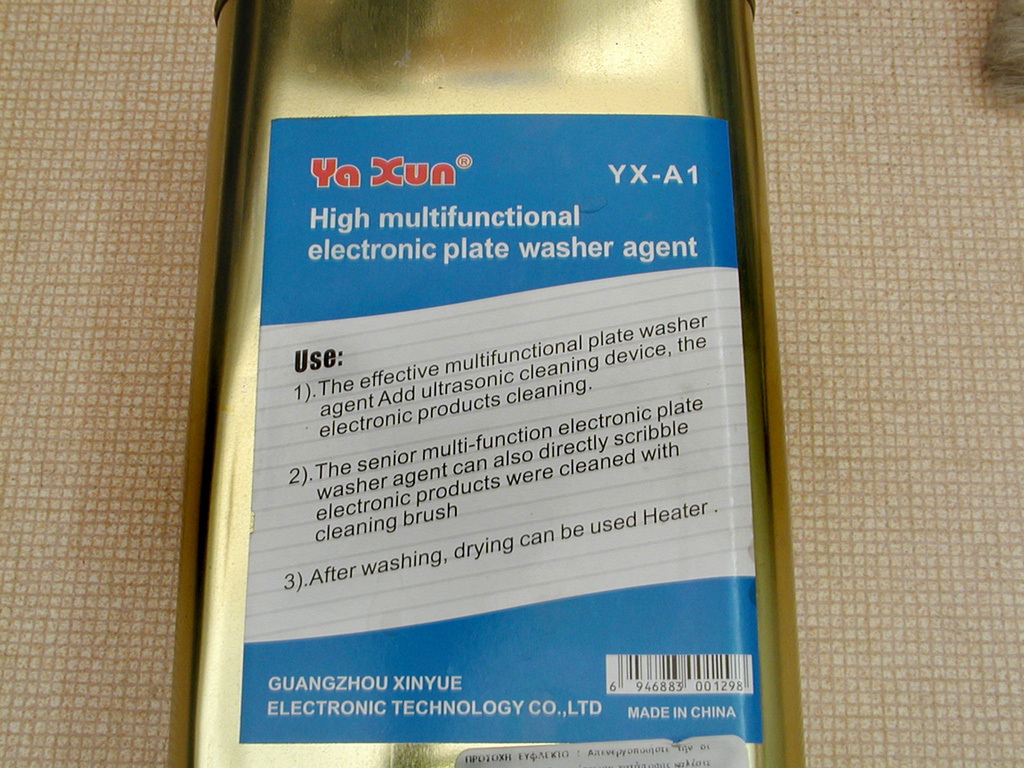

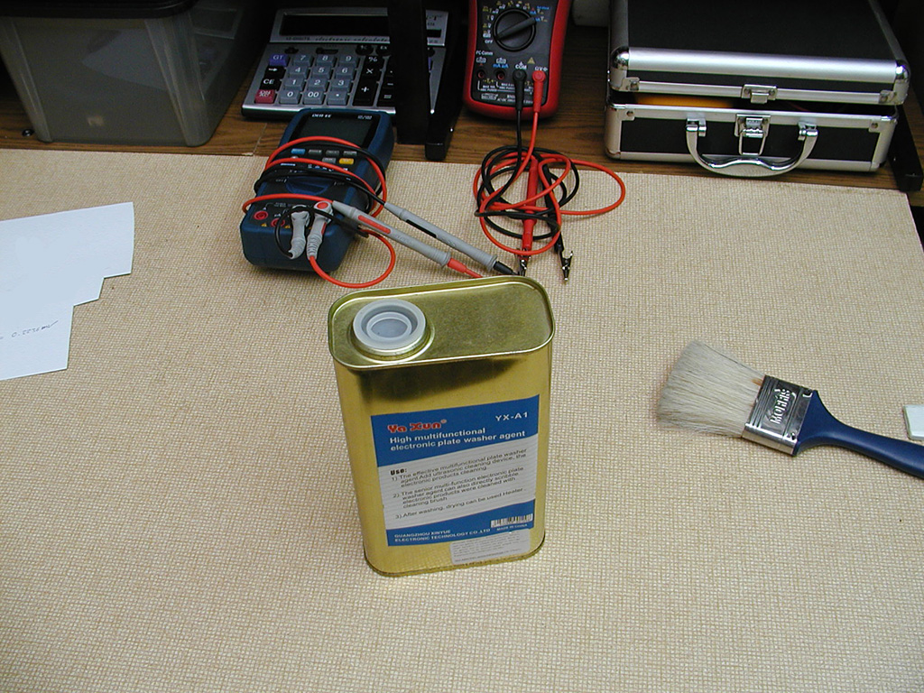

Basically if you are using flux of basic chemistry? cleaning is easy with just Isopropyl Alcohol.
But modern and more complex in chemistry flux, that is specialized for rework has sticky residue and needs a more strong cleaning agent.
