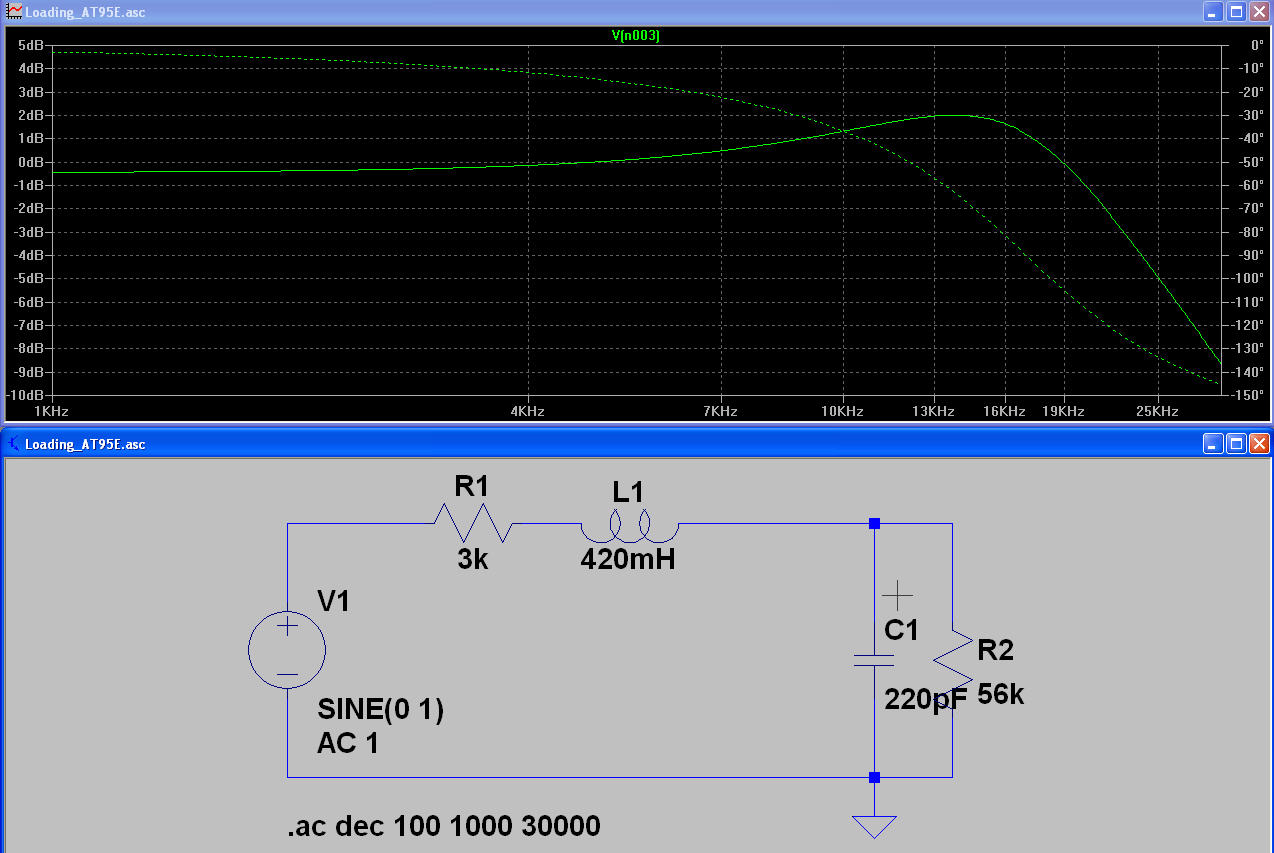

One thing that really can color the sound is how well you load your cartridge. I have measured my cartridge to be 3k 420nH. Together with total capacitance and load, which for the moment is 220pF and 47k, I get a slight raise in the upper frequencys and a drop off before 20khz. It's all easy to simulate.
If I use 56k as load I get a small peak, about 2.5dB at 14khz and drop off starts at 19kHz. This sounds very pleasant. Some of my more dull sounding vinyl's sound better. But is it "the right thing to do"? Maybe i should use graphic eq instead? :)
One thing to strive for with a mm cartridge is to have as low capacitance as possible, so we don't get the peak below 20kHz.

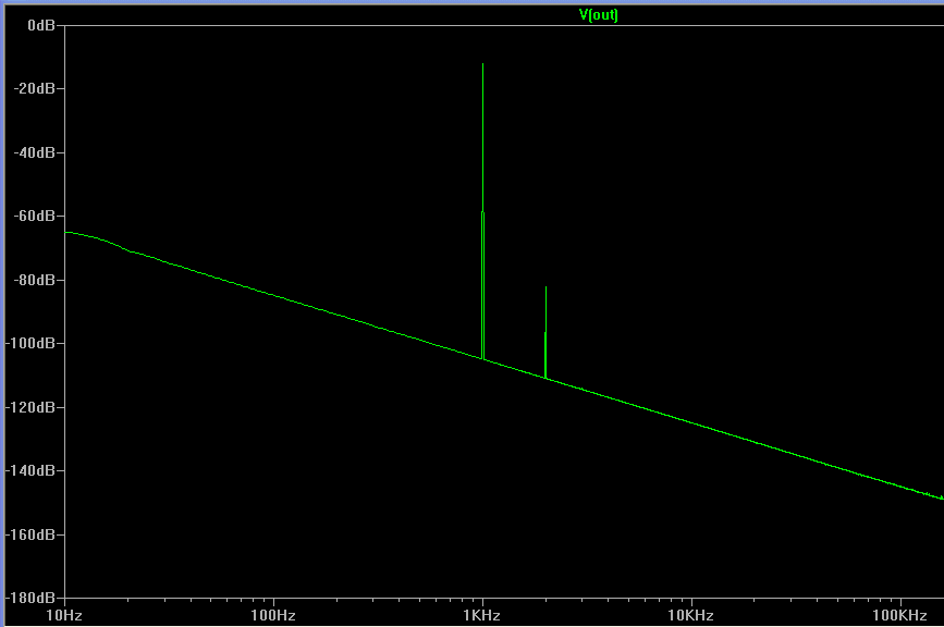

I suggest a 100k trimmer instead of an initial fixed load for finding the best tone for MM sometimes I have been asked. 47K is just not universal and since MM is counting on an electrical resonance to extend to last octave its easier to play with resistive load than adding and subtracting capacitance. So I think you did well to play there. Even less residual Miller gives more leeway with an input load trimmer. Use nominal output of your cart to gauge THD. The Hagtech includes the ''lost constant'' and measures flat with the 100R. The Lipshitz would show a rising trend. With MC carts that extend and even rise in the last octave I have experienced that resistor introducing harsh overtones. With an MM it can be compensating brilliance loss and mixing nicely.
P.S. Is view FFT after running .tran for this particular CCT giving you something like that in the pic BTW? The stock Mad runs higher gain and 2ndH due to no Rs but can play some happy output MC. Better with Rs and MM. Cuts on Miller too. What is your cart model?

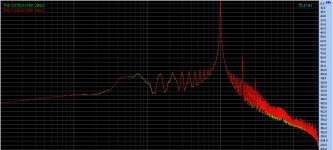

Low THD
Hello again

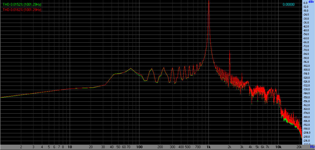

46dB amplification. 5.0mV gives 1volt RMS = 0dBV. As much as my M-audio soundcard can take. Real world figures with the Hagtech style Inverted RIAA in between the soundcard and the amp. 0.015 THD is pretty good :) for a two stage amplifier without global negative feedback.
Regarding the FFT I havent had any succes yet, using the LT Spice. I have to read and learn some more. I can't see any FFT icon in the view tab after a .tran. :confused:

Looks like the measurement FFT with the LT prediction I posted are in same ballpark for 2ndH. You got PSU and/or ground loop issues with harmonic noise I see also.

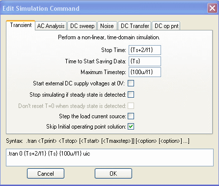

Try .tran 0 {Ts+2/f1} {Ts} {100u/f1} uic .param f1=20 f2=20k showst=1700m Ts=7000m freq=1k
Hi Salas and thanks for the formula.

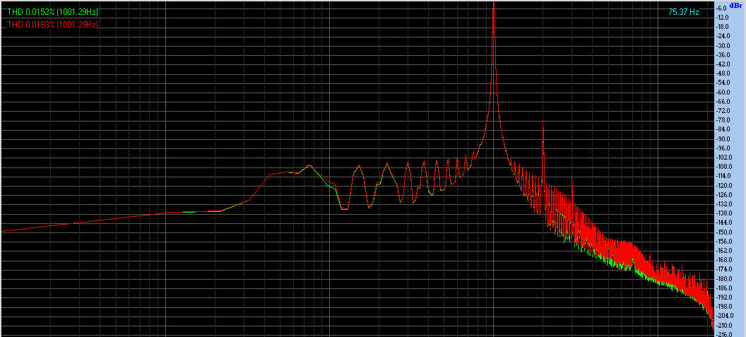

About the groundloop or PSU issues, I wouldn't call it an issue of any large significans. The rubbish to the left is around -108dB and it doesn't start with 50 hz or 100 Hz from the PSU. It starts at 75 Hz and then the multiples 150 300. Then there is a 225Hz with multiples.
I have the card un boxed, laying with cables on a table ftm. I can't see how I can get rid of it. I attached a better screenshot where the racket at the right is OK and undisturbed of mousemovements when I snagged the screen.
Batteries or my PSU is the same. Unmeasurable rippel. It means the same as no battery or PSU around 50uV.

If its in the measurement loop and its verified external thing its OK. I got worried because when I see low or higher comb teeth effect all over the FFT window its oscillation in the PSU if not in the audio circuit. Especially if to the right. What kind of PSU? Also if you just loop the card by itself does it still show a ''busy'' noise floor?
To see FFT in the view menu in LT you first hit the running man, and after having analysis results, you should left click on the analysis window first.
Interresting Salas
FFT looks the same with battery.
Anyway, FYI, the PSU is well filtered main inlet and then I drop around 10Volts over RC, RC, RC before a LM317 with 10uF Tanthal on adj. and output.
At 20mA I get absolutely unmeasurable rubish on the 24Volt. Tried with both scope and a new Fluke 289 True RMS DMM.
The card is totally clean when I loop without anything.
But... I found the source of the pollution to be my Inverted RIAA Box, probably loading the soundcards output or ... I don't know yet.
Can't get that one to work. "Unknown parameter on .tran card: "ts+2/f1"

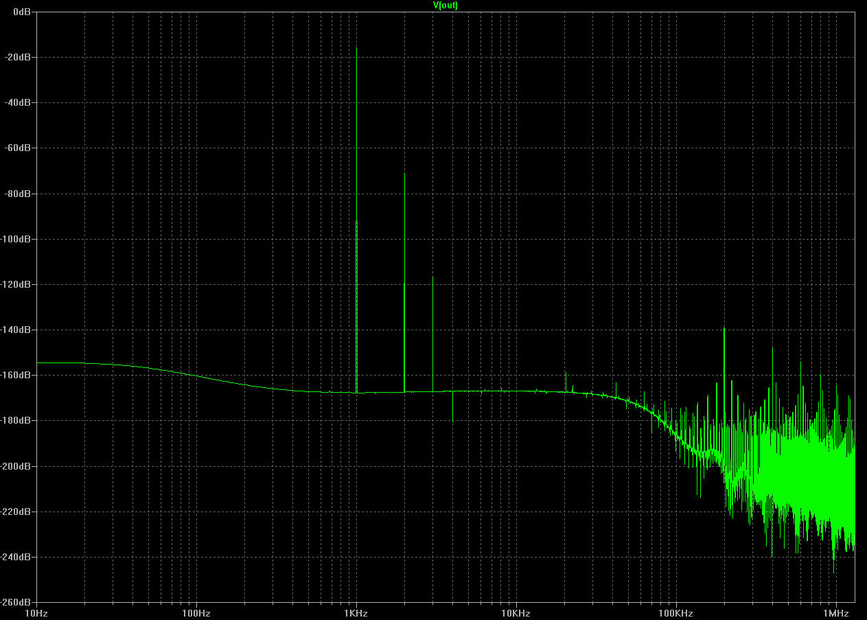

I post the .tran window as it shows on LT Spice.
I averagely get 0.02% THD for nominal input in the 0.5mV 56dB MC Simplistic, never built any Pacific so I don't have measured figures. They are different in key areas though. Simplistic CCTs.
High second is veiling detail in my experience, more linear before NFB CCTs retain better subjective expression and don't change character after some NFB than originally worse ones, but beyond 9dB global NFB they tend to shrink image size, not altering tone by my experiments. The lesser ones tend to harden.

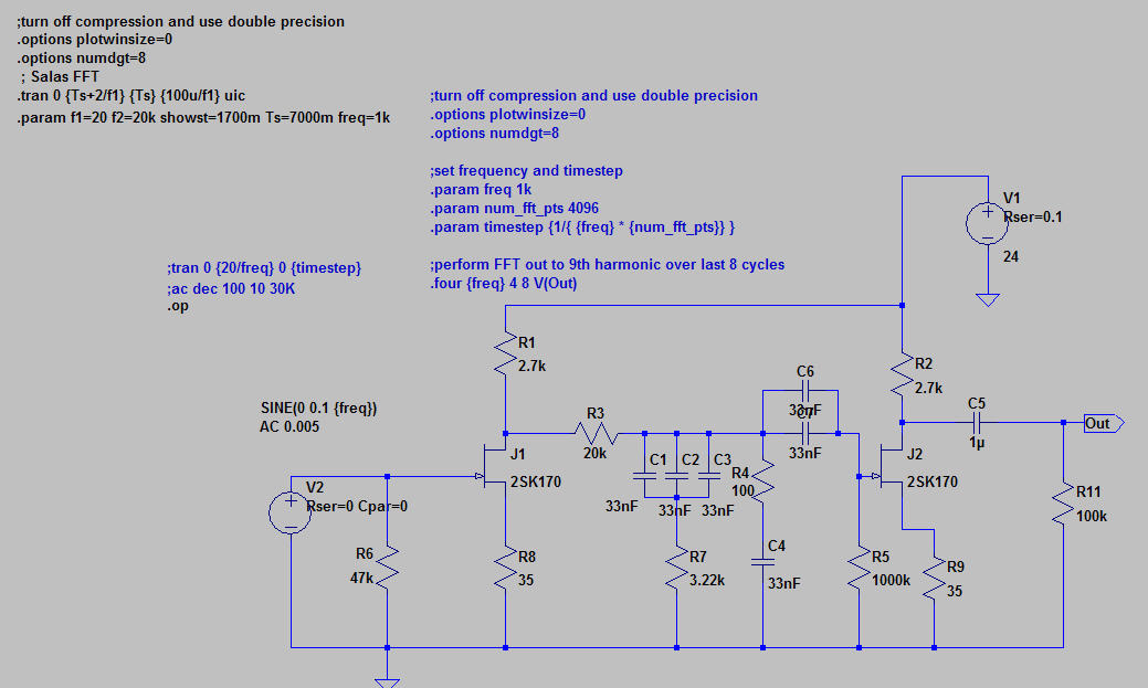

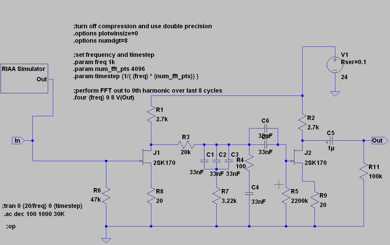

My sim is not OK
Hi Salas
Finally I understand a very little bit how to use LT Spice. I attach my result from the parameters you suggested and the schematic as it is now.

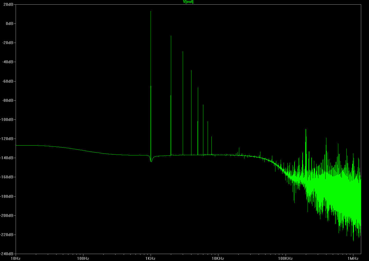

AC responce looks OK and DC operation also seems fine with the right voltage at the drain on both FET's. But the FFT ... :confused:
Something is wrong. I use ideal values on the passive components, exept the output cap.
Found the error
OK
I give this one for free :eek: :)
The problem is a to large signal at V2 on 0.1V when it should be around 0.0035 (=3.5mV) I got confused with the settings for small signal AC setting which I allready have set att 3.5 mV.
The FFT now looks like attached picture below. This is in the ballpark compared to realword and I'm really amased that it is :cool:
Now, how can I proceed? Trying a BC550C cascode to even lower the input cap or...
This is addictive and fun. :p
