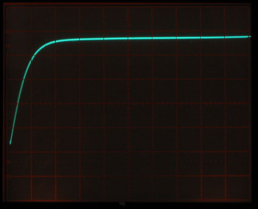

Okay, i've scoped the amp, the doubledarlingtonversion, without
any added cap... ~11 khz squarewave into 8ohm resistor.
Here is the first scopeshot, x: 10uS/Div y: 1v/Div
Mike
Thanks to Bodo for the scope !
And a 3rd scopeshot, x: 1uS/Div y: 5v/Div
I was not able to make this measurement for longer than a few
seconds, i have not biggest 8ohm resistor, it stinked...
Obviously the amp ran into slewratelimit, so tweaking necessary !
What exactly should i check according oscillations ?
The results look even better than in sims...
Mike

Don't misunderstand the results, the corners are always rounded,
completely independent of the frequency. It's just that the amp
needs ~2uS to settle. So, depending on the timescale you can
see the round corners just better...
This means even with a 1hz squarewave, the result is identical,
if using the same timescale.
The frequency is the same on all 3 shots.

On the third oscilloscope picture you attached I interpret the slewrate to be around 15V/uS, it's not "ultrafast" so I wonder is this correct?
Have you checked the rise/fall time of the flanks on the pulses from the generator when connected to the amplifier input?
Also how does the signal look at the base of diff input?
Edit: 100 Hz square wave is enough to trace with the scope and study rising/falling flanks of your amplifier in the beginning.

I'm not sure if the amp is limited to 15v/us, but it's not an impressive
value. With speed i thought more of delay, avoiding feedbackcaps.
The tripledarlingtonversion had much higher slewrate...
I checked output from squarewavegenerator, rise/fall was barely
visible on scope. I will check more details the next days.

And yes, increasing the Iq increases the slewrate, but with FC
it also lowers the gain, which is already a bit too low.
To avoid this, i have to increase current in LTP also, which gets
difficult with to92-devices. So i am considering to go back to
tripledarlington, or use CFP-LTP...
