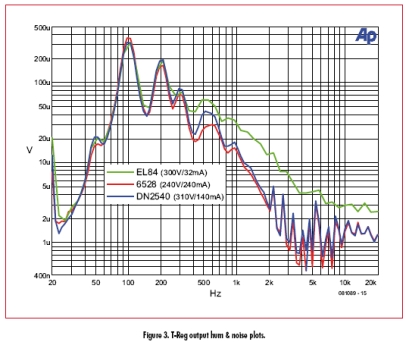

Thanks. Tubes have inherent noises that can hardly be overcome, but my goal is very simple: to find a tube regulated PSU as slient as possible for my preamplifier. It seems that the PSU used in HP instrumentation will satisfy this need.
I don't think it beats this:
jan didden
