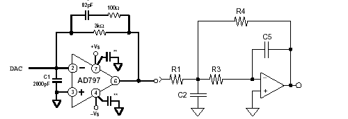

Practical. Very likely something like the circuit below, except the reciever will be differential and driven by a pair of I-V converters. I will probably not use AD797 for the reasons offered by the people here as well as cost. I am leaning away from a discrete solution if only because accurate noise measurements are difficult and an off-the-shelf opamp at least gives me some ballpark noise and THD figures.
I believe C1 is attempting to shunt HF noise to ground.
The Butterworth filter below is from the Crystal AN48. They used rather small capacitors (220pF/1000pF). It seems to me that capacitors in the nF range would be easier to spec (less parasitic capacitance, easier to obtain tight tolerances). Is there a reason for using pF values?

NOISE
Hi Tiroth,
The practical circuit you gave makes it much easier to discuss.
You can design the lowpassfilter <B>MUCH</B> more easy with FilterPro(R) now from Texas Instruments (was Burr Brown).
www.ti.com
You can even make the first "pole" in the IV-converter. If you want low noise you have to use low value resistors in the range 1k-2k or lower. Let the program calcute for you capvalue's and see how you get in the pF values. If you use caps lower than about 50 pf stray capacitance in the circuit spoils things, as your values aren't accurate any longer.
Discrete circuits like Sonnya's folded cascode with JFET inputs sound better and can be low noise too. See this forum. Of course discrete takes up more boardspace. Discrete or IC, both can be low noise. What matters to me more, is <B><I>soundquality</B></I>. Measurements mean nothing to me I just listen to the music and the circuit and if I like the result I keep it that way.
Thanks Elso. That is some nice software. I am planning on sticking with 2 poles, as the OOB noise attentuation is acceptable and the phase variation is less pronounced.
I still have a question about capacitor size though, because the ratio K=C1/C2 is more important than their values. i.e. I can choose C1, C2 in pF or nF range and get acceptable resistance values, but is their a reason to prefer smaller/larger caps? I can easily obtain film caps at 2% tolerance for values >=1nF, but such accuracy is more difficult in the pF.
If larger values are fine, I will probably use 10% dip mica for the I-V and 2% polyester film for the LPF, then 1% MF resistors as recommended here. I was planning on the MFB topology as I posted above...any reasoning against that?
I will definitely consider your recommendation about a discrete solution, but I think it best for me to first construct a filter with good numbers and then tackle the more elusive "quality" later. (walk before run?)

Hi Tiroth,
One of the nice things of the FilterPro program is it can calculate for any range of R or C values.
You can start with 100, 1k, 10k, 100k and see what happens. The values are calculated in a fraction of a second.
I have been using 10nF silvermica caps for the IV-converter but abandoned that idea as a good quality polypropylene sounded less harsh and more pleasant to my ears.
For the other caps I do use 470pF and 2200pF 1% polypropylene made by BC-Components(formerly Philips) I also used silvermica's here but gave them up for the same reason. [BTW I use a f-3dB=10k third order Bessel MFB lowpass filter for my non oversampling KWAK-DAC with AD1865.] It is a balanced filter two IV-converters, one outputbuffer per channel along the lines you sketched.
These 1% polyprop. caps are availabe from www.conrad.com in the range of values of 47pF to 4700pF. Also a nice feature of the program is that you can use standard C values; and if a certain value is not available using a other value and resistor values are recalculated.
