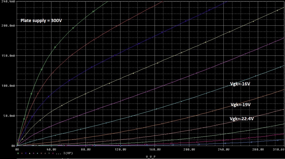

However, I am still searching for the plate characteristic waveforms of the EL34 in ultra-linear mode. Without this information, I cannot draw my load-line, thus I can't work out my DC quiescent operating point.
I have tried to simulate the plate characteristic waveform in PSpice as seen below. The result shows that different plate voltage(e.i. 300V vs. 450V) generate different characteristic waveforms. This is my first tube amp design, thus I don't have much experience. Please could someone confirmed these results.

Just use the 43% curves and scale them based on the new Eg2. The scaling factor could be found in RDH4.
Could you please elaborate more on this point??
You are on the right track, varying the screen grid voltage should change the plate/screen current. SPICE makes the process very easy, but if you want to do it manually, you can start with a traced curve set such as the one shown below:
Then to scale the curves from Eg2 from 450V to 300V, you apply a current scaling factor of 0.56 (for the details please refer to RDH4, p. 38).
