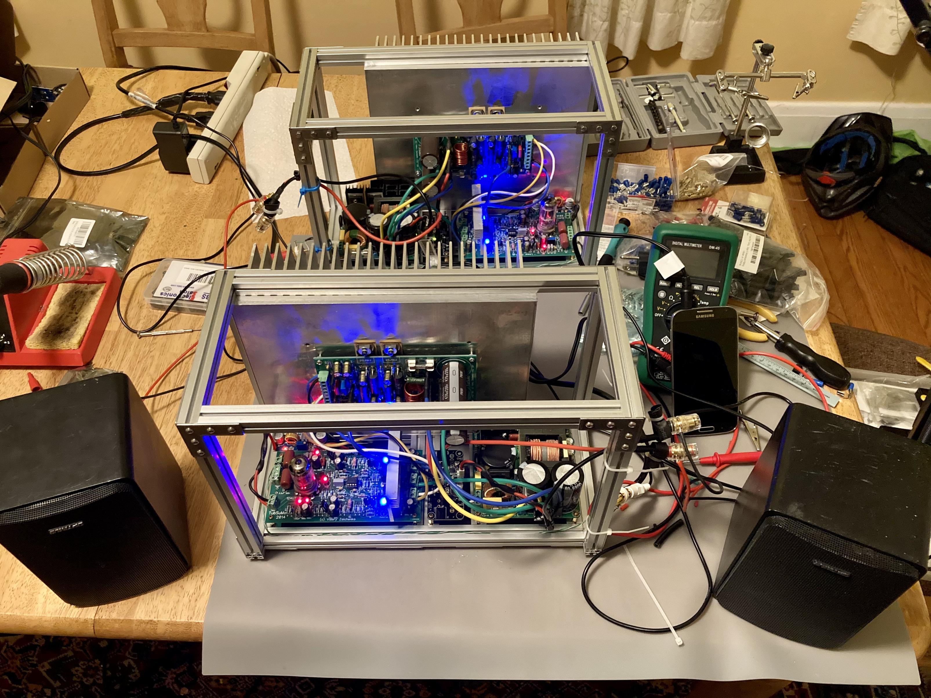

Two TubSuMo monoblocks are operational!
There is some background noise, but not noticeable away from nearfield.
They’re playing through my test speakers well now. DC offset servos are working perfectly.
I’ll try them out in my main rig tomorrow. Then I’ll affix some lexan panels and figure out the hardest part: final chassis details (mounting connectors, IEC socket, switches, etc.).
This open frame makerbeam build has been fun.

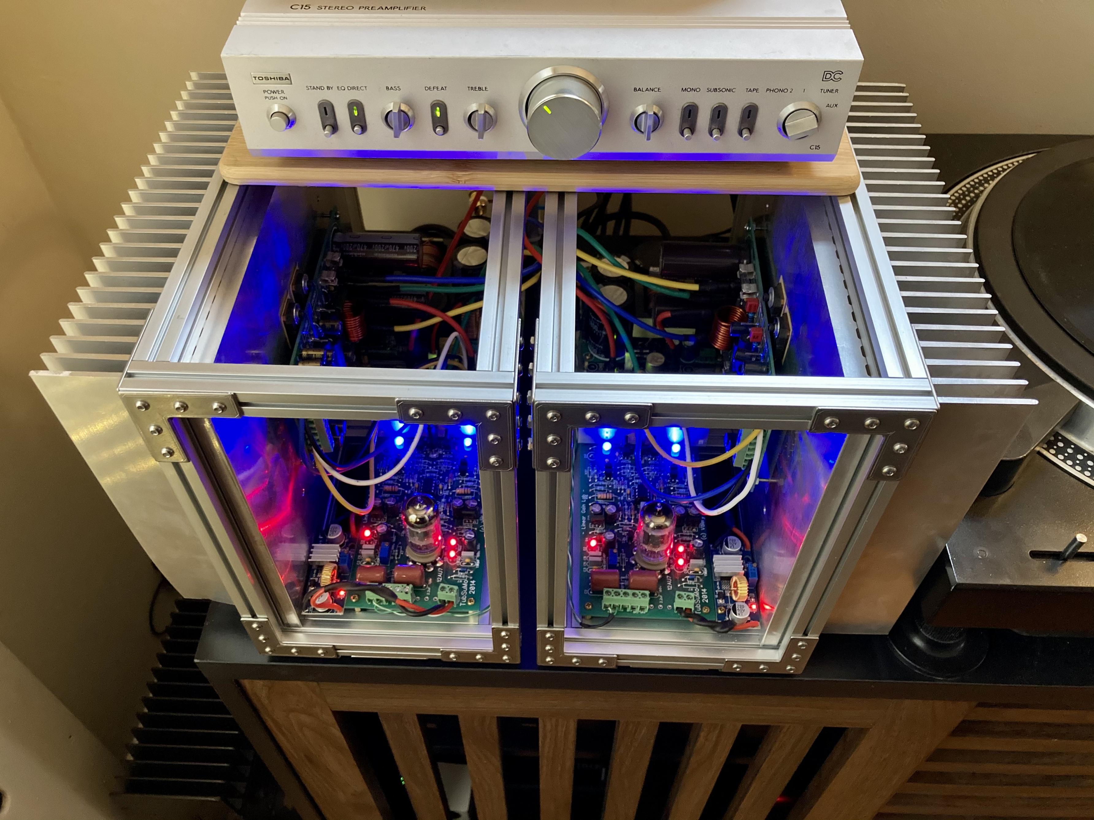

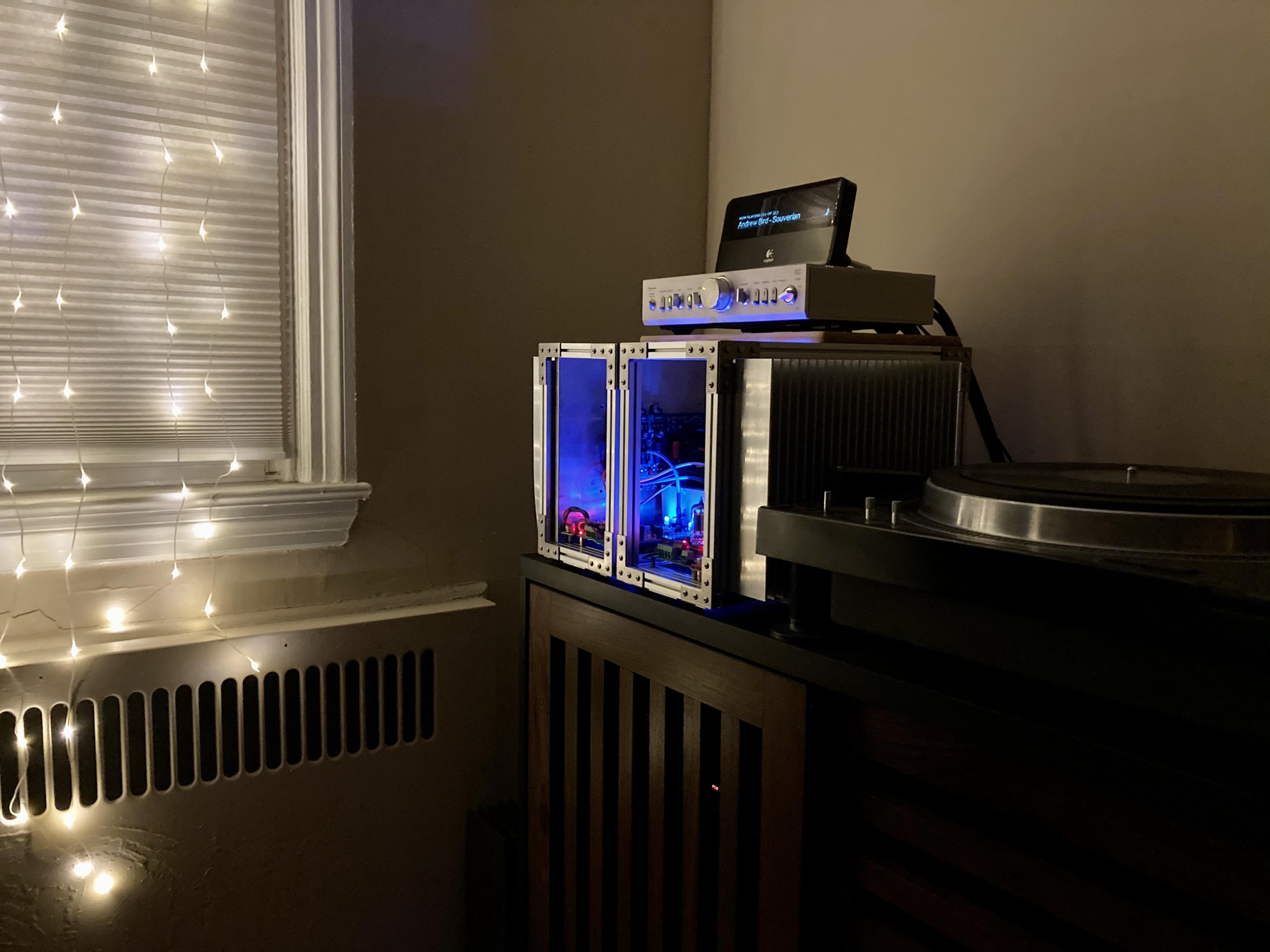

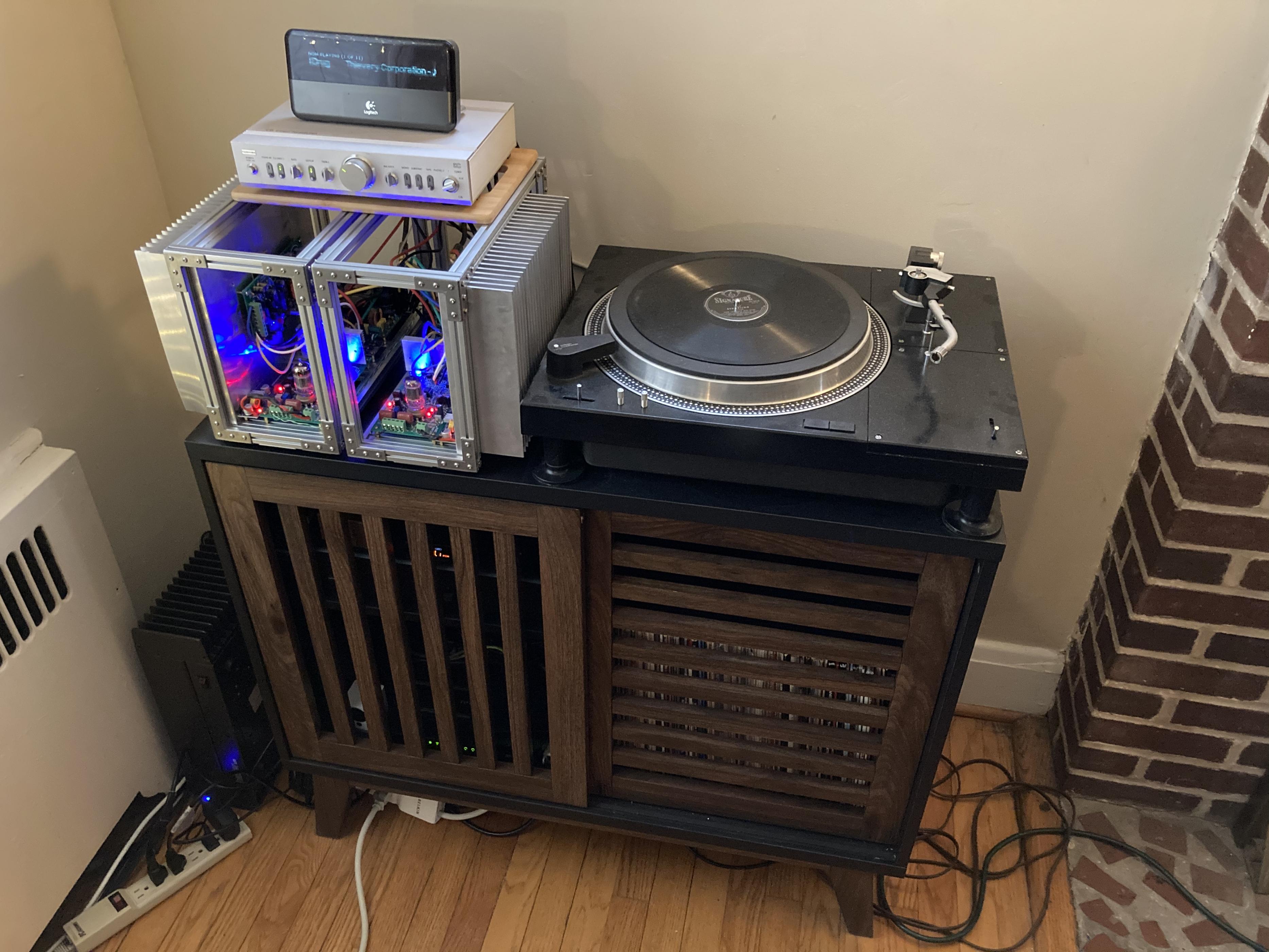

I’ve been running my TubSuMo mono amps every day, with nightly louder sessions. They have exceptional sound quality and finesse. It’s a tossup in level of enjoyment between these and my updated Hafler DH-220C amp. These are certainly prettier.
Thanks again to Valery and jwilhelm for the design and help, and to Evan for building the boards and sinks well (and selling them to me)!
‘The lottery’ is commanding a lot of attention on the forum—and rightfully so—but any potential builders should look into vzaudio projects for top-notch amplifier options. Great design, support, and results!
