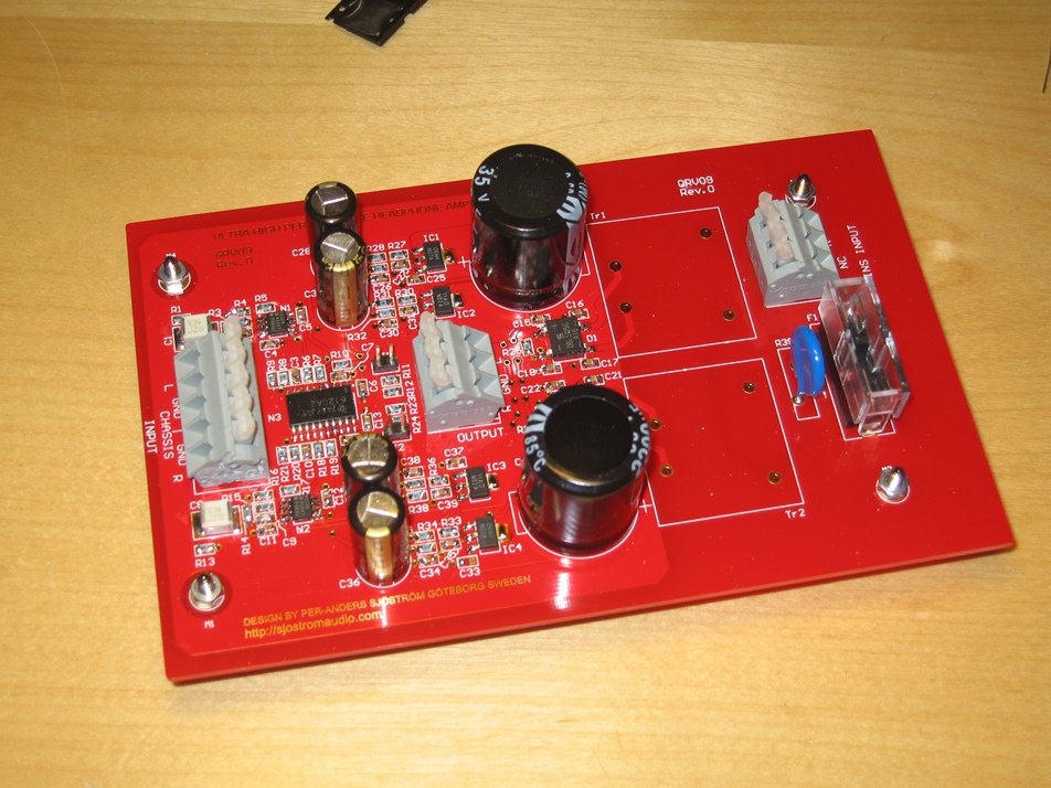

I went for the AD8610s. As I wrote in the GB thread I realized that I might need glasses in the near future but it was still not too bad. After a few components I got the hang of it although some were a bit fiddly indeed.

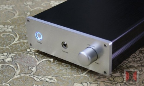

I'm now waiting for the transformers from Elfa as I wanted black Hahn transformers rather than the red Myrra. Everything else I got from Farnell.
Also, the search for a chassis has begun...
This will hardly happen, I'm afraid. Using a socket itself may cause problems in particular when you are trying fast opamps and in many cases you will get colourations just because you are using a socket, not using different opamps. The "sound" between good opamps is less different than you'll think. A good pcb does half the job here.
