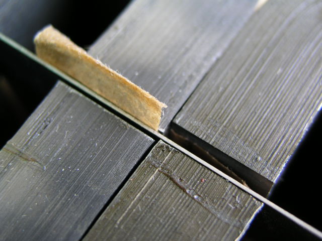

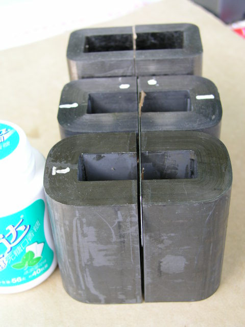

hi,
0.03mm lamination ( Hltra Hi-B) will start to supply for market,
so t means the best core in my hand for double c-core will
1. Nickel Boron Base Nano-amorphous core.
2. Ultra Hi-B 0.03mm lamination &
3. SR55 Superalloy 0.1mm lamination for OPT.
This will tailor made products, interest pls email to me.
photos show in the middle was Z11, another one was 0.2mm lamination ( japan the nest audio transformers use)
the thinnest was 0.03mm Ultra Hi-B lamination.
compare pls.
thx
thomas
