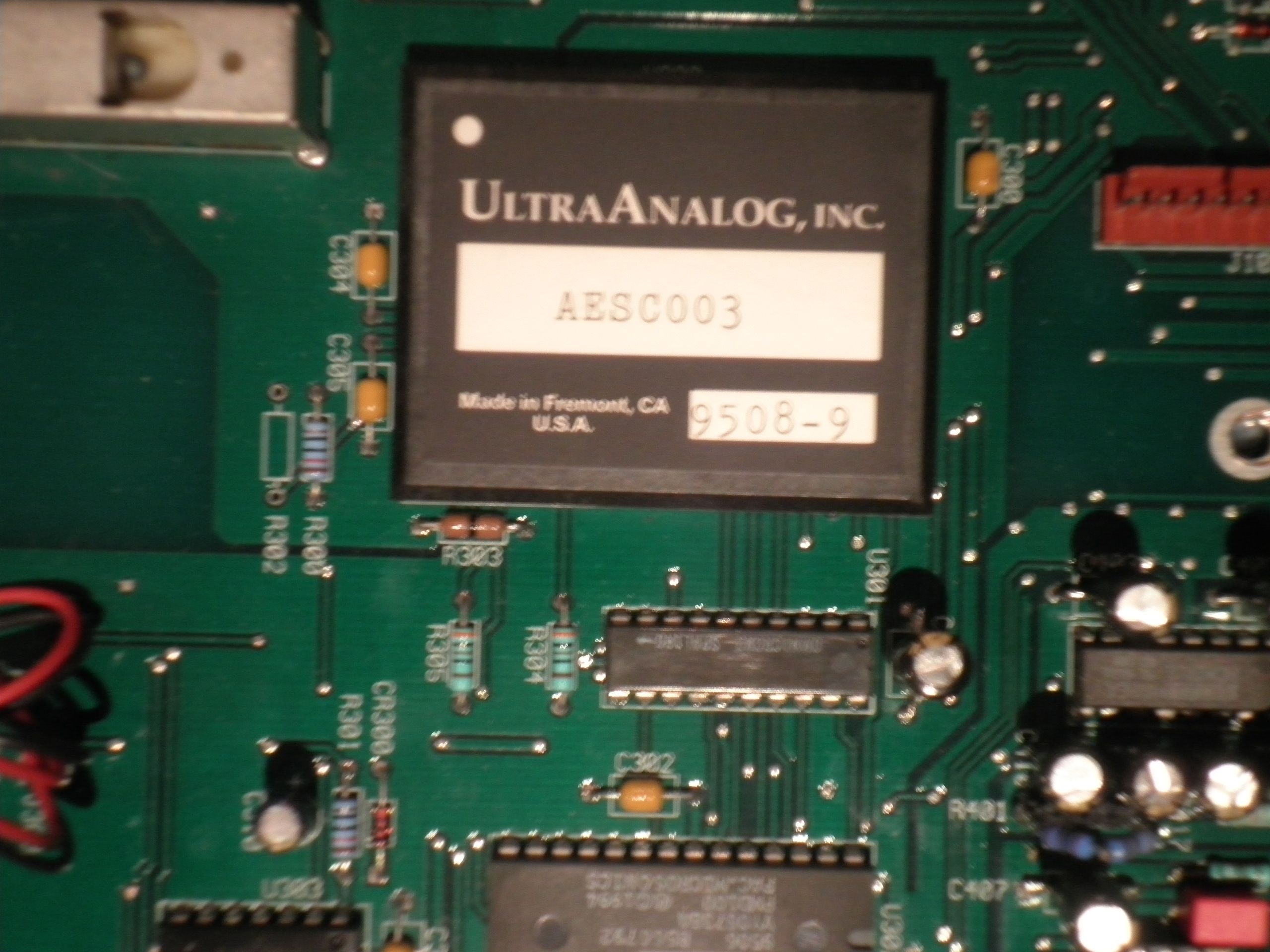

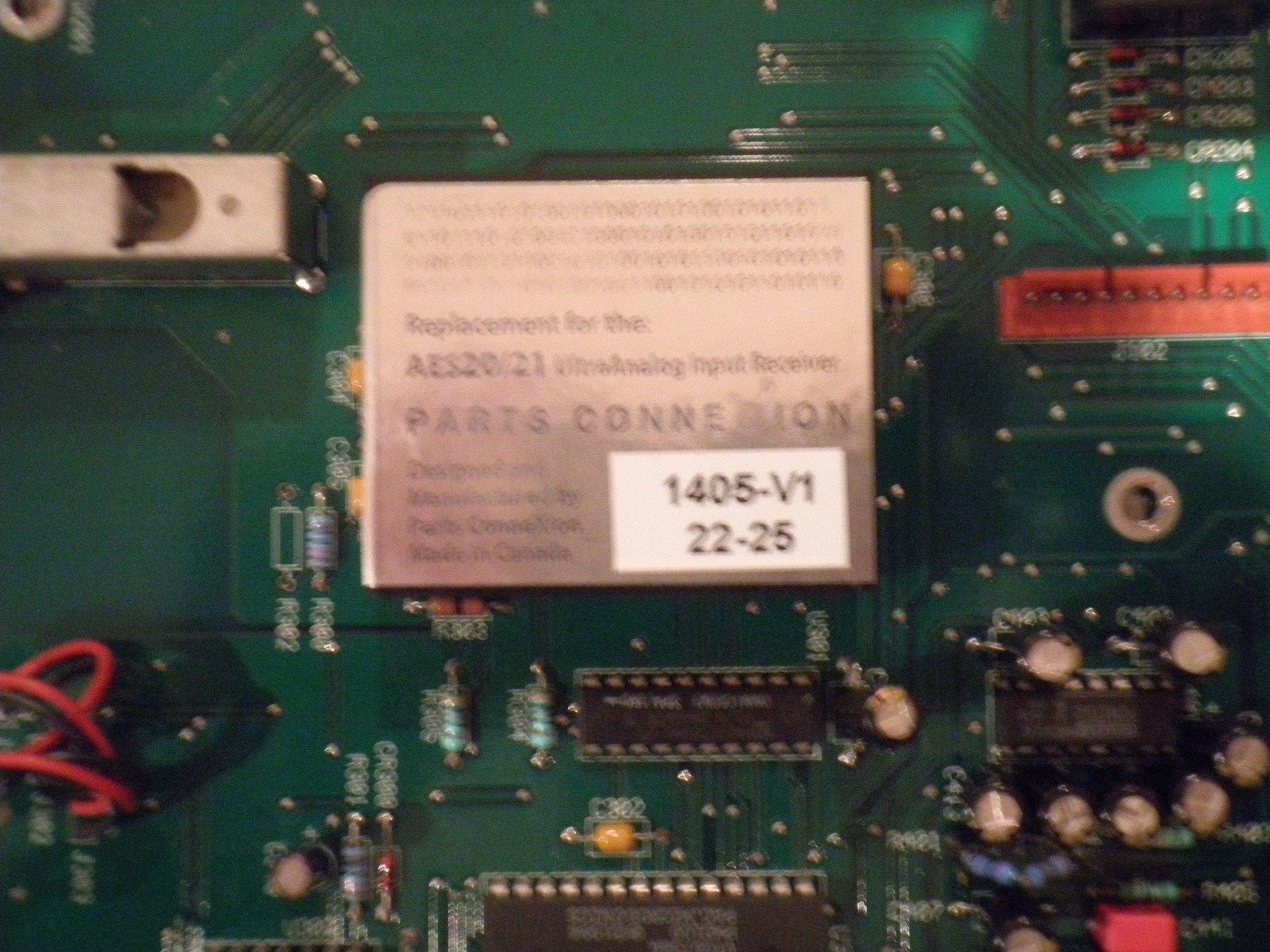

I had been experiencing intermittent failures of the Ultra Analog converter in my 20 year old Adcom GDA-700 DAC.
I took the plunge (it's not cheap) and ordered one of the replacement modules from Parts Connexion.
The new module is a direct drop-in replacement. It has been working flawlessly for over a week now.
I have attached "before" and "after" pictures.
![P9040003.jpg P9040003.jpg](https://www.diyaudio.com/community/data/attachments/392/392678-d3eb7d179225f9f112a98c845d782cf2.jpg)
![P9040005.jpg P9040005.jpg](https://www.diyaudio.com/community/data/attachments/392/392702-3a57a8d044dccca1622e4b84fbe5044c.jpg)

I certainly couldn't tell the difference with the replacement. I listen failrly critically every night with headphones which would show up any differences. By the way, my DAC has not missed a beat since I installed the replacement 4 months ago. I had previously tried re-flowing the solder, but that did not fix the problems. The AES-21 is responsible for separating the data from the clock as it is received combined. It also works to reducing the clock jitter to very low levels. While this may have an effect upon audio quality, it is not in the "analogue signal path" as such.
