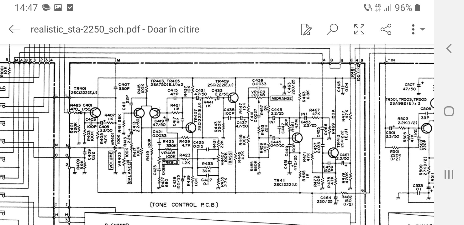

For a special application I want to create on half of Baxandall's approach - those half for treble boost. Therefore I have found follow proposal:
Treble boost - found under fig. 4 by
http://www.angelfire.com/electronic/funwithtubes/Amp-Tone.html#Amp-Tone-Primitive-4-back
and attachment here.
Theory of operation (quotation from mentioned URL):
On the left is an input terminal which connects to the grid of a triode, 12AX7.
The grid goes to ground through a 470 k ohm resistor.
The cathode goes to ground through a 1.8 k ohm resistor.
The plate goes to B plus two through a 100 k ohm resistor.
The plate also connects to one end of a 0.1 microfarad capacitor.
The other end goes to the top of a 500 k ohm pot.
The bottom end goes to a point labeled output.
The output point goes through a 47 k ohm resistor to ground.
The wiper of the pot goes through a 330 pf capacitor to the top of the pot.
This one gives about 14 dB of boost.
Oddly enough it requires a linear pot rather than the audio taper of the other circuits.
Also as shown the pot will work backward unless it is reverse wired.
The capacitor can be connected from the wiper to the output terminal without any change in performance.
That makes the pot work forward.
I will reduce resistors and enhance capacitors by factor 100, because the previous driver stage can deliver 1A output current. Instead the potentiometer I will use an ELNA rotary switch. Additional rotary switch I will use for variation the lower cut-off frequency (determining of the frequency, from those I want to get treble boost).
Maybe someone has an idea of what one can take also into account like the variation of the degree of slope etc.

If you're into discretes you'll hardly find anything better than this:
http://www.hifi-classic.net/review/realistic-sta-2250-262.html
