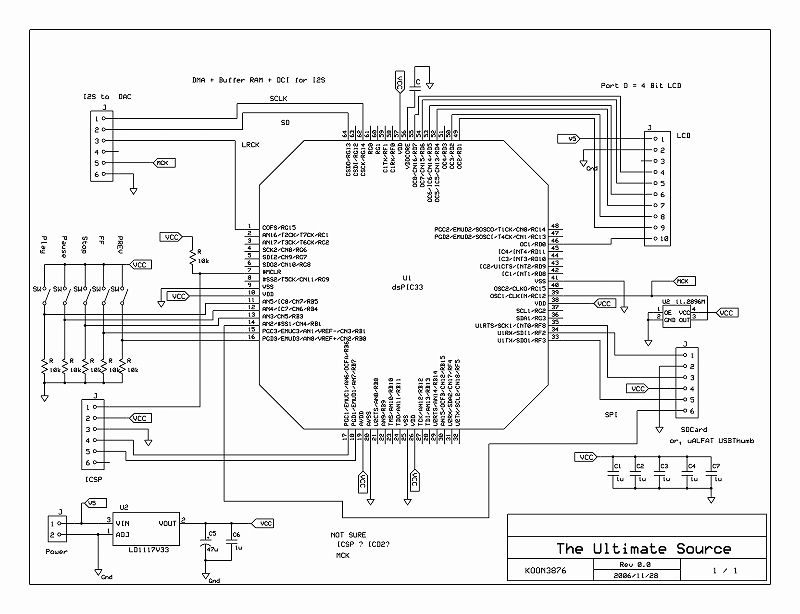

I think the perfect device for "Ultimate Sourse" is dsPIC33.
http://www.microchip.com/
it has DCI module, "Data Converter Interface", supports I2S output. and DMA controller + Buffer RAM supports seamless data supply to DCI module.
There are many samples to read SD/MMC/CF or ThumnDrive by PIC. Only one missing is controlling DCI/DMA to make I2S signal from WAV file.
I want to go this way but my PIC C compiler(CCS PCW) does not supports dsPIC
KOON3876 said:I think the perfect device for "Ultimate Sourse" is dsPIC33.
Just a quick schematic of "Ultimate Source", KOON version.
It only targets to create I2S signal from 44.1/16 wav file.
dsPIC33 will use 30mA or so, it will eat < 50mA total.
what a power eater.

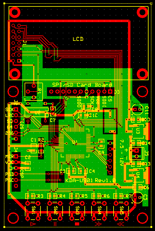

Request for comment
attached is a quick designed board for prototyping.
Dimension: 2.5 x 3.8
U1: dsPIC33
U2: 11.2896MHz master clock
U3: 5V for LCD
U4: 3.3V
J1: 8x2 Character LCD
J2: I2S output
J3: SPI connector, adjusted for http://www.sparkfun.com/commerce/product_info.php?products_id=204
U1: dsPIC33
U3: 5V for LCD
U4: 3.3V
J2: I2S output
but you can connect any SPI device.
J4: PIC ICSP
J5: Power In (I assume 9V battery cell)
SW1-5: Play, pause, stop, FF, Prev
Some surplus holes (right side of U1)
I will order parts / place on paper, then board, so I'm not sure I can get board before holidays.
