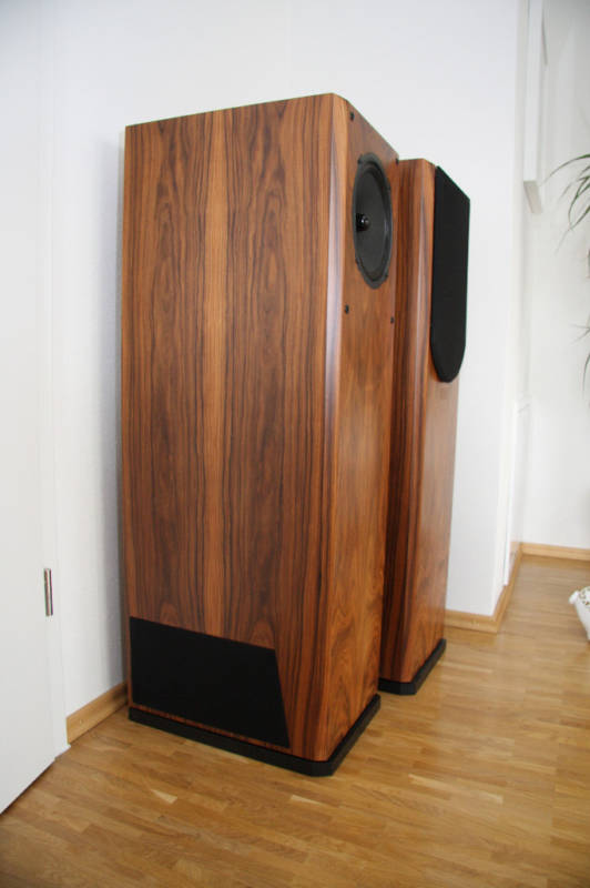

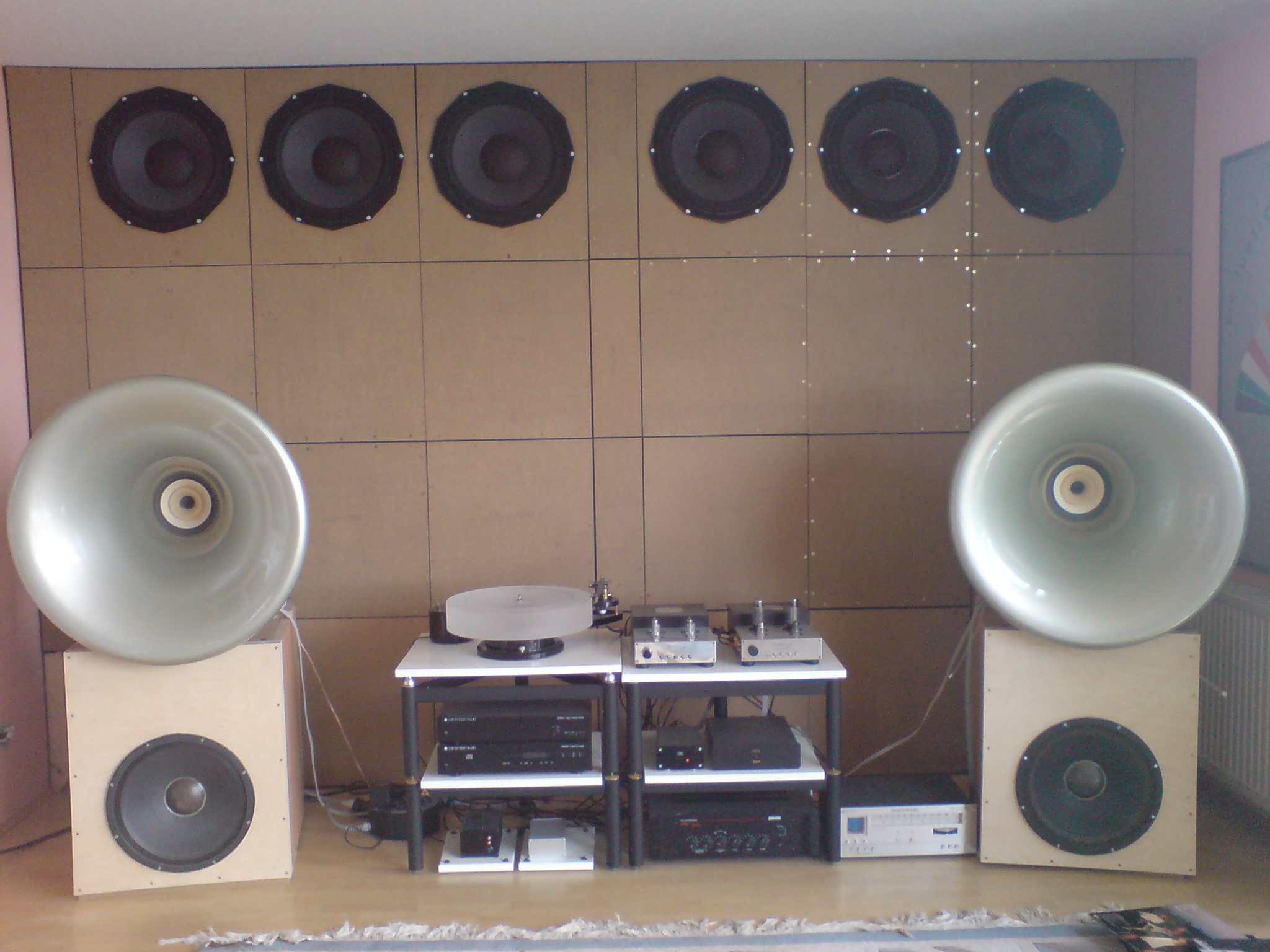

Ultimate Solution for an User with already present "InWall" Subwoofer:ESL or dynamicL
A friend of me have sold his mid-bass Beyma loudspeakers (for follow frequency range: 70-300Hz) and his full-range speaker system from AER with ORIS horn some years ago (to see at the attached picture).
Now he want an ultimative satellite speaker solution again, but now for ever.
My favorite solution is a "two-mode" diy satellite speaker system with follow components:

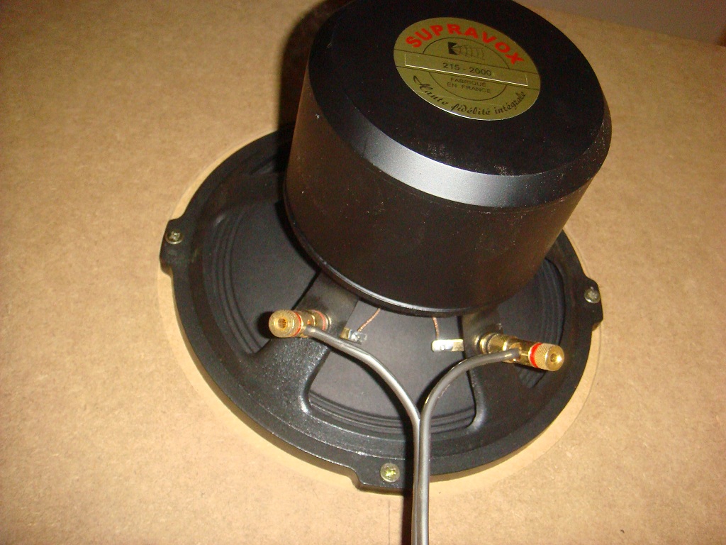

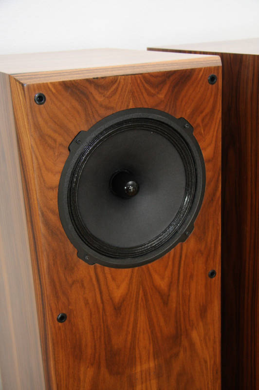

1) Supravox 215-2000 (both suited as midrange for two-way between 70-1500Hz and full range between 70-20.000Hz) in an alignment for a 70-80 Hz boom-box and additional high pass filtering
Here the URLs for short form data
215-2000 SUPRAVOX

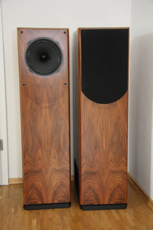

so as example for a cabinet outline:
Alize Speakers Manufacturer & Wholesaler From France
"your friend" has an inherent problem in putting the subs into the wall - they are always at the wrong "time" for whatever speaker is working with them! The subs need to be slightly in front of the main speakers to combine properly...
But disregarding that problem and solving it to some extent - one could consider putting the "other" speaker also into the wall as well... a bit depends on the construction of the wall, but the advantages are multiple, including much much closer to optimal frequency response in the lows and mids from whatever driver(s) are used...
In which case, either ESLs, ribbons, or dynamic drivers are worthy of consideration. Perhaps a single removable panel in that wall is the solution?. Then whatever speaker one wants to use can be "subbed" into that spot!

I claim, this is one of the ultimatest solution - except the bass horn like that one about
ROYAL DEVICE by Roberto Delle Curti Hi-Efficiency Loudspeakers Audiophile speaker systems High fidelity systems Sistemi di altoparlanti hi-end HiFi ed Alta Efficienza Lautsprecher Diffusori acustici stereo Enceintes acoustiques
could be slightly better (I try to make a visit to Milano next year for my own soundcheck).
I have realized such projects several times by much other user's (any few examples you will find on my web-page).
