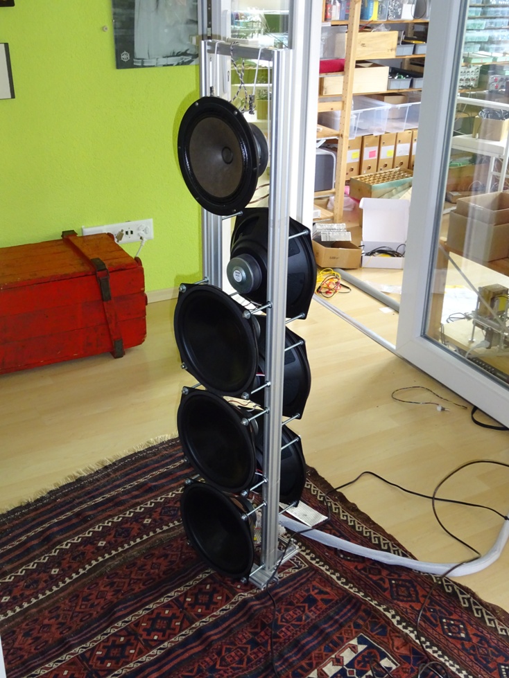

Here is my newest attempt of making a pair of nice OB with minimum effort :)
I also used industrial erector stuff, this one
Easy-Systemprofile - Profil, Nutprofil, Aluprofil, Aluminiumprofil, Aluprofil 20x40, Aluminiumprofil 20x40
Eventually, accounting for all bits and pieces and import and so on, it was about 150 euros IIRC - I think much cheaper than it used to be. I used M6 threaded rod to attach the woofers, while the fullrange is suspended.
They use 6 Visaton WS25e drivers playing up to 400Hz, and a Visaton B200 for 400Hz and up. Xover and DSP is done with a 2x4 minidsp. For the moment the bass section is powered with a little SS amp, and the B200 with a tube amp - but this is going to change as I spent most of my DIY efforts on amplifiers.

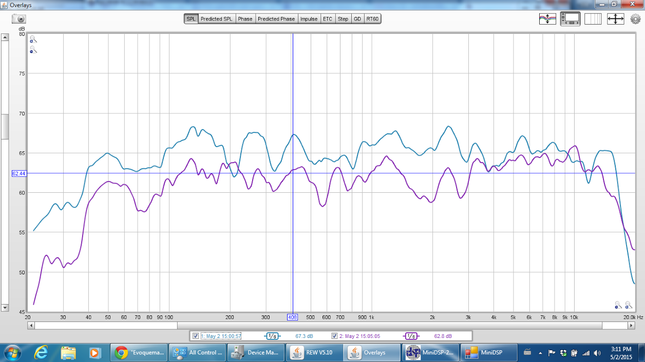

It was also my first attempt in measuring and tuning the speakers performance, using UMIK-1, REW, and the DSP functionality of the 2x4. My wife was asking what I was listening to during all the tests, as according to her the whooooooop testtone always sounded similar :D SPL level during tests was not very high, I can't play very loud either (this is Switzerland).
I think I am happy with them for the moment. Indeed very little work, no need for machinery and no wood/MDF dust to clean - but still working on their "feet" and covering them. I also just got a package containing 2 NEO10s, which are meant for future upgrades.
The pictures arent really that good, but well, speakers aren't finished either :)

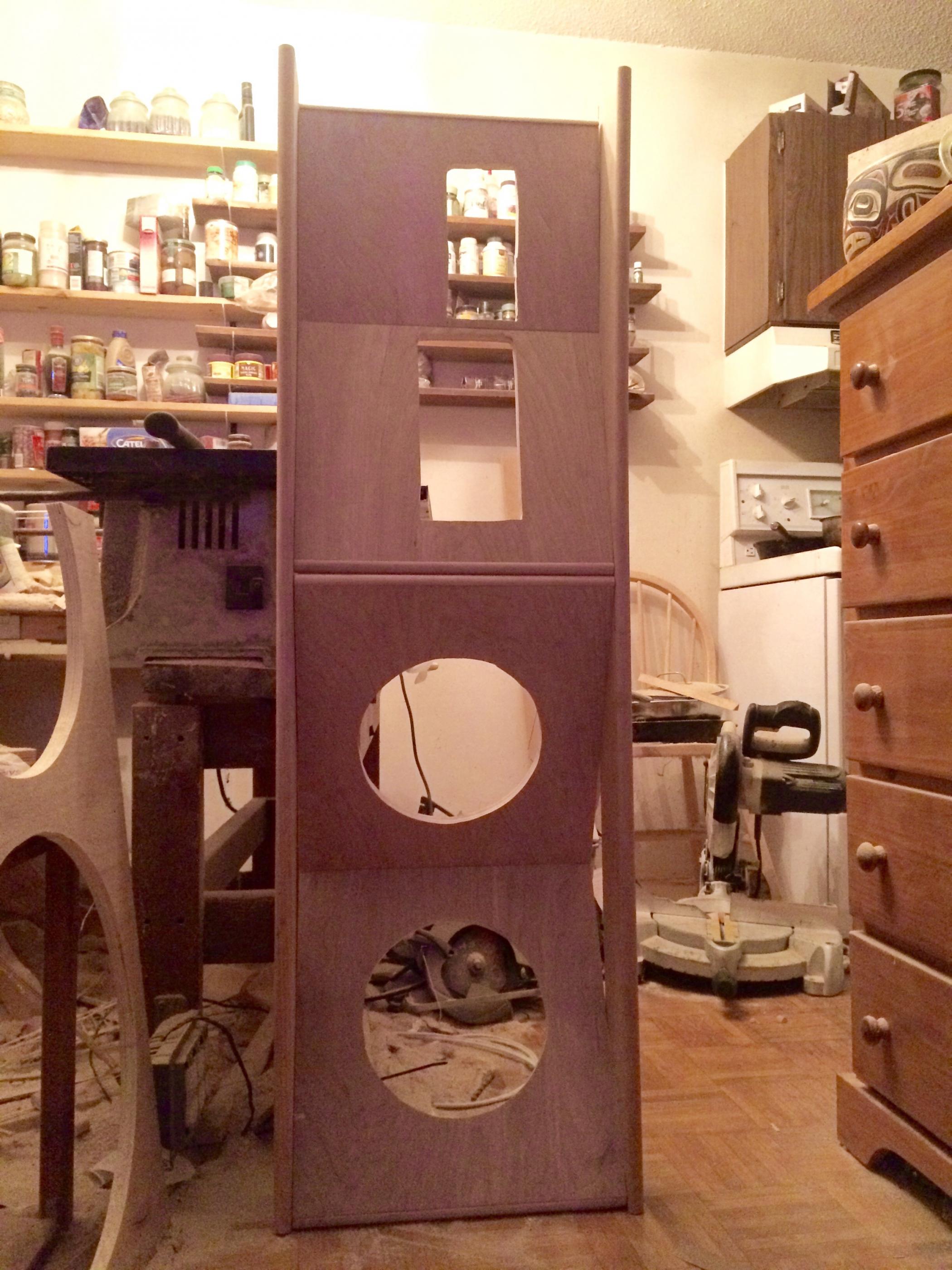

These will be two 10" GRS Polycone woofers below a Neo8 and Neo10 in a separate swap outable baffle.
Thanks for any advice😎

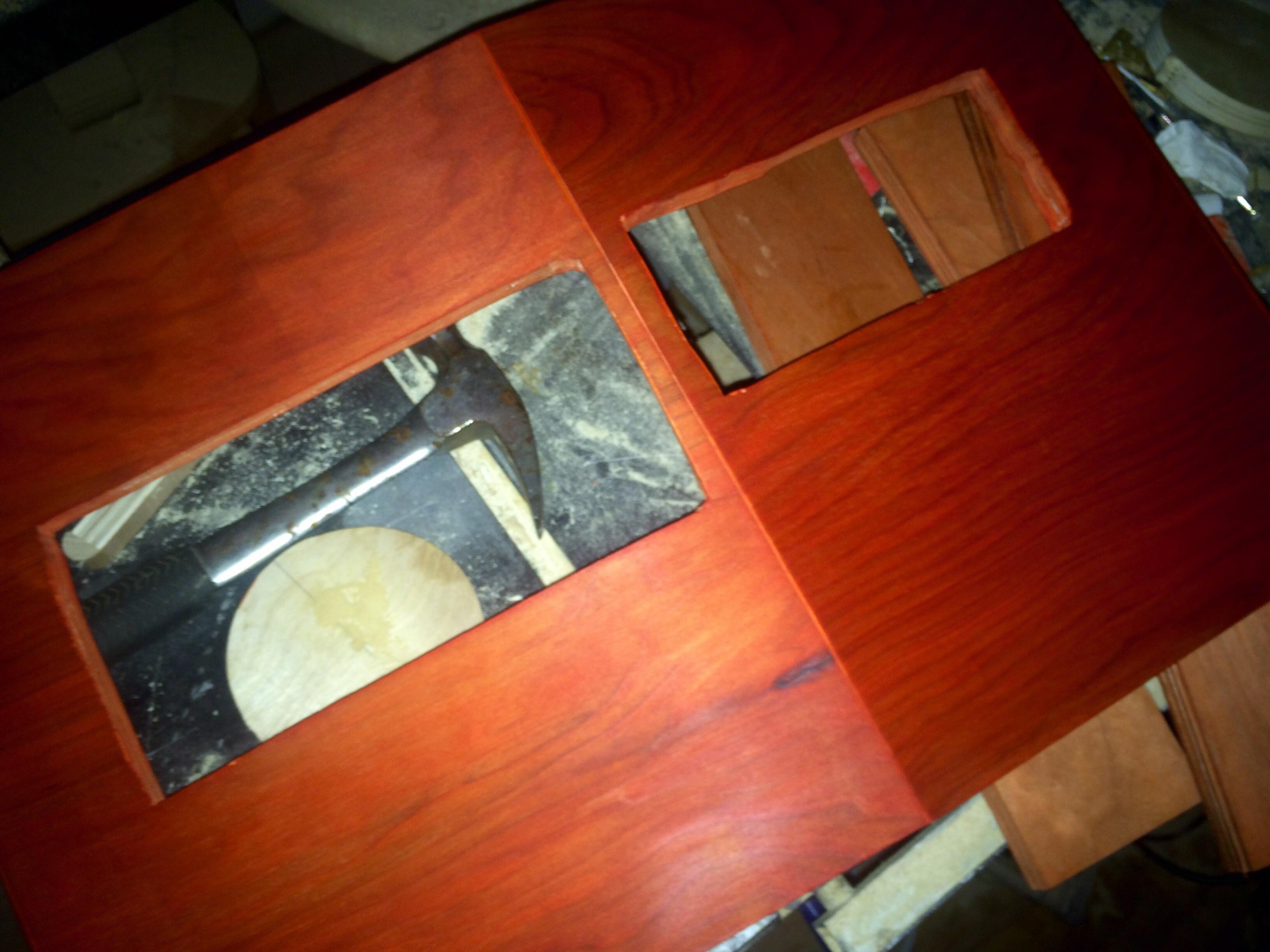

First hunch was right, water based dye doesn't bleed when walnut oil is applied.
Will oil up the carcasses and install the drivers tomorrow.
Turns out it's pretty easy to get a near cherry finish over birch with aniline dyes- one coat of orange, a coat of orange- red, then coat of red with just a little blue in it.
I think the walnut oil looks about as good as pure Tung oil, and is a lot easier to find.
