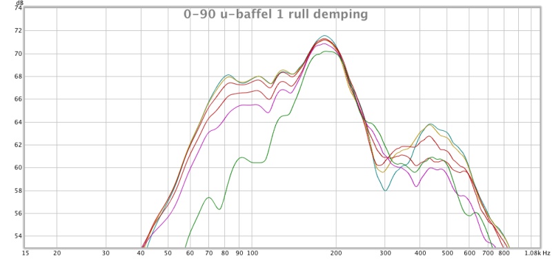

here is a measurement i did of the H-baffle prototype without EQ. (distance 80cm, crossed at 700hz)
and compared to a similarly sized u-baffle.

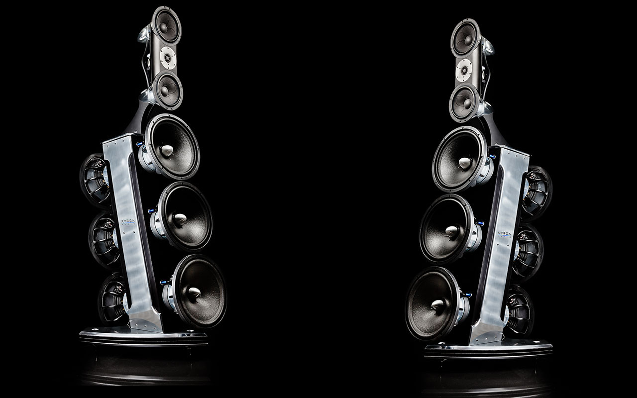

Kyron Kronos
I heard this over at Melbourne Audio Show yesterday. They are developed by a local company here in Bacchus Marsh. A farm area as I know it!
kyronaudio.com.au/#!kronos/kronos.html
They sounded sublime. Best dipole implementation I've heard both aurally and visually!!
I have observed sometimes ago that simple baffle is better than H or W-frame and these speakers reminded me of it. The 12" drivers delivers deepest bass in the show as one might expect from dipoles.
The magnet-mounted alumunium frame and baffle is awesome. The whole package is fit for a death star or looking at the tweeter... klingon bird of prey.
Simply awesome product and a far long distance from the 1st know dipole by Wharfedale in 1956.
I still get the impression that art has been a major part of their design at the expense of performance. If they wanted the best performance they would have inverted one of the bass drivers.
Would be interesting to see polar plots of the speaker.
That basically means that EVERY speaker with only one bassdriver is a compromise? It would look ugly with one of the drivers inverted and thats a big price to pay for a minimal gain in lower distortion. It is more called for in W- or H-baffles where the drivers can be covered up. IMHO oc...
Well... yeah =)
It's not minimal at 20-40 hz though, faraday cages isn't practical that low so you'd have to use a push pull motor for it to perform decently, or use two drivers =)
In a normal speaker then sure if you use high SPL you'd benefit but not otherwise. But this is a dipole with a small baffle so excursion will be massive at low frequencies, hence it is not performing as good as it could with both drivers facing the front.

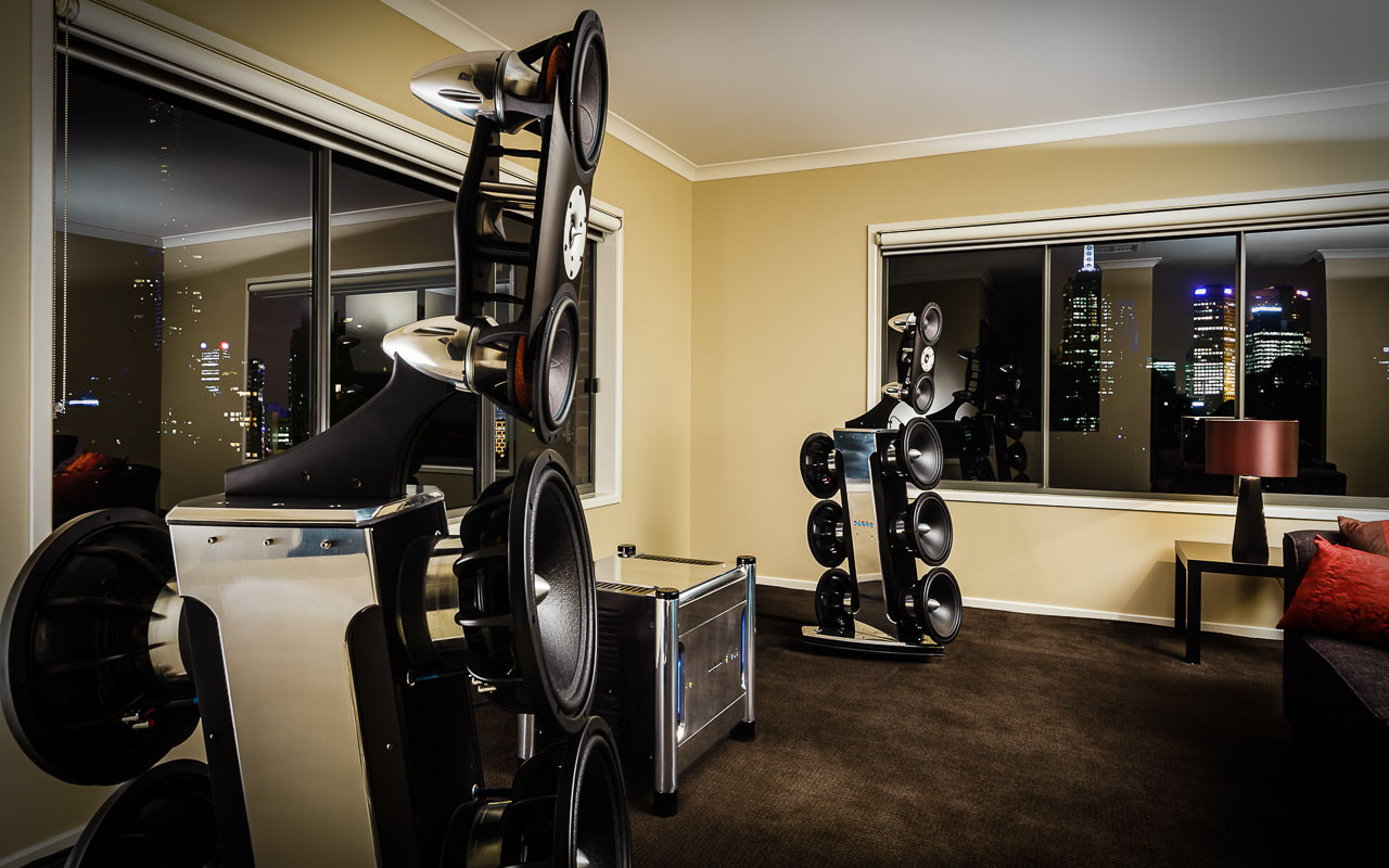

Maybe Kyron's top of the range 'Gaia' handles the inverted bass driver issue
Also, heard the 'Kronos' at the Melbourne Audio Show. Have to agree, they do sound sublime, and go deeeep thanks to lots of active power and DSP EQ.
Think the 'Kronos' is around 70k+ AUS, not sure about the Gaia. Think I'll stay in the DIY world for a little while longer.
I think that Kyron Kronos is a basic 3-way dipole. Nothing special except aluminium supporting frame and "nice" craftmanship.
Good points
- There seems to be a backfiring tweeter
- Are the woofers AE Dipole-12 series?
- DEQX as dsp and Hypex nCore amps
Bad
- only a 3-way
- price

- 3 Way, DSP - controlled active dipole loudspeaker system
- 32Hz to 40KHz
- Figure 8 (dipole)
- 4 × 1-inch ring radiator with patented symmetrical drive motor
- 2 × 7-inch neodymium dipole mid-woofer
- 4 × 12-inch long throw, dual voice coil dipole woofers
with one of the drivers inverted ... lower distortion.
Reduction in even order distortion, potentional increase in odd order. And with very good woofers almost no change in distortion.
dave
Basic = no wings or "origami" in bass frame, just a square baffle with 2 drivers. Single mid and double tweeters in a triangel baffle. It is basic stuff, done so many times by diyers.
There is some styling done and fancy materials yes but I don't think it has much to do with sound.
Tweeters don't work as dipole because of the frame and distance. The back T just adds reflections. Driver choices are good.
I made an Edge simulation of each section and the ovious issues are - low end has dipole null around 1100Hz and needs heavy low F eq (propably eq'd flat to 50Hz) Mid has dipole null around 2,2kHz. Real nulls are a little lower.
However it surely has many general virtues of dipoles and room response can be eq'd with the dsp, seems like a mic comes with the system.
