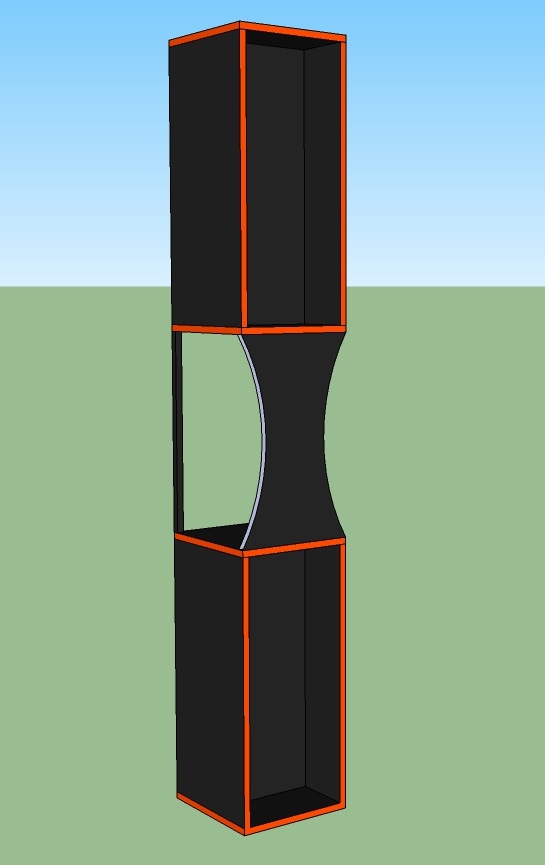

Why do you want a WMTMW? I don't see any acoustic advantage in a dipole woofer H-frame in mid air, but real structural problems if you want the baffle to narrow around the Neo3 - which you should. I would even question a necessity for the upper midrange driver. There are reasons why most newer dipoles end with the tweeter on top.The plan in my head is WMTMW

Well, what I don't have drawn in the rendering is the upper frame and lower connected with 5/8ths threaded rod. It won't be supported at all by the mtm center baffle.
As far as sonic advantages, I'm really just borrowing from two designs that I've seen, James Trexx's and the aristoteles. Its a grand expirement. What I'm looking for in having the upper mid bass h frame is really just "sonic size" and the visual impact. Wood is cheap and I've got the drivers, so unless there's some kind of "disadvantage" that I haven't considered or don't know about..I'm going at this with all guns blazing, lol.

Thanks, that is always an honor if somedody takes over bits of a design. The curved panel works pretty well for the midrange. But as we "speak" it is about to change although I will probably keep some curves. Version 0.61 is in the works...going 4 way. And as Rudolf pointed out, ending with the tweeter on top.As far as sonic advantages, I'm really just borrowing from two designs that I've seen, James Trexx's and the aristoteles.

As far as tweeter on top (forgoing the second set of MW, I'm guessing is the suggestion) is there a sonic advantage, or is the idea that it's wasteful? By sonic size, really what I mean is just lighting the whole wall up with sound, not necessarily shaking the house. I've always had trouble with sonic size, where it always really feels like you're "listening down", so I was going for symmetry and lots of baffle area and having that top H frame being pretty much against the ceiling.

The symmetry that buys you vertical control with normal speakers is not really required with dipoles. There you already have a somewhat narrower dispersion. If you now go with mtm you could run into vertical response issues at shorter wavelengths. Also, the two m's could outrun the neo3 and so you will have to decrease the output and the spl advantage is gone with more cabling and amps and less mechanical stability.
With a LX521 or NaO Note type speaker there is no "listening down" issue.
If you really want to go wmtmw then it is better to go 8-4-t-4-8" in a simple baffle (maybe hourglass shaped) instead of the H-frame. But the neo will most likely be again the bottleneck. If not in SPL then in size (too narrow vertical response resulting in sharp interference nulls at cross over F).

Thanks 2Pi. The beauty of active open baffle I guess is how simple (read: easy to make new ones) the baffle can be, so I might go through quite a few iterations before I'm happy. I understand what you guys are saying about the design that's similar to James Trexx's Gate and I could run into issues, but I'd like to at least try it and measure it to see what I get. If the Neo3 ends up running out of gas or has dispersion issues, it would be fairly trivial to swap, or perhaps even add another one?

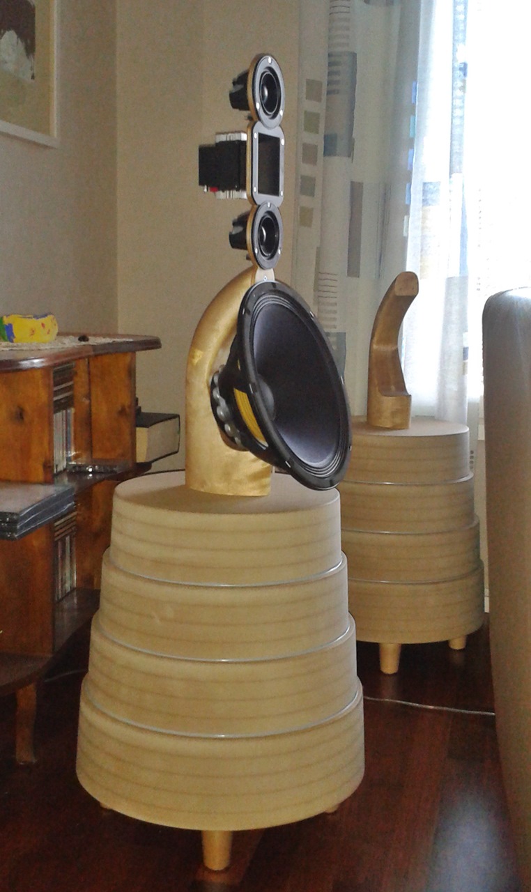

Here are a few pics of my most recent OB speakers incarnation:
Design goal was to make them fit as well as possible into a normal domestic living room (i.e. spouse had to approve finished look). And to be able to live without additional acoustic room treatments. Angling in design makes them workable close to the front wall.
W-baffle with 2x Acoustic Elegance DP10s, Seas W22 paper excel mid and SS illuminator tweeters. Each woofer driven by 200W, with active crossover to mid/top and another 200W amplification. Passive filtering between mid and tweeters.

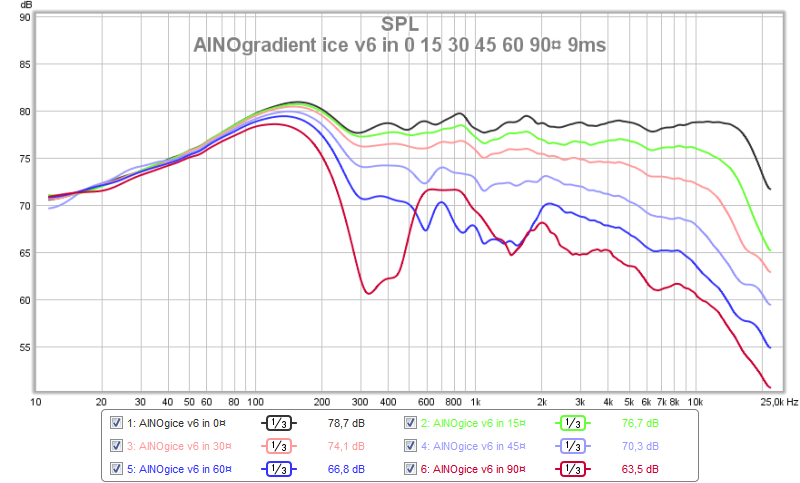

The link to my AINOgradient project doesn,t work. A new try here http://www.diyaudio.com/forums/mult...aborative-speaker-project-21.html#post3527056
Directivity measured from 1,5m distance, 9ms IR window
