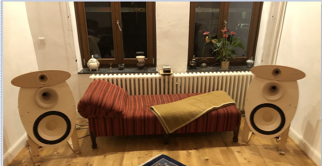

I see there are SONIDO speakers : SWR 200/A and SCW 300/F.Here my two new OB projects, as a first teaser only a few photos.
1.
Sheldon the egg right side and left side
View attachment 1095891 View attachment 1095892

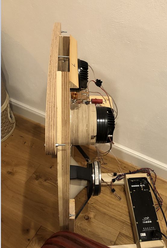

Hi all!
Thank you for your interest about the post.
Here the chassis of the Sheldon the Egg in Stereo setup.:
Bass
Sonido SCW400 unfortunately out of stock since a while
Midrange horn
LMH sTrak 22 cm with 18sound NSD1480N driver

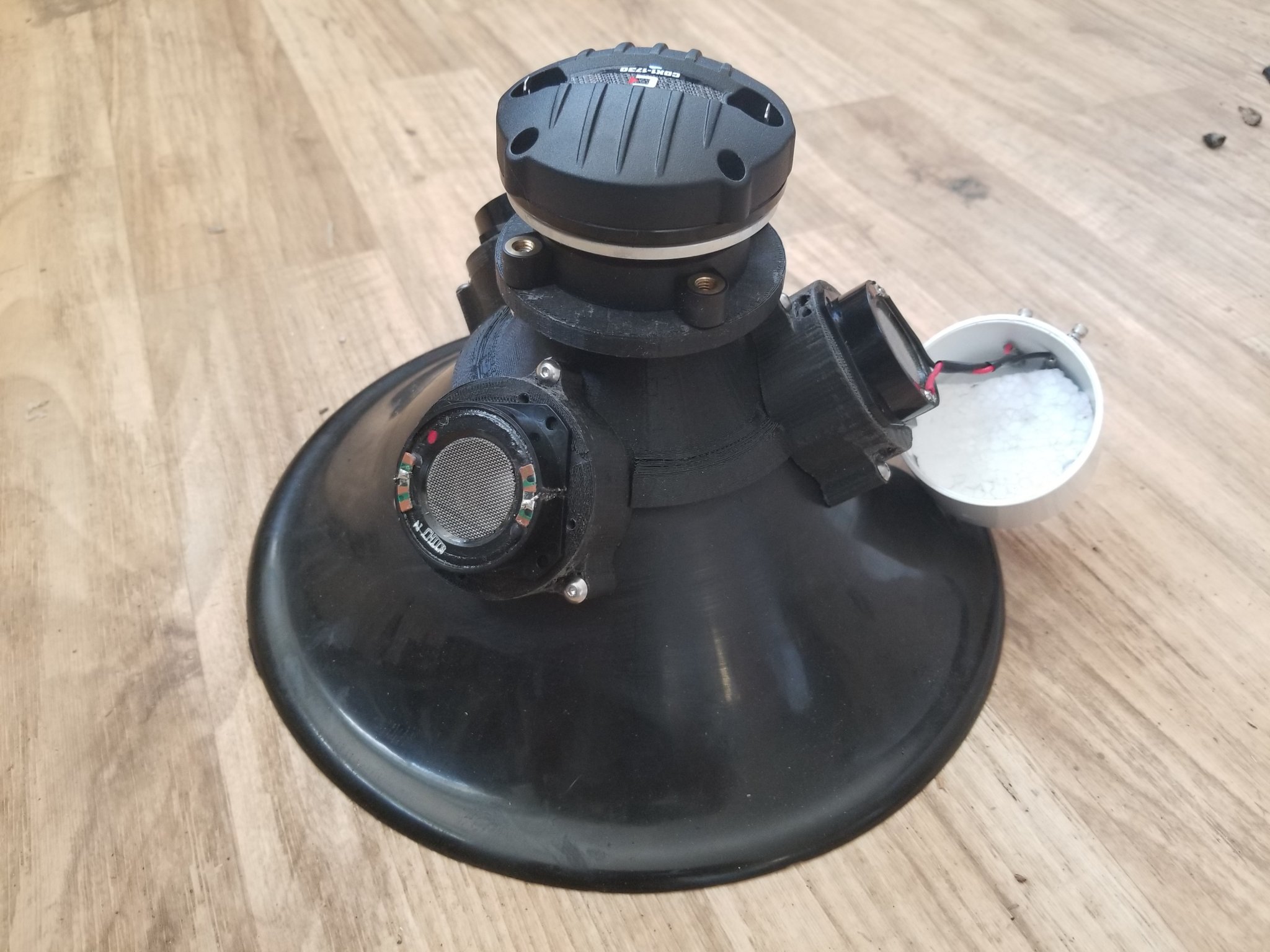

Tweeter horn
LMH sTrak 12 cm in elliptical baffle with 18sound NSD1095N driver

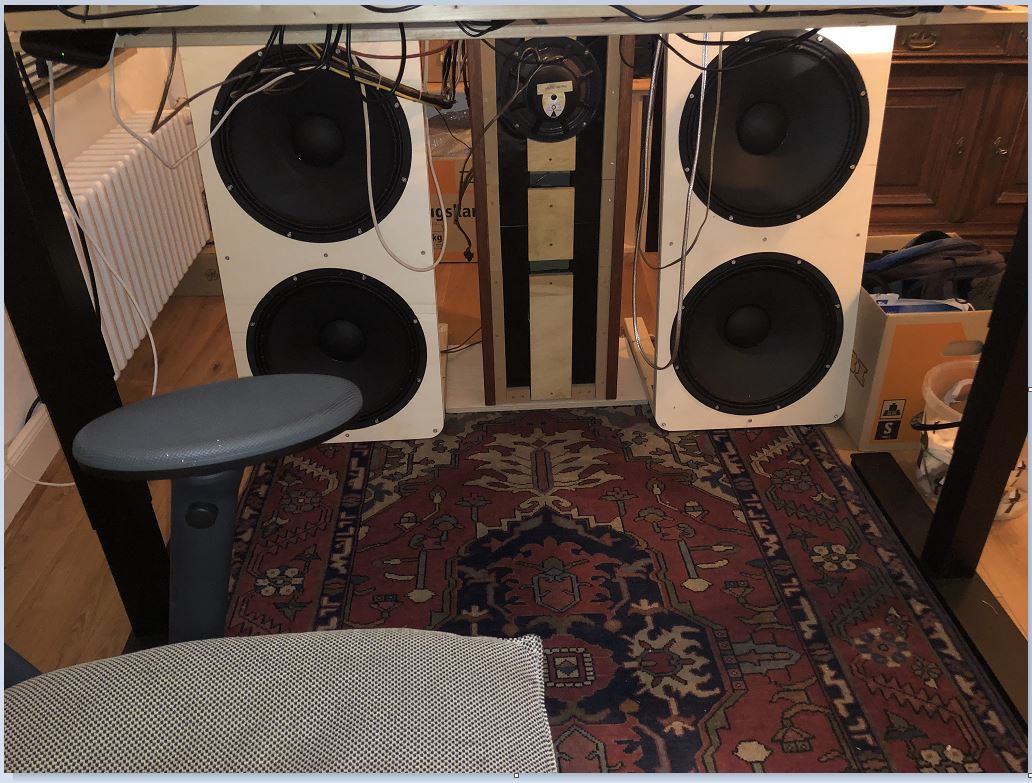

Here the chassis of the VoiceHorn4Desktop setup:
Mono Bass
JBL D208H Alnico with double chamber bass reflex enclosure
Mid Bass
Two 15 inch Celestion FTR15-3070C each side in small open baffle - massive PEQ required to get out bass
Full range in small open baffle
Sonido SFR200-A
Tweeter
Visaton HT21 horn with 18sound NSD1095N driver
It may be interesting to mention that the open baffle Desktop music playback works far better than expected. It was intended only as interim experiment until the final room where the stuff was originally intended to stay is ready after building recovery measures are terminated. I have to think to rebuild the desktop mounted stuff with the full range speaker and the horn tweeter in a new decent looking open baffle with the proper cutouts for the SFR200-A and the HT21.
With Sheldon the Egg i have struggled a while with the passive crossover between the midrange and the tweeter horn, there was no way to get a decent crossover point without a deep break in in the frequency response. I had to divide the passive crossover in two separate channels and to introduce a three way full active setup with a substantial delay between the midrange and the tweeter horn to get a decent flat frequency response.

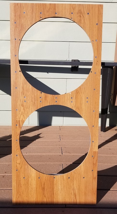

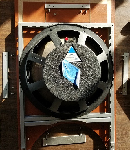

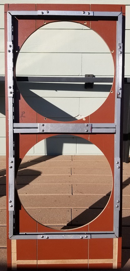

I actually have several woofers to try. The depicted TAD1601A will be first to try as they have the highest excursion.Which TAD woofers are you going to use? I'll be interested in how they perform in an OB.

These are AuraSound NSW2-326-8A.What midbass drivers are those?

I've been reluctant to try my 1601a on OBs due to their .31 QTS. I look forward to your opinion when you try them.Hi WBS,

Ah, so you are waiting for a guinea pig.I've been reluctant to try my 1601a on OBs due to their .31 QTS. I look forward to your opinion when you try them.

why not with some boost ,Nelson have a jfet boost in is pocket...I've been reluctant to try my 1601a on OBs due to their .31 QTS. I look forward to your opinion when you try them.
I don't think 8mm Xmax will be a problem, 36mm before damage.Limited Xmax with bass boost?

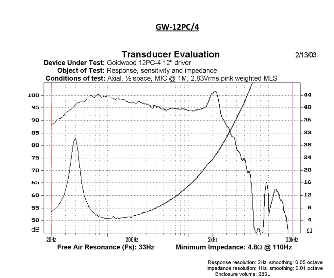

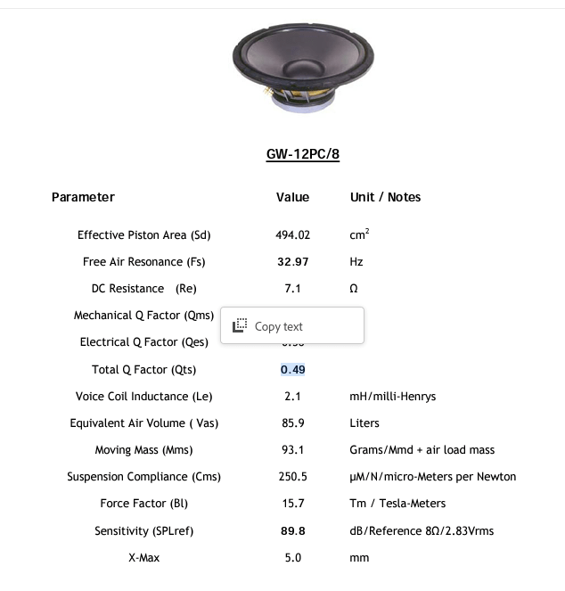

Hey OB experts... I have a question about the gap between manufacturer test data and data from a model on a baffle. I'm choosing bass drivers for a cheap "micro-Manzanita" and I'm looking at either the GW-212/4 or the GW-12PC-4. GW-212/4 is dirt cheap, does way better on a baffle model and has a good OB Qts (1.2). GW-12PC manufacturer chart shows it's a good 5-10dB more efficient below Fs, but when I plug it into Basta it's awful efficiency wise. It starts rolling off at like 400Hz on the baffle. I will have to go back and double check the Basta parameters for both drivers.... but I thought the manufacturer tests were done with no baffle, meaning their charts are kind of ground zero for what performance would be with any baffle? Why is the performance of the model so different from the manufacturer's tests?
FWIW I am modeling and planning to use a .5m square baffle.

qts only 0.49

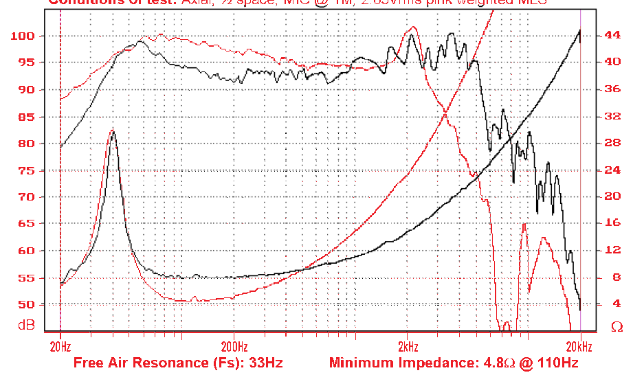

How does that affect the performance in a baffle? Here are the manufacturer freq response tests overlayed (red = 12PC-4, black = 212/4... disregard impedance; SPL is on same scale, impedance is not). 12PC is 5-7dB more sensitive across the freq range I plan to use and I'm assuming they test the drivers with no baffles. But Basta says 12PC sucks for bass in OB. Not super worried about Xmax as I'm not going to blast these or listen to super bass heavy music but I do want all the LFE I can get.
simple fake manufacturer freq responseHow does that affect the performance in a baffle? Here are the manufacturer freq response tests overlayed (red = 12PC-4, black = 212/4... disregard impedance; SPL is on same scale, impedance is not). 12PC is 5-7dB more sensitive across the freq range I plan to use and I'm assuming they test the drivers with no baffles. But Basta says 12PC sucks for bass in OB. Not super worried about Xmax as I'm not going to blast these or listen to super bass heavy music but I do want all the LFE I can get.
Better check the fine print
