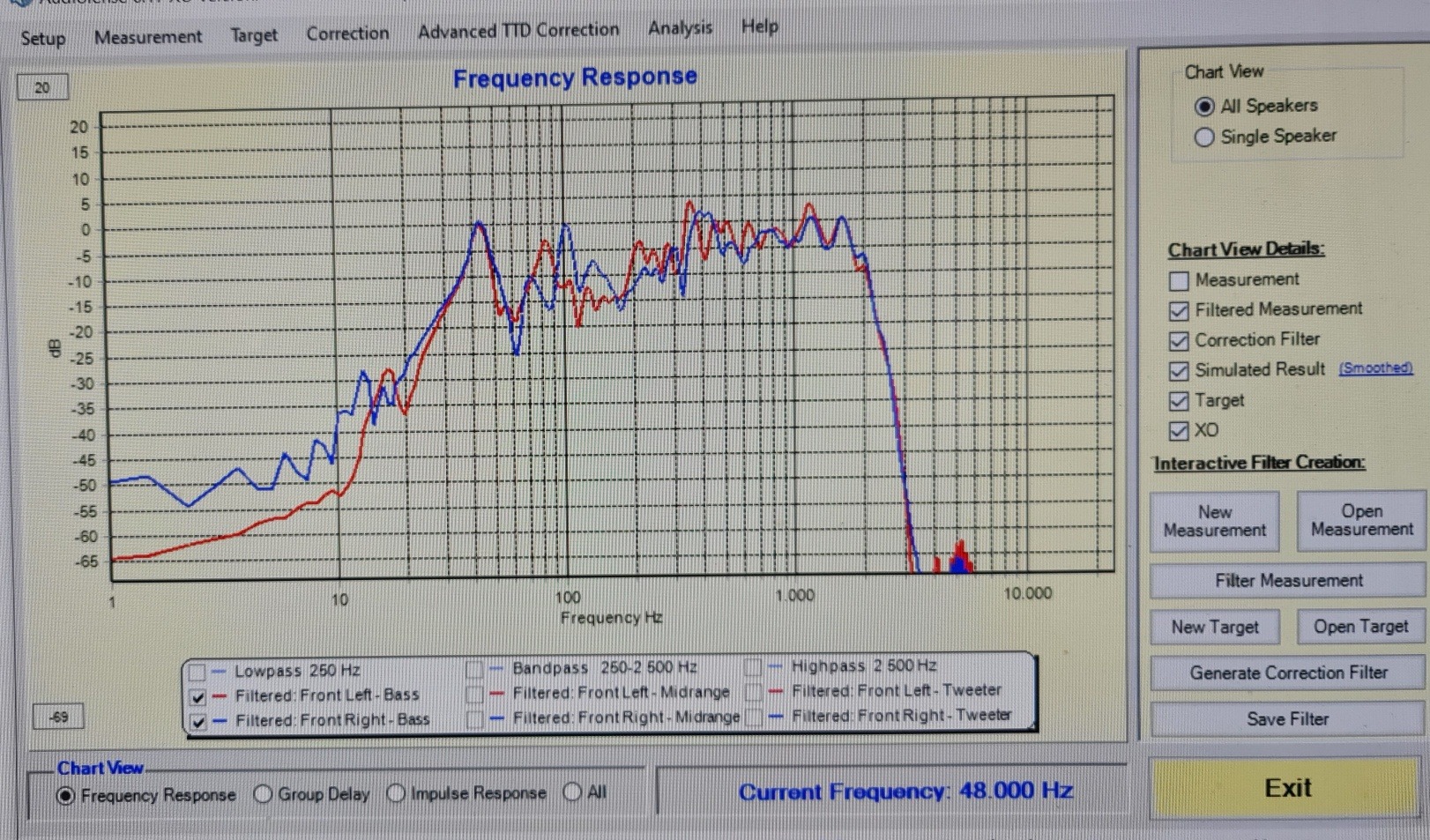

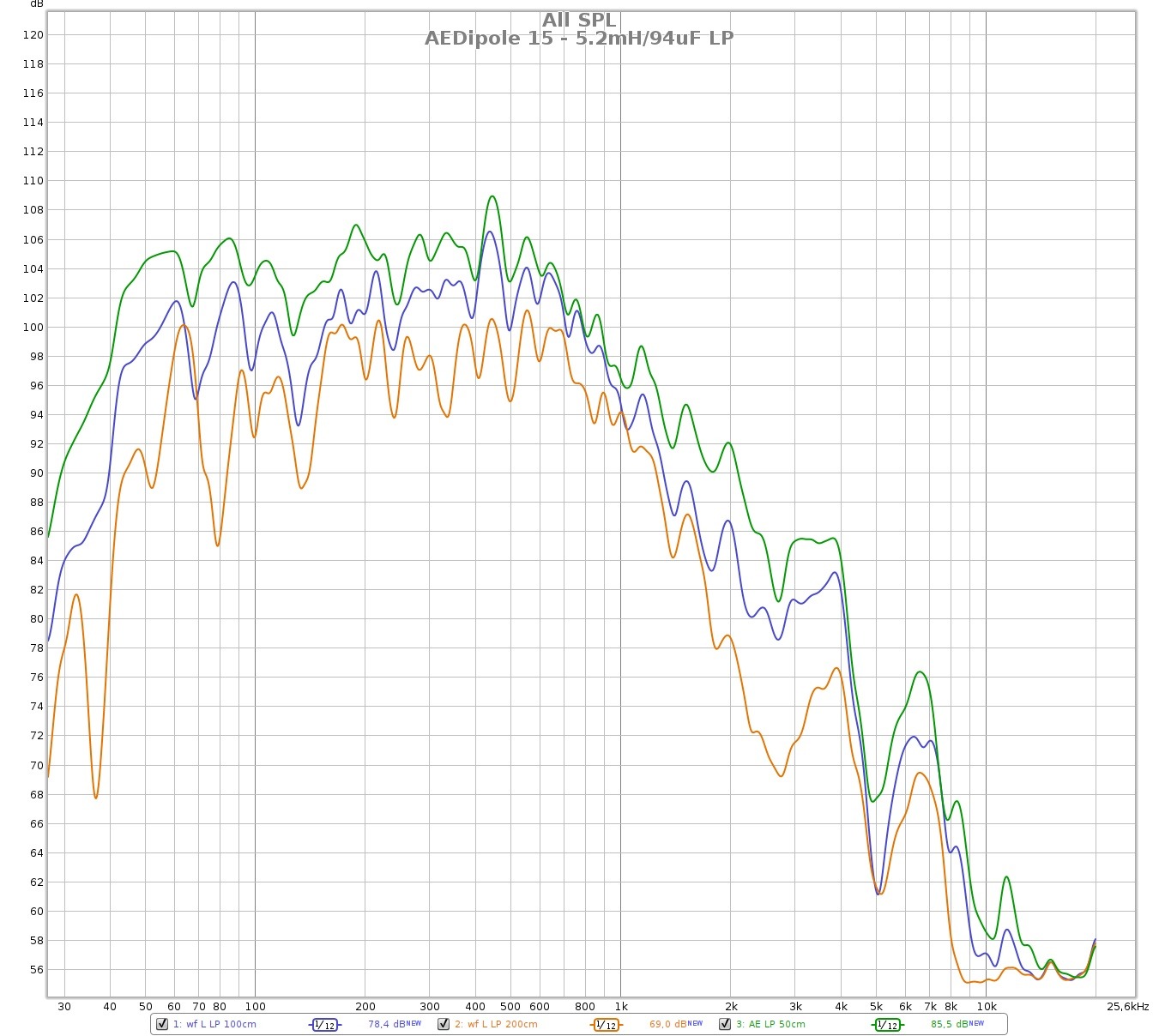

After a long period of rest, I finally managed to bring home my new Open Baffle project with AEDipole 15 / 16R, TD8M and Beyma TPL200H speakers.
All coils from AEDipole15 are connected in parallel to get 4R. Amplification for them I do with an NCore 400.
I did some measurements (UMIK-1) in Audiolense and as you can see the low frequencies start to drop sharply from 40 Hz.
I'm curious if anyone else did measurements for AE Dipol 15 ,and what the result was.

I have made a baffless system with one AE Dipole 15 with coil in parallel, b&g neo8 and neo3, passive xover and UCD400 amplification. here are some measures taken with the one woofer at 2m from wall, and at an height of 5cm from the floor, with a 2nd order lowpass filter with 5.2mH and 94uF :After a long period of rest, I finally managed to bring home my new Open Baffle project with AEDipole 15 / 16R, TD8M and Beyma TPL200H speakers.

Thank you , Robi , very much for your answer. In the meantime, I also spoke with John from AE, who confirmed to me what a normal 40 Hz descent is. So, I'm going to think of a subwofer. Otherwise the sound is very nice. I was especially surprised by the TPL200H (no back cover). It is so clear! And it has a very good synergy with TD8M. I cut the frequencies at 250hz-2500 in Audiolense with convolver in Roon.

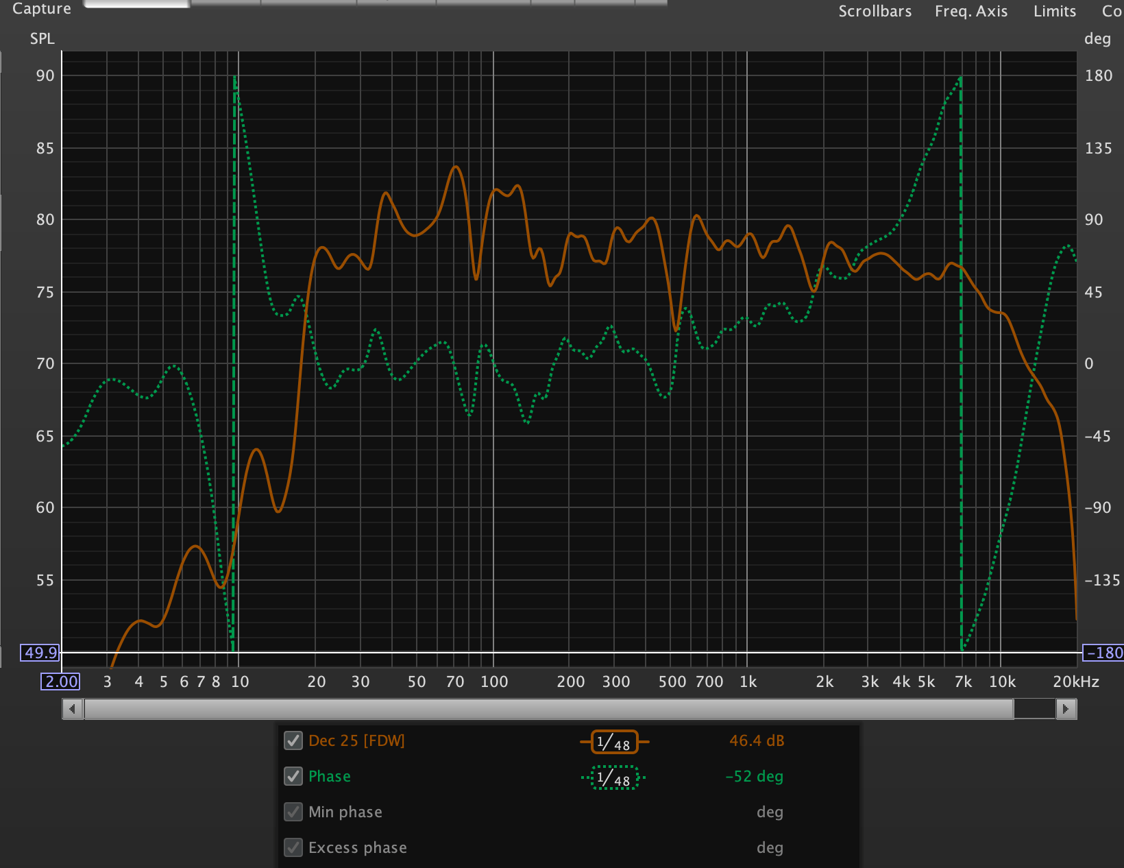

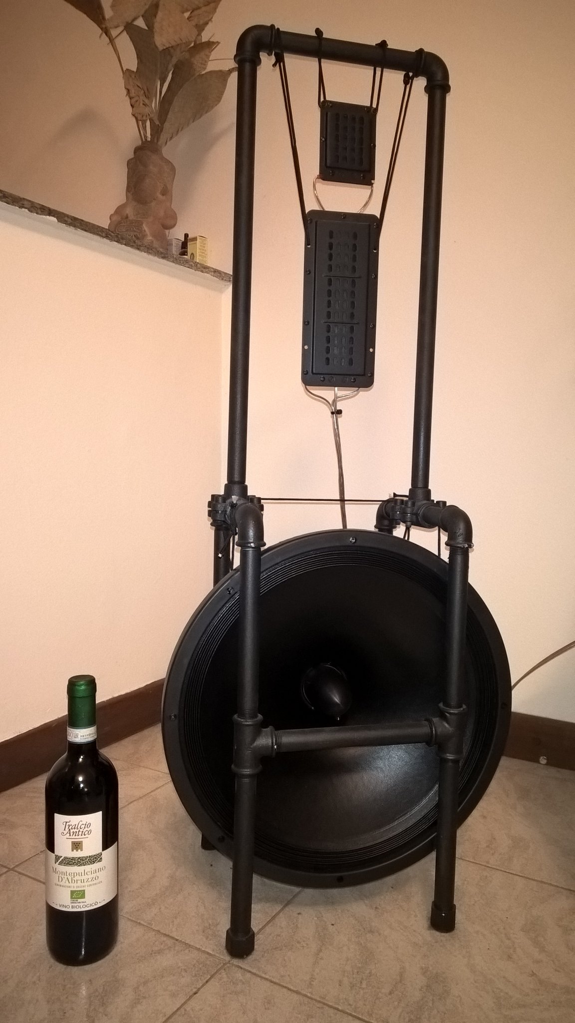

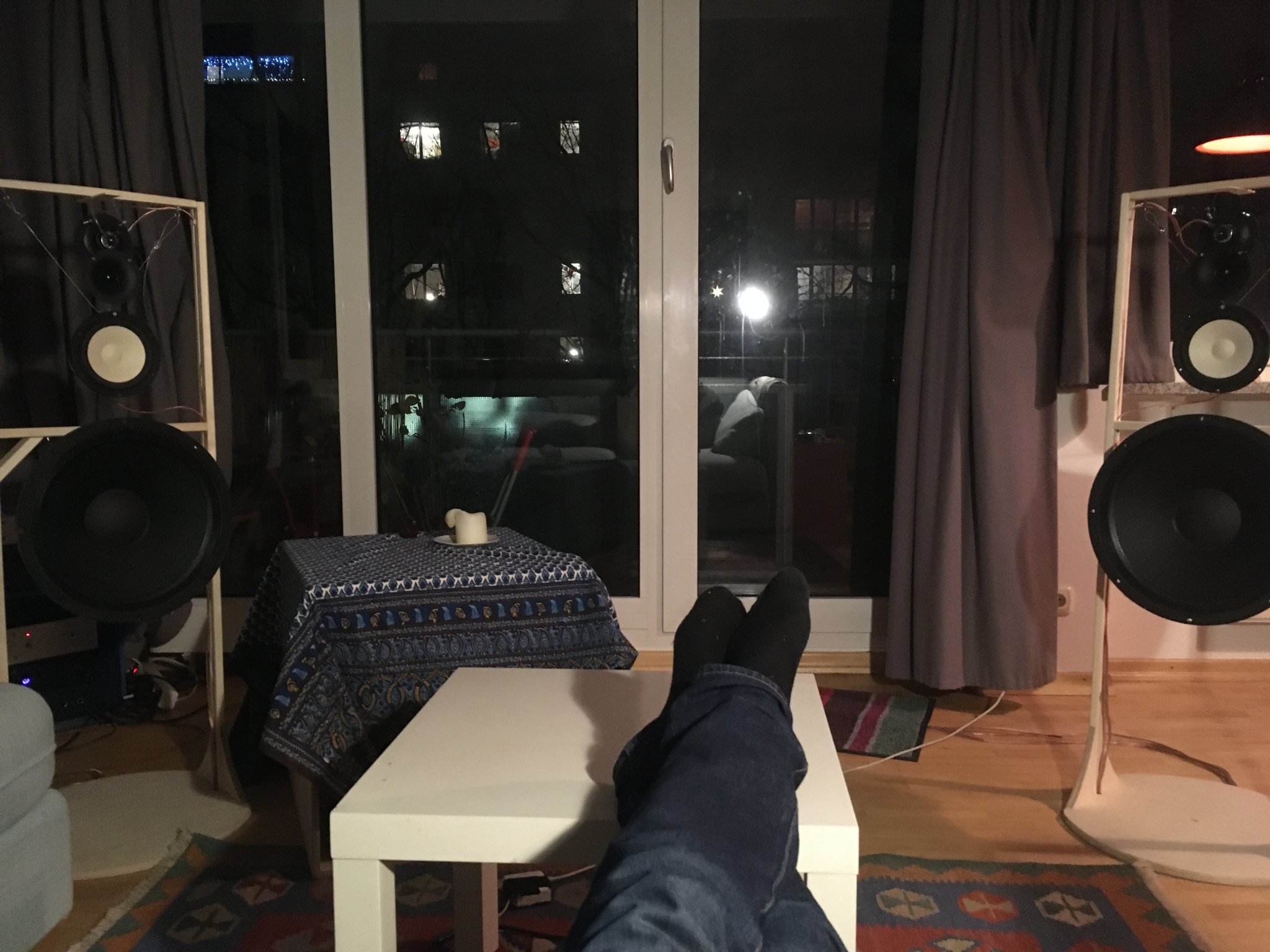

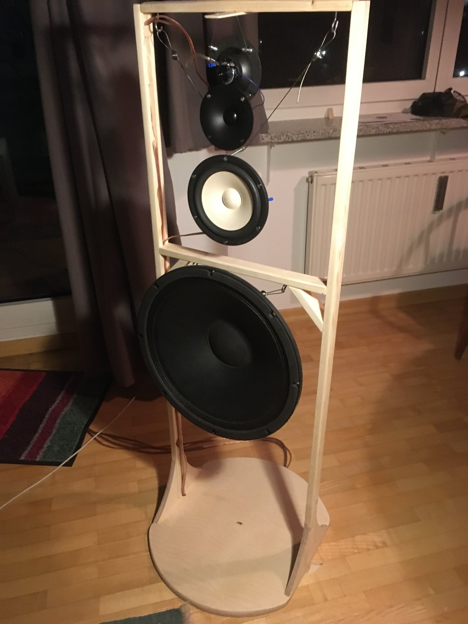

These are my latest no baffle speakers with an 18" H-baffle sub. The Sub is actually the table in the back.
All the important intellectual work was done by other people, where I especially have to thank Charlie Laub for introducing the idea of the Dayton Audio wave guided tweeter back to back. This is a very elegant solution for constant directivity in the treble region. I like it better than the cheap GRS planar I tried before. That one measures and sounds worse, at least to my ears.
The higher midrange driver is a Satori 6,5" woofer and the lower midrange a Faital 400Pro.
The sub is a sb audience bianco 18" woofer.
My listening distance is roughly 2,50 meters and the speakers are ca 1 meter in front of the wall and toed in. The subwoofer is toed in a little as well, that reduces room modes at the listening position a great deal.

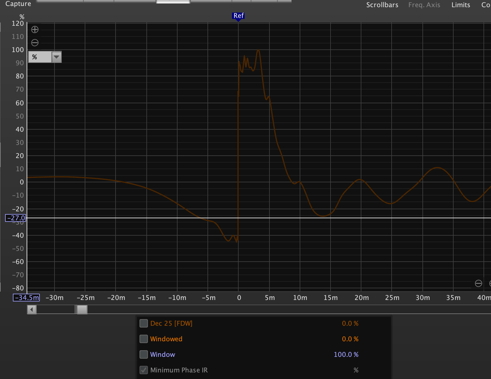

The right speaker measures like that in the listening position:
Step Response:

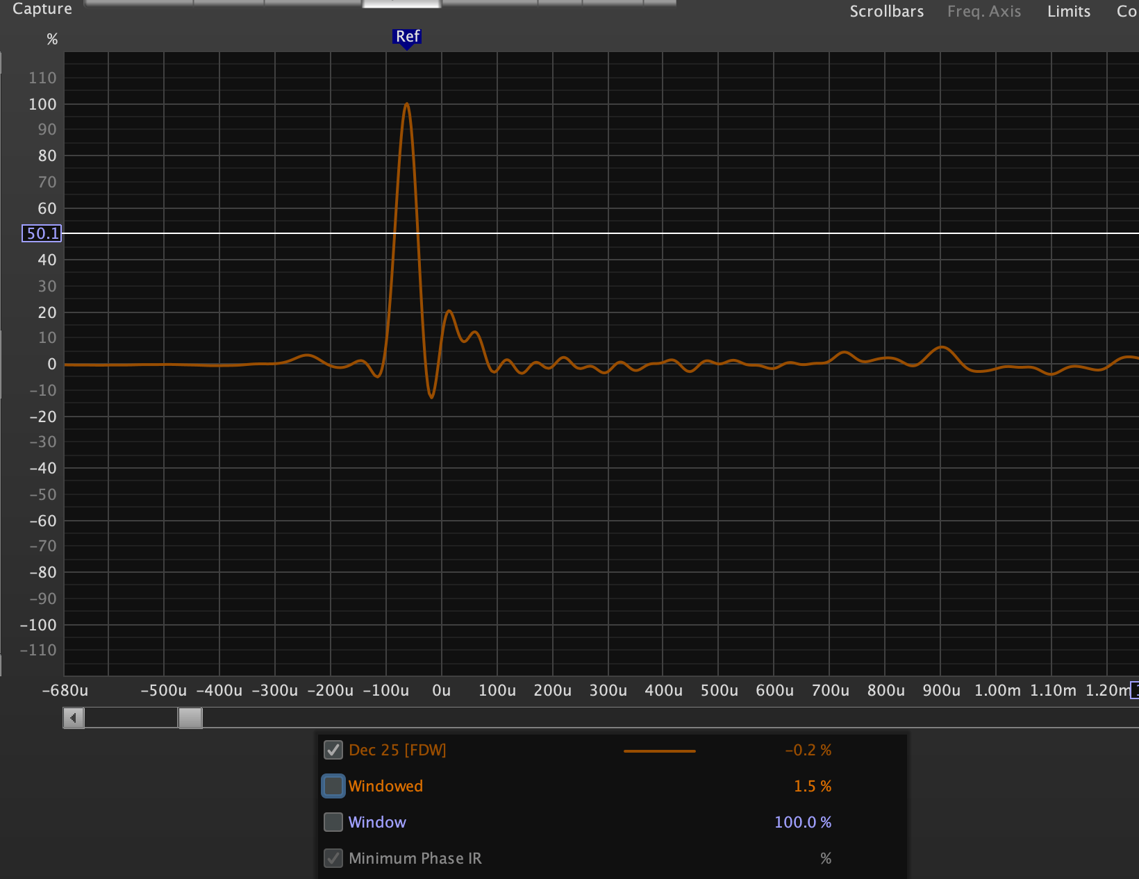

Impulse response:

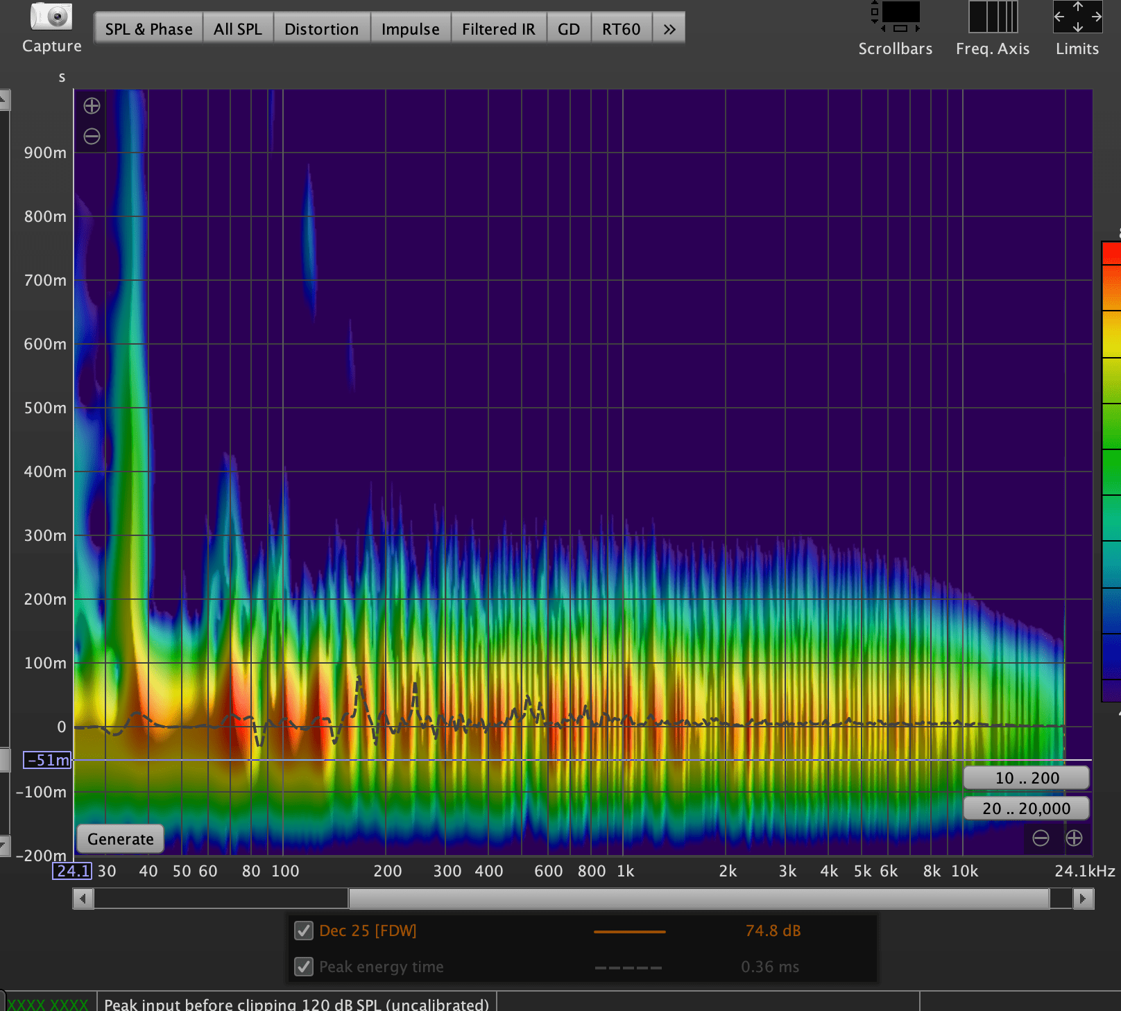

Spectrogram:
View attachment 1008590 Phase, IR and step response is reworked with rePhase and the resulting IR is inserted in the signal chain via Camilla. (edit: But I am still not sure if this is really an auditory improvement or just different, sometimes it feels as it sounds a little bit artificial)

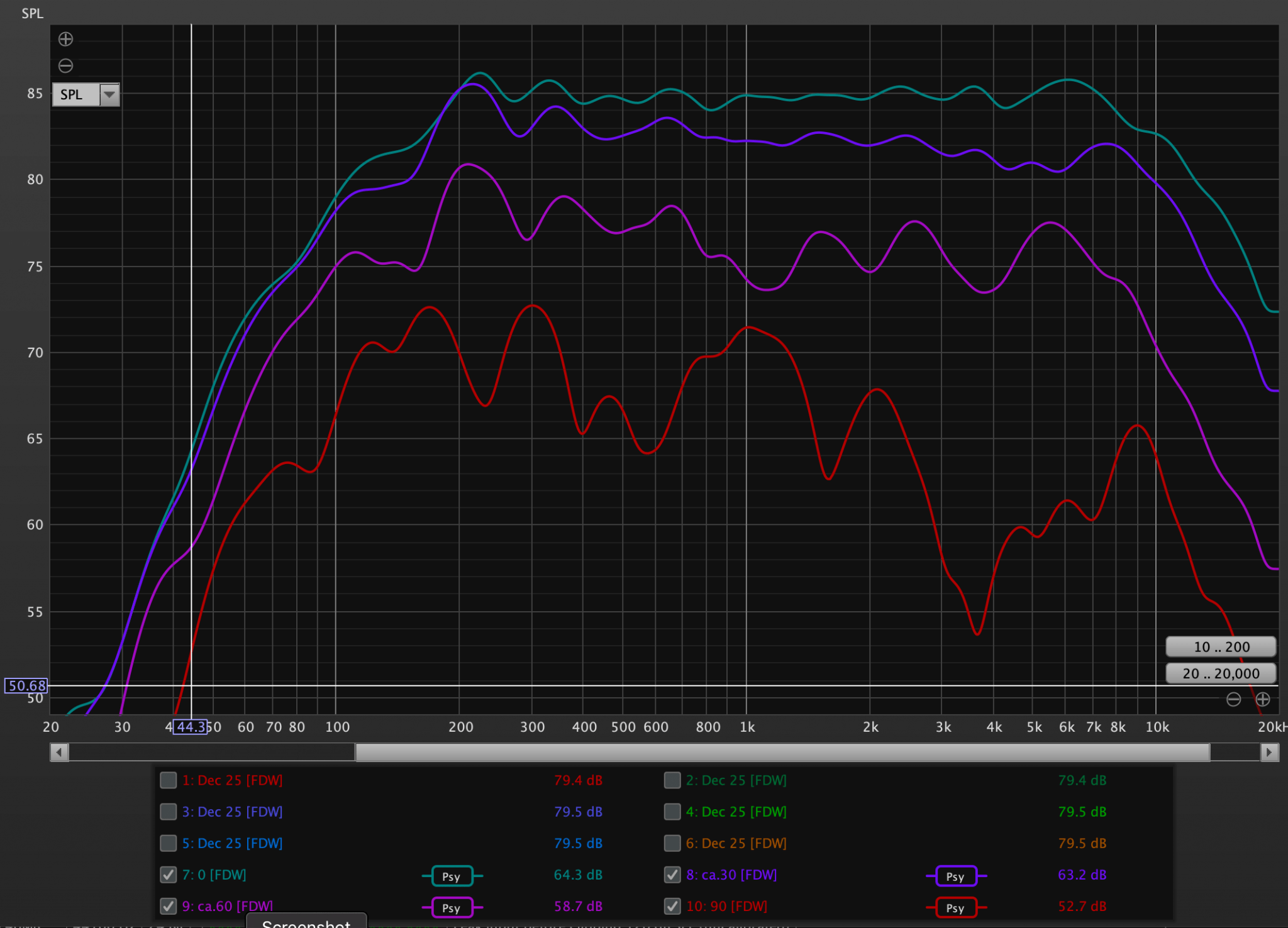

Directivity is as expected, these are the three drivers on the stand rotated from 0 to 90 degrees, measured a meter away in the room:
It is a very pleasing sounding speaker system now in my ca. 35 square meter, live sounding room. It took me some time to get the crossovers right for my ears, I started out with regular 24dB LR crossovers but ended up with roughly 12 dB asymmetric Bessel at 2100Hz from tweeters to midrange and at 400Hz from mid to low mid. The sub crosses at 100Hz steeper. Crossovers are made with two of those dsps, in that area might be room for improvement, better DA converters than those might make a difference, even though the speakers sound spectacular as is. This is the configuration I am going to live with for a while.
Thanks to everybody who made that project possible and merry christmas
