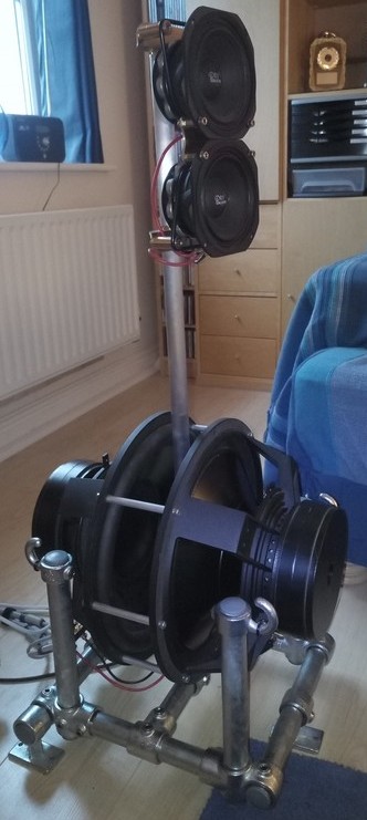

I'm also on an active 4-way system, with sealed subs below 65Hz, 18" baffleless midbasses on a swing up to 275Hz (I agree the swing does not transmit vibrations to the holding structure), lately twin 8" in OB MTM up to 1600Hz, and a Beyma TPL-150H with open back and a DIY waveguide to achieve dipole pattern (which works well up to about 7kHz).

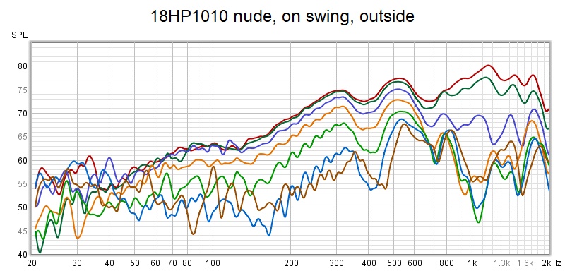

It's still a prototype in development. Earlier I had the naked 18" going up to 400Hz because a single naked 8" (also on a swing) didn't like going lower. Folks with a lot more experience on OB recommended bringing the 18" xo lower (a naked 18" dipole peak is at 350Hz) and I added a baffle for mids and a 2nd 8" and in fact added wings around the lower 8" (plan is to make it a 0.5 config with an inductor in between). This allowed me to limit the 18" to 275Hz, which I find sounds much better.

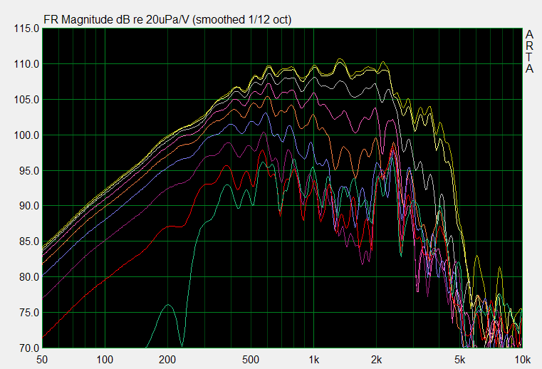

These are his measurements of the deltalite 2515 naked:
Frequency response is of course super important. But only tells part of the story. Here's mine, where you can see it's well behaved far beyond 400Hz.
Nevertheless my speaker sounds better crossing the 18" at 275Hz. Probably the mids play 275-400Hz nicer than the 18".
To me that looks more driver specific than dipole related?

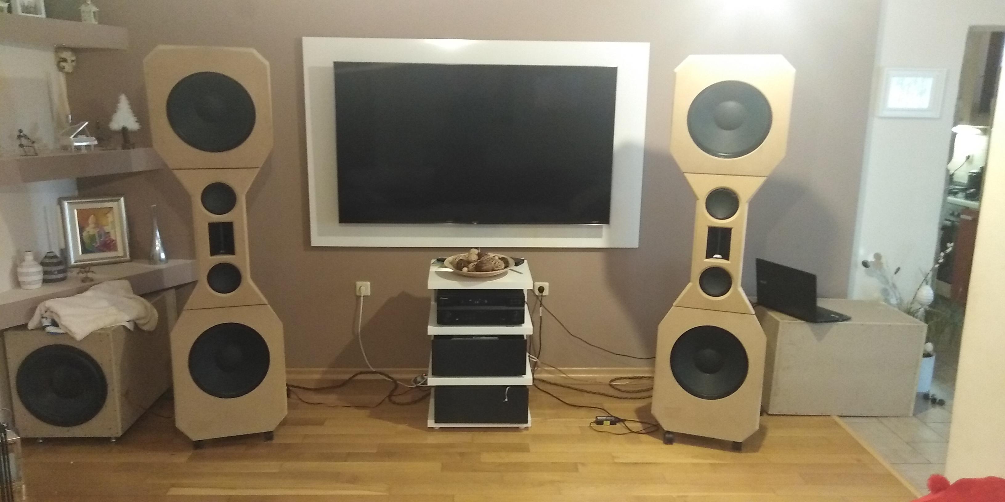

my 2way OB with ribbon helper, hopefully this is the final iteration. use harsch xo @240Hz
source : dell optiplex playing loseless with foobar2000 or deezer hifi, vlc player for bluray collection
- AD1865 dac with dcb1 preamp
- minidsp 2x4HD to : aragon2004 for 21" woofer and mauropenasa gainclone drives PRV 5mr450-ndy + beston rt002 ribbon tweeter with 3.3uf filter
- behringer nu3000dsp get mono signal from summing opamp after dcb1, then drives 2 dual-opposed sealed subwoofer 4th order @40Hz
in my relatively big room 5x6m with 3.3m concrete ceiling, eventhough my 21" subwoofer have 7mm xmax, it still can't fill the room especially for deep bass. that's where the subwoofer really help, it's mandatory during bluray movie
OB woofer + multiple sealed subwoofer :
my wide lens phone is not good enough, bad vignette can be noticed easily
Gadut, very nice baffles and diffraction wall behind

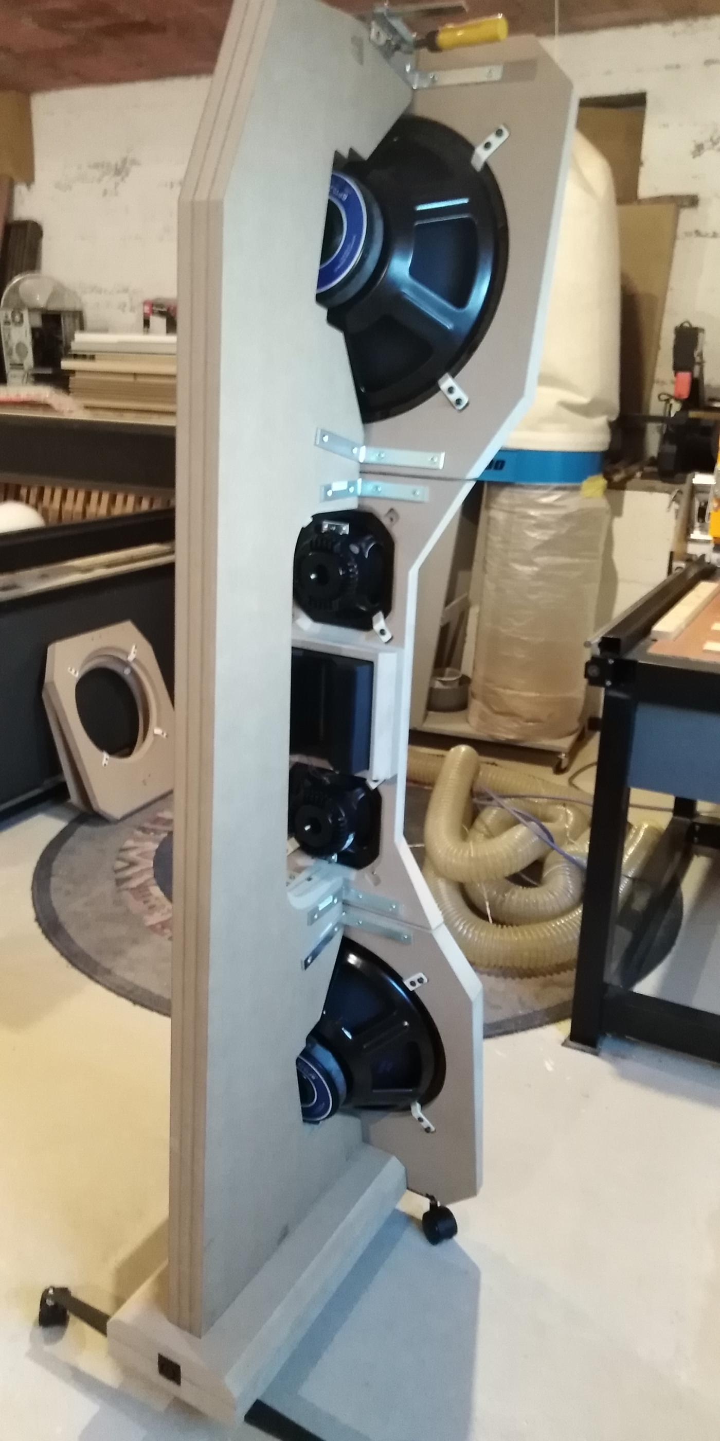

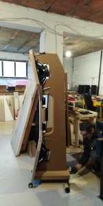

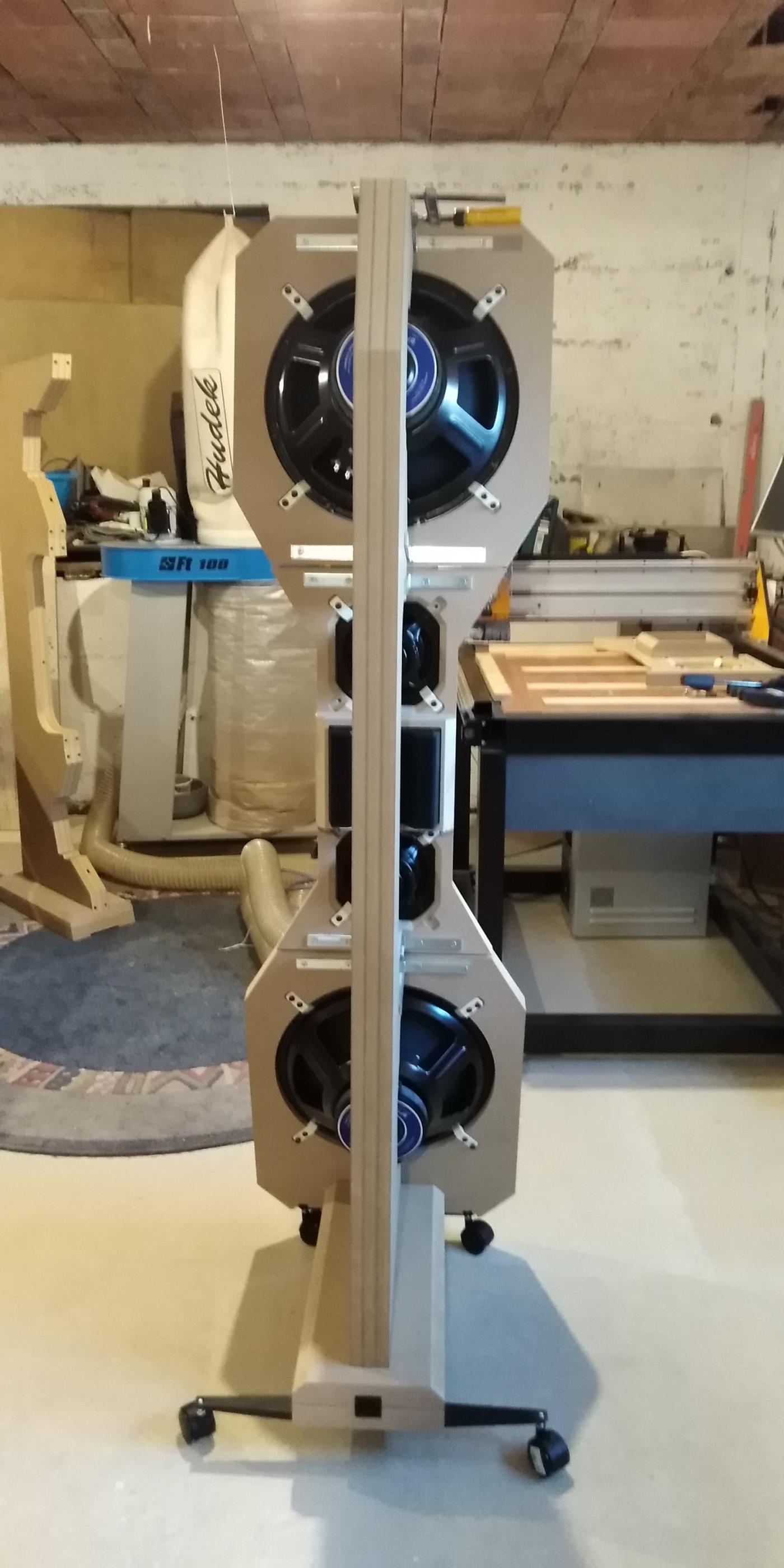

Could you upload pictures from the side to understand the construction behind the baffle?
As I said FA253&FA502, there is no any acoustic treatment so response is achieved only by EQ (and OB of course) and I suppose only at measurement position and close proximity. There is one more sub behind but it is not integrate well yet. I should try MSO but not enough time and too much good music to listen again

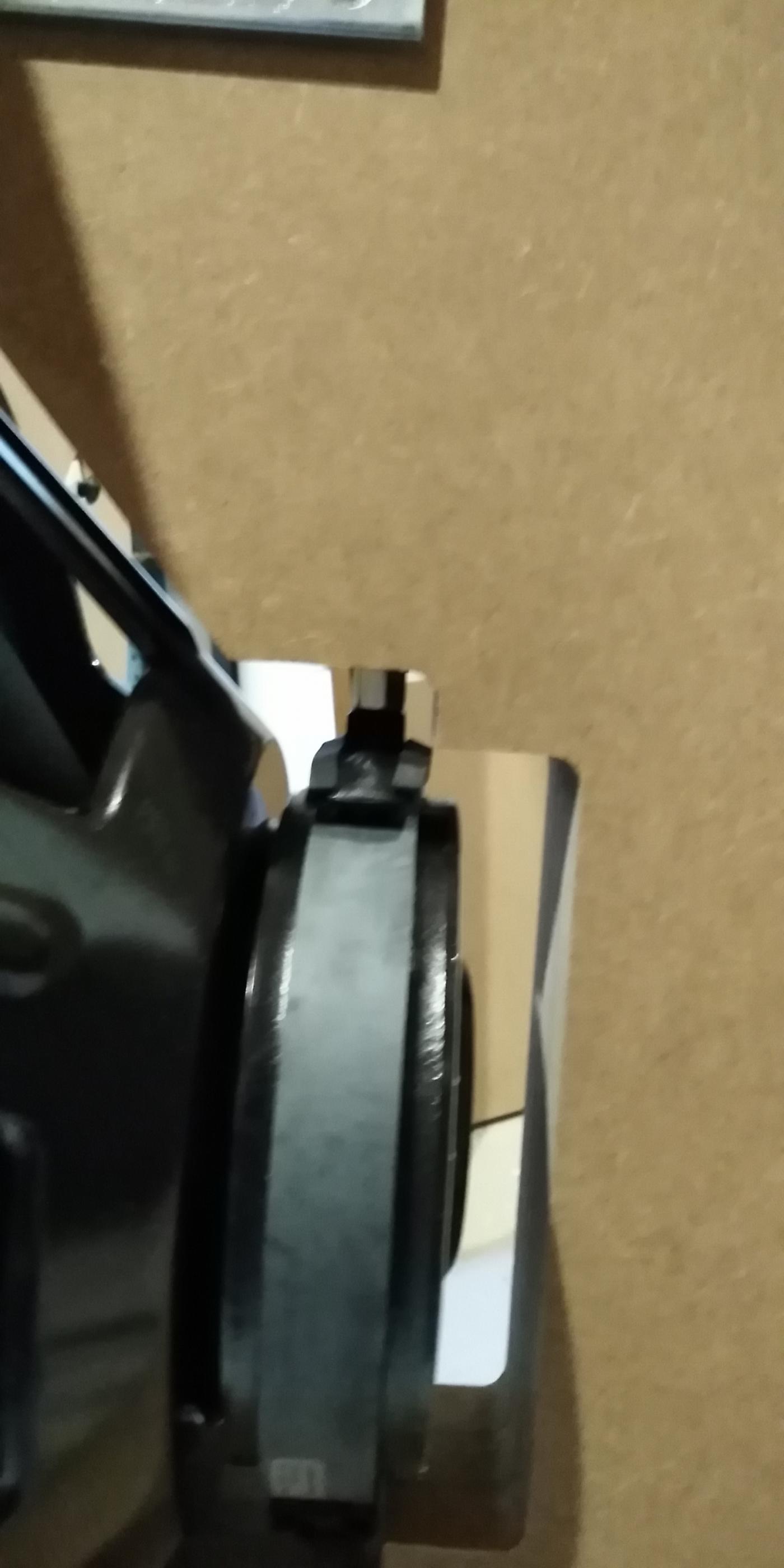

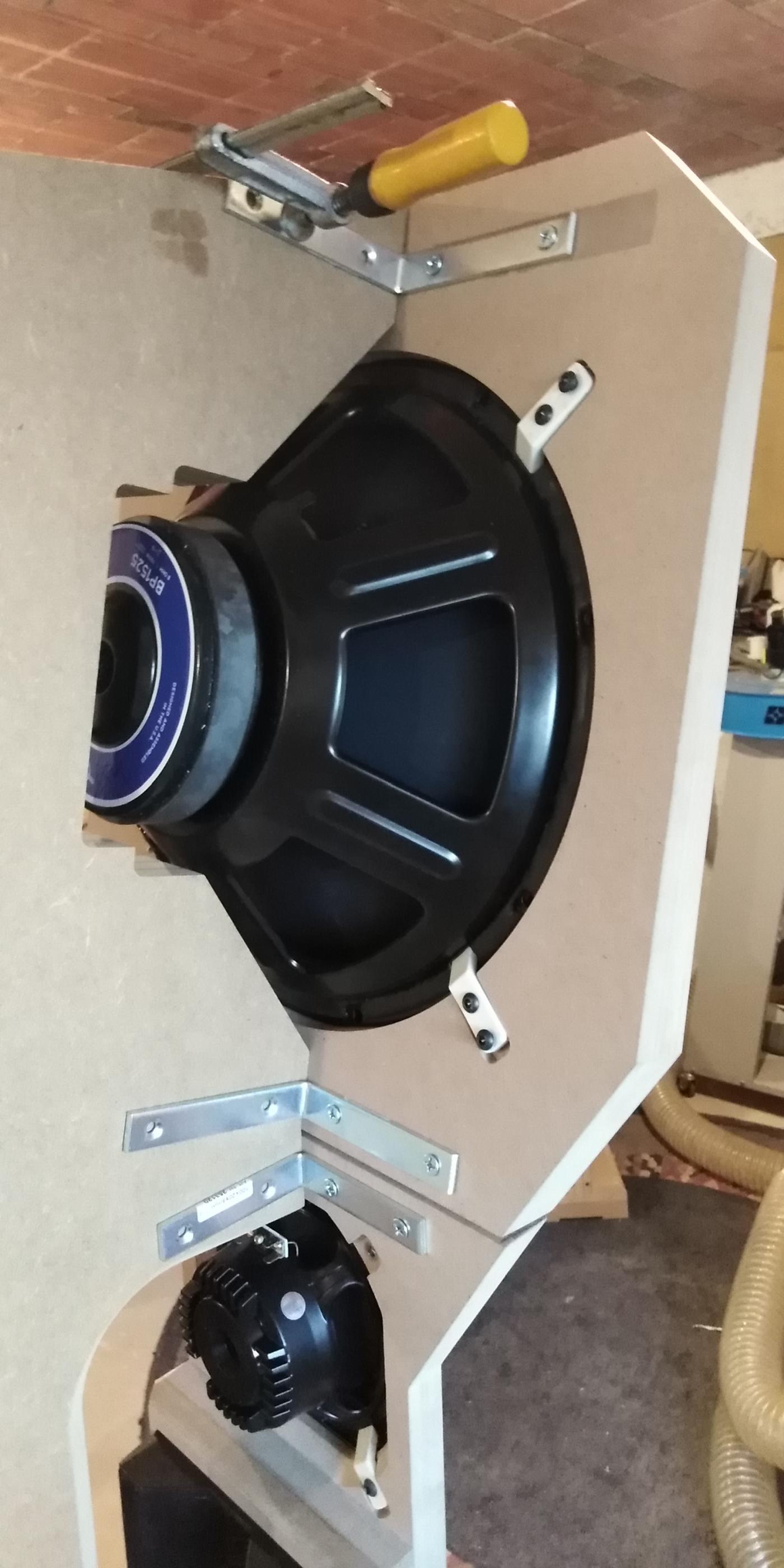

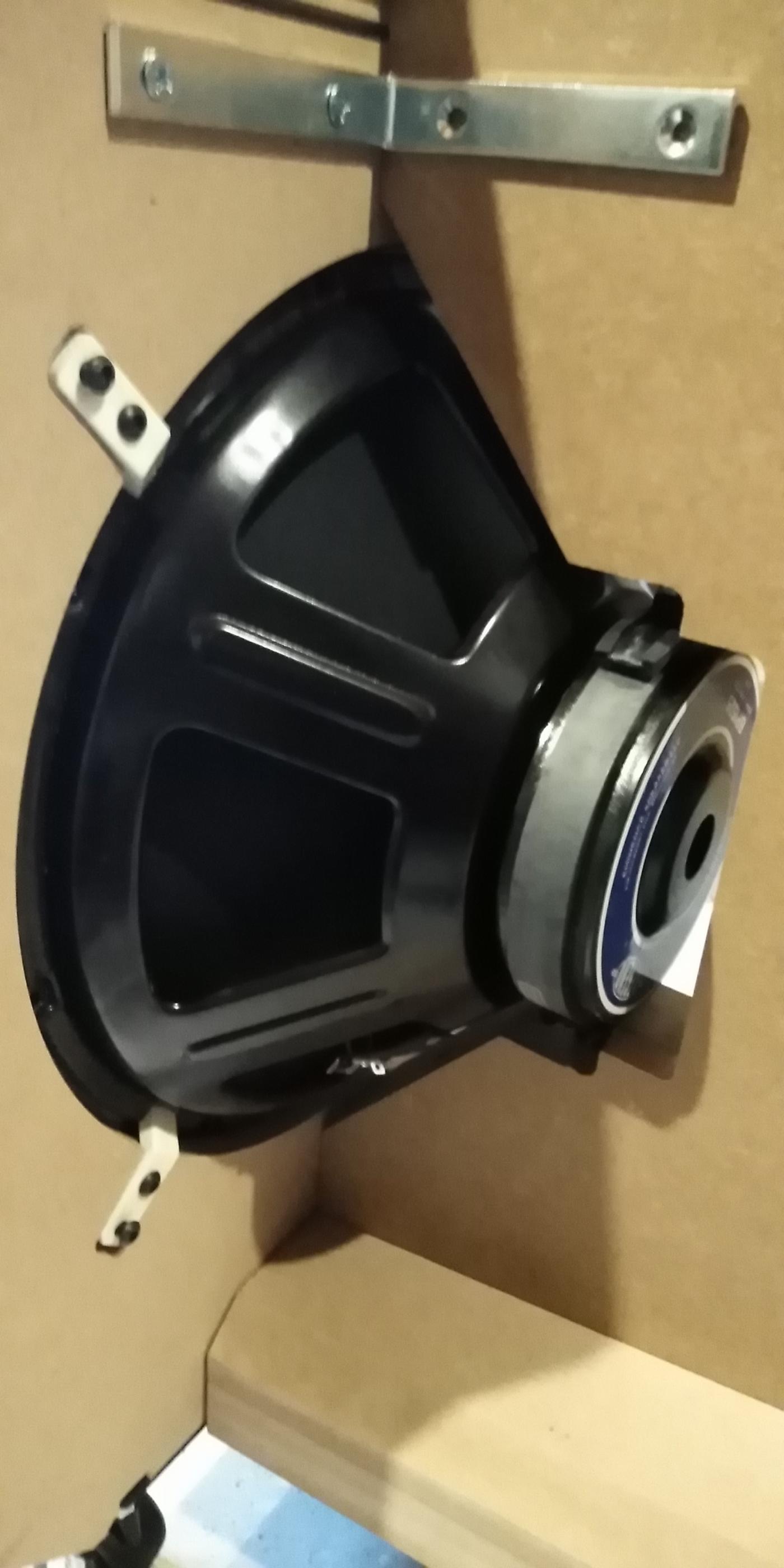

Thank you for posting those. Interested in the way you attached the mids to the baffle. I also have MTM with AMT tweeter.
Your mids aren't screwed to the baffle, right? You have the white metal pieces that are screwed to the back of the baffle and pressure the driver against the baffle. Correct?
Dipole highs are tricky. I've never found the juice worth the squeeze yet. How do you like those GRS tweeters? They make a few interesting ones!
They sound really natural I think. Like with all loudspeakers, you need blend them, wasn't too hard to do either.
I also like to mount from back, it looks nicer I think.
Here is my solution
Nice solution and woodworking!
I also like the looks of mounting from back, but I'm dealing with midranges with minimal baffle so it's challenging to find where to anchor. I'm still in development phase, though, so scouting for approaches.
