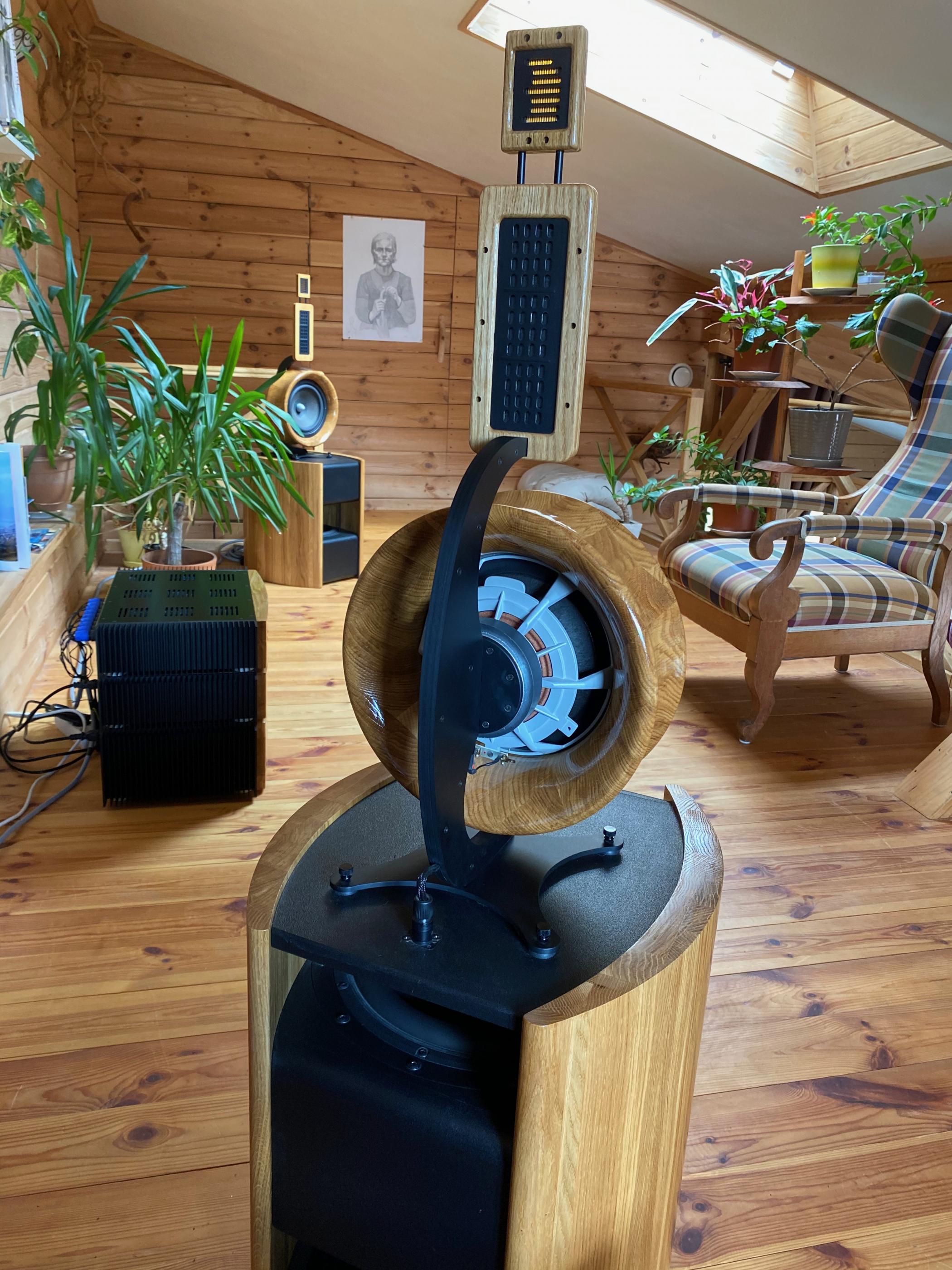

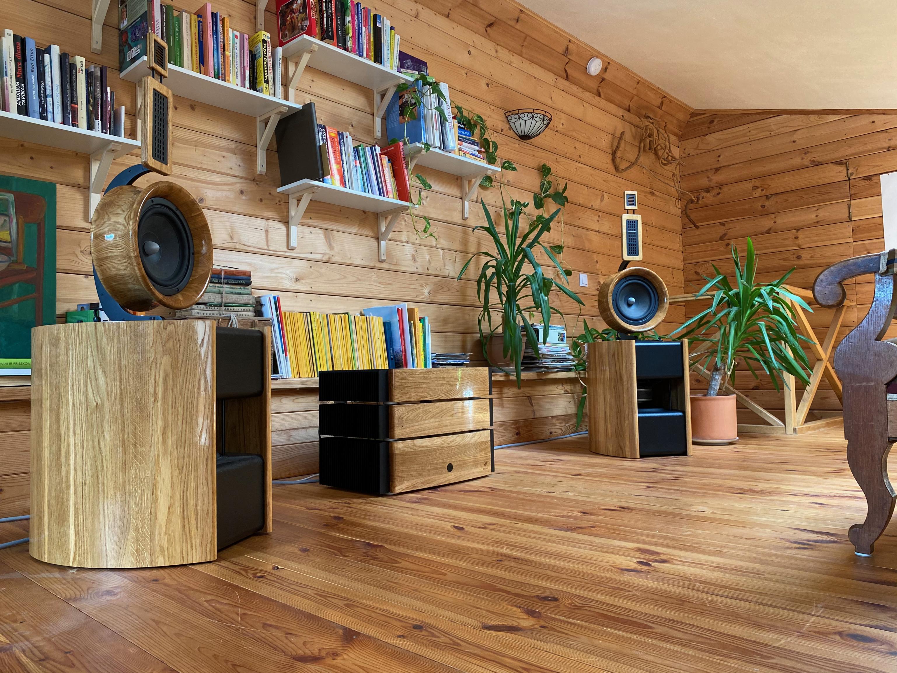

My design from oak. Sounds better than looks:) Unfortunately these days have so little time left from building stuff that only listening i do is for developing purposes.

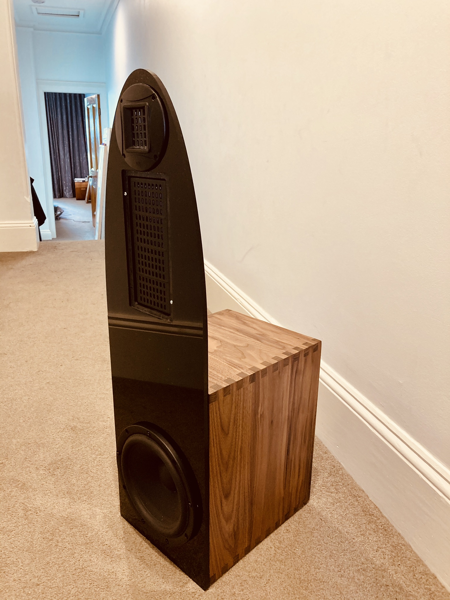

Test baffles for.my new hybrid open baffles.
Satori WO24P sealed bass, dipole BG Neo10 mids. Tweeters are currently dipole Neo3s, but I have a pair of Aurum Cantus AST2560 on a plane headed my way.

I've tried using mine a couple times, casually. Mine in singles have quite a rising response and seem to have a big jump from around 4000- 6000 hertz. Does your baffle shape correct this, of do you fix this by other means?

That is a wonderfully designed system! Glad to see some others who are NOT using large baffles in their designs. I am sure that it sounds very, very good. Cheers.
The lower mid baffle is effectively quite large if you consider the path length.
My rule of thumb on where "too large" lies is any (effective) baffle width that is more than twice the diameter of the driver. This is about where on and off axis responses start to "pinch together" above the dipole peak, which has also moved lower compared to a smaller baffle. If the driver is crossed over below the problem area, no problem. It's always good if the baffles are not physically large enough to block (acoustically shadow) the reflected rear wave.
If you mean the Arum Cantus, they haven't arrived yet.
Normally I do active crossovers with DSP, but this time I'm doing a hybrid system with passive crossovers, then active EQ on top of that for dipole EQ and response shaping.
I have the MiniDSP Pwr-Ice which has the EQ and amp in the one box.
That's a good point that's probably often overlooked. I wonder how much of an issue it is since reflections should ideally be diffused, do you know of any measurements or is it more an intuitive feeling? I might start a thread about the pros and cons of large/small/no baffle.
