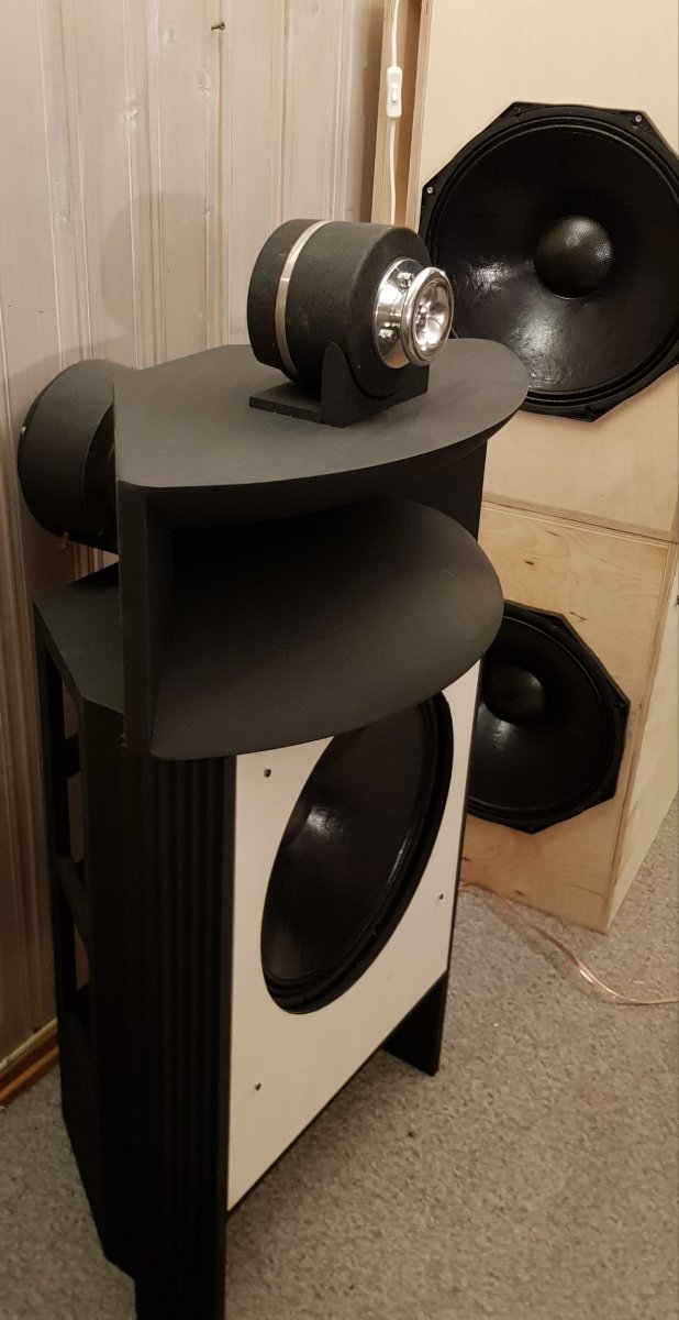

15" PHL Audio 5391 in open baffle
Celestion Axi2050 and TAD-2001 in Yuichi A320 and JMLC-2500.
Using the uncabinets in my secondary system with an old Polk sub, and a Miller Kreisel LP-1S passive highpass filter.
It's nearly as full in sound as with an actual cabinet, minus box resonances. However.
Something funny peculiar going on with the phase response of that felt lossy uncabinet I haven't encountered before.
For nearly all music, bass is integrated perfectly, but with some Steely Dan and Led Zeppelin songs, (not whole albums) the bass both detaches from the satellites, mutes itself slightly, and is clearly coming from the subwoofer.
Still, it's been an interesting experiment, and aside from those rare anomalies, it's very satisfying sound.
These have displaced my old favourites, Scanspeak Revelator woofers in sealed cabinets plus the tweeters du jour.
Anyone have any theories on what's going on with the bass phase?

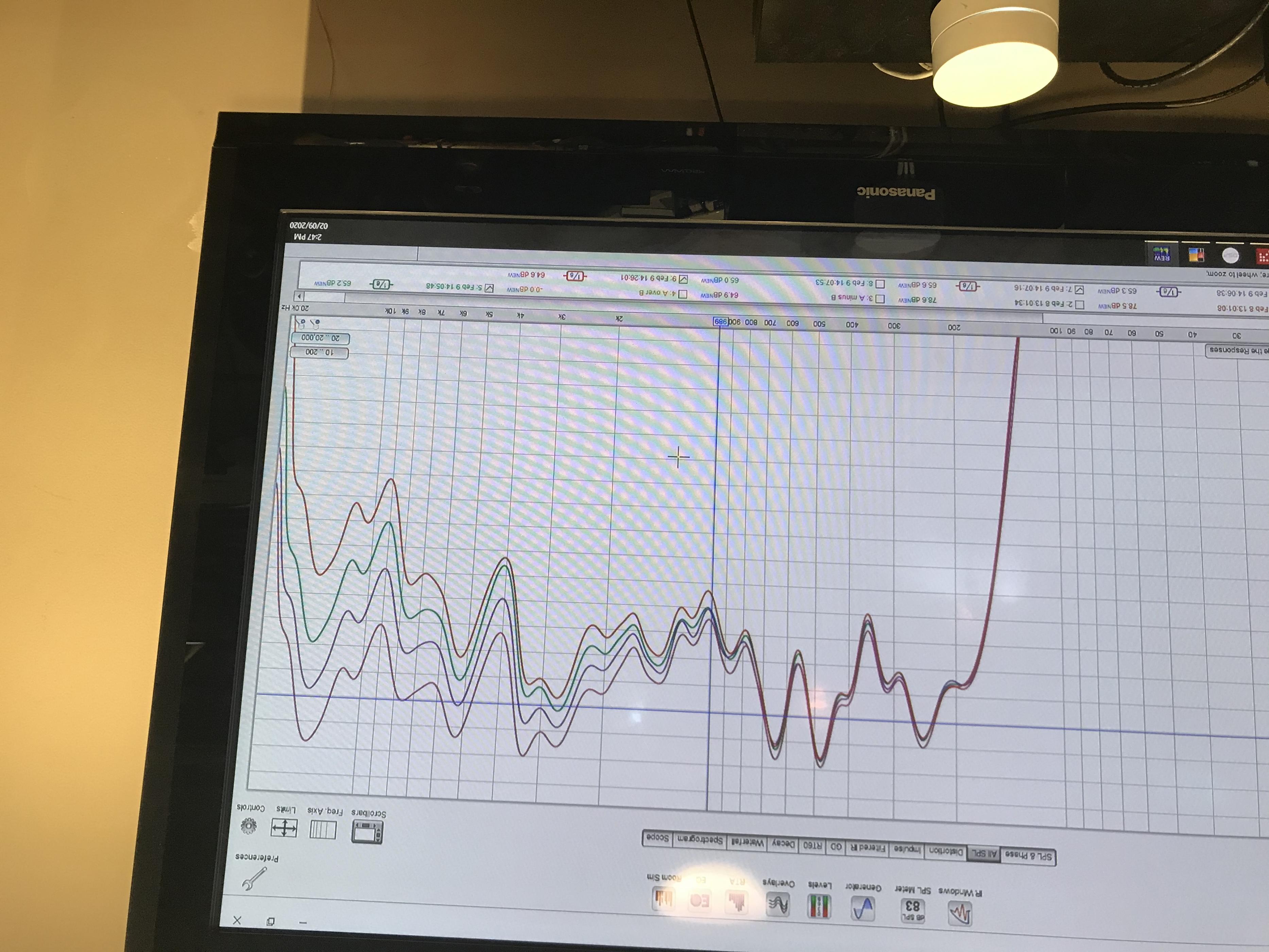

I recently tested the effect of felt between driver and microphone, because I wanted to see what, if any, phase alteration it might produce.
I didn’t see anything of significance on phase. I did see just over 2db attenuation per 3/16” layer looking like a very low q high shelf starting at about 1.8 kHz. The start frequency drops a bit as more layers added.
I was thinking it might be possible to create a front of driver passive filter that attenuated the on axis response but not as much off axis...I have since determined that with a 10 degree driver tilt back, I get even response over a +/-20 degree angle, and I don’t need response any wider than that.
So I can’t imagine why felt would impact, unless maybe the entire felt layer is moving?
Sorry, don’t know why my picture showed up inverted?

I've come across a very few other recordings where this happens.
Perhaps the small baffle surface area to driver area ratio, plus the boxless sound unmasks bass irregularities more than other speakers I have here.

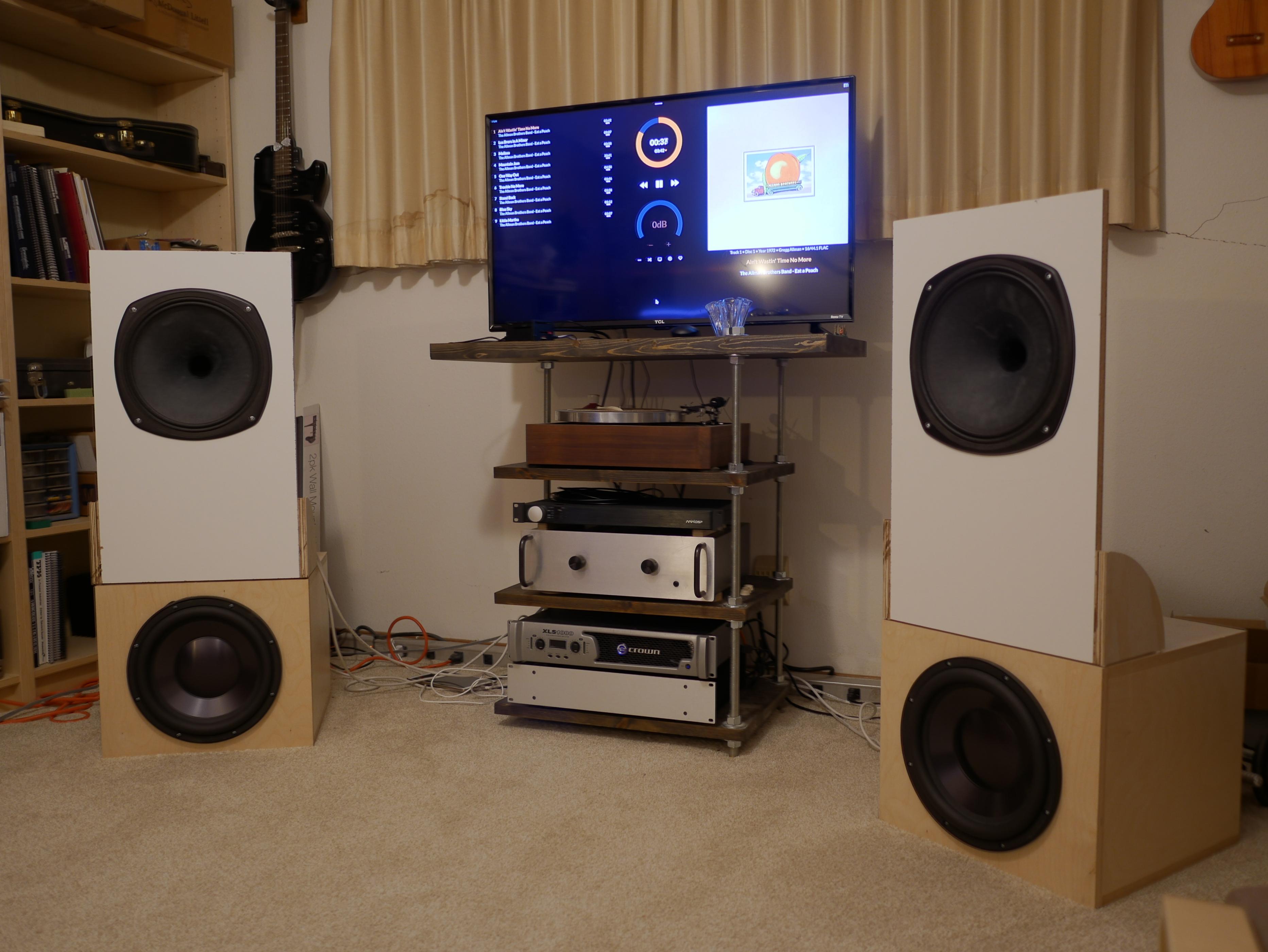

I've come to love open baffle plus horns.
Here's my current system using a horn + OB + woofer:
{Raspberry Pi4 running moOde, HiFiBerry Digi+ coaxial SPDIF out, FLAC files on HD and streaming internet radio}
or {windows PC, Topping D10 USB DAC, Toslink out for Amazon music, YouTube, or REW for measurement}
or {TCL Roku TV analog output}
or {modified AR-XA turntable, Grace 707 Mk II tonearm, Shure V15V, Curcio Daniel 2 phono preamp}
Into a miniDSP 4x10HD for xover / EQ, using all balanced outputs to:
4 channels of Modulus 86 amps powering 12" Tannoy dual concentrics (modern ones intended for use as ceiling speakers) on flat baffles
Crown XLS1000 powering Dayton RSS315HF woofers in sealed boxes, with Linkwitz transform to extend the LF response.

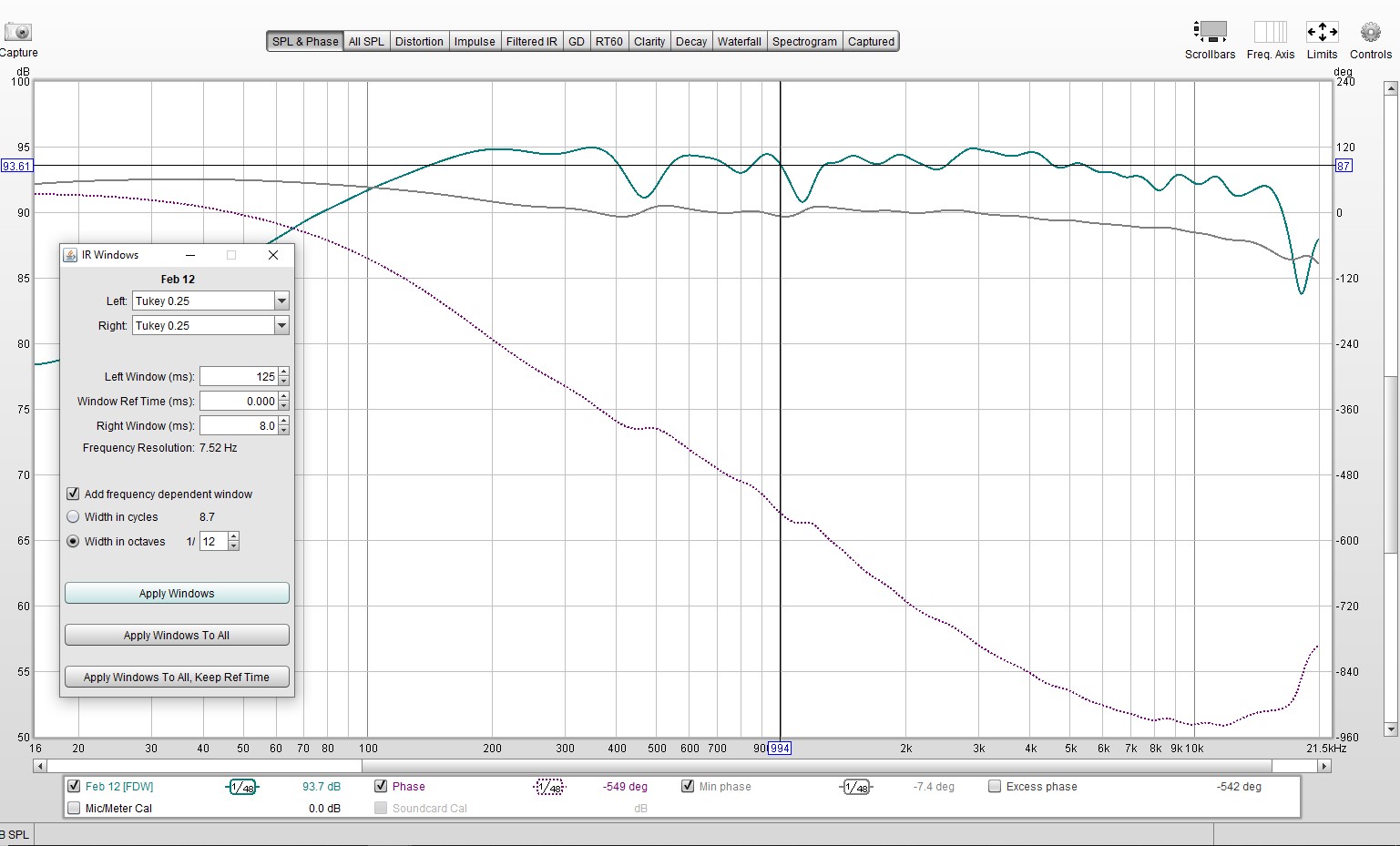

I'm still trying to eliminate some 'honk' from the tweeter, but the overall FR is pretty decent IMO.

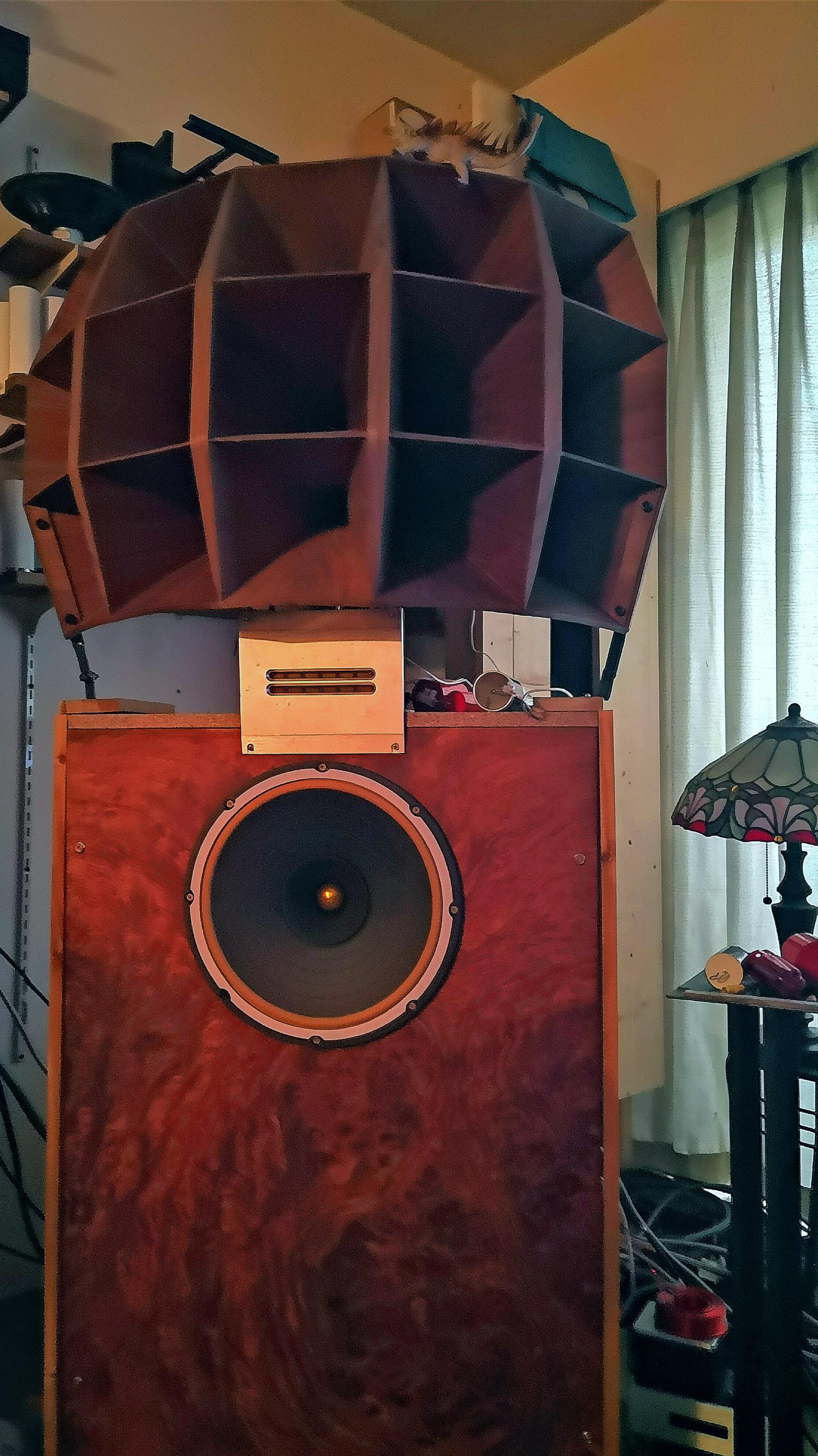

Driver shuffle.
Selenium D250x phenolic midrange driver in the horns now, and the Peerless compression tweeters are out, replaced by some older HiVi planar RT2II tweeters.
First order filtered, x-over points chosen for useability without volume pads.
Still using Dayton RSS 265 HF-04 drivers in sealed cabinets, handling bass first order til 125 hertz, 12" full range goes til 5000 hertz, Selenium 250x goes til 9000 hertz, where the isoplanars finish up.
Yaqin 300B doing the drivers you see, and a Behringer A500 driving the subs.
It's a strange amp, insofar as it seemed completely inadequate to drive bass for the first 3 or 4 days.
The fifth day, I kept creeping its trim pots down until settling on about half volume, to match the @ 100db/watt satellites' output levels.

… I'm still trying to eliminate some 'honk' from the tweeter, but the overall FR is pretty decent IMO.
I did a lot of Grace 707/ARX modifications. But never put a V15 into it. I am not a fan of that cartridge. It may well be a source for honk.

Any SQ evaluation I do is with CD's ripped to FLAC. I suspect the honk is more related to HOM's in the horn throat.
The V15 was high enough compliance to work well with the low-mass 707. It's pretty old now. I really should replace it but don't spin enough vinyl to want to spend much for a new cartridge. I had hum problems with Grado's, and haven't kept up with what decent budget cartridges are available.

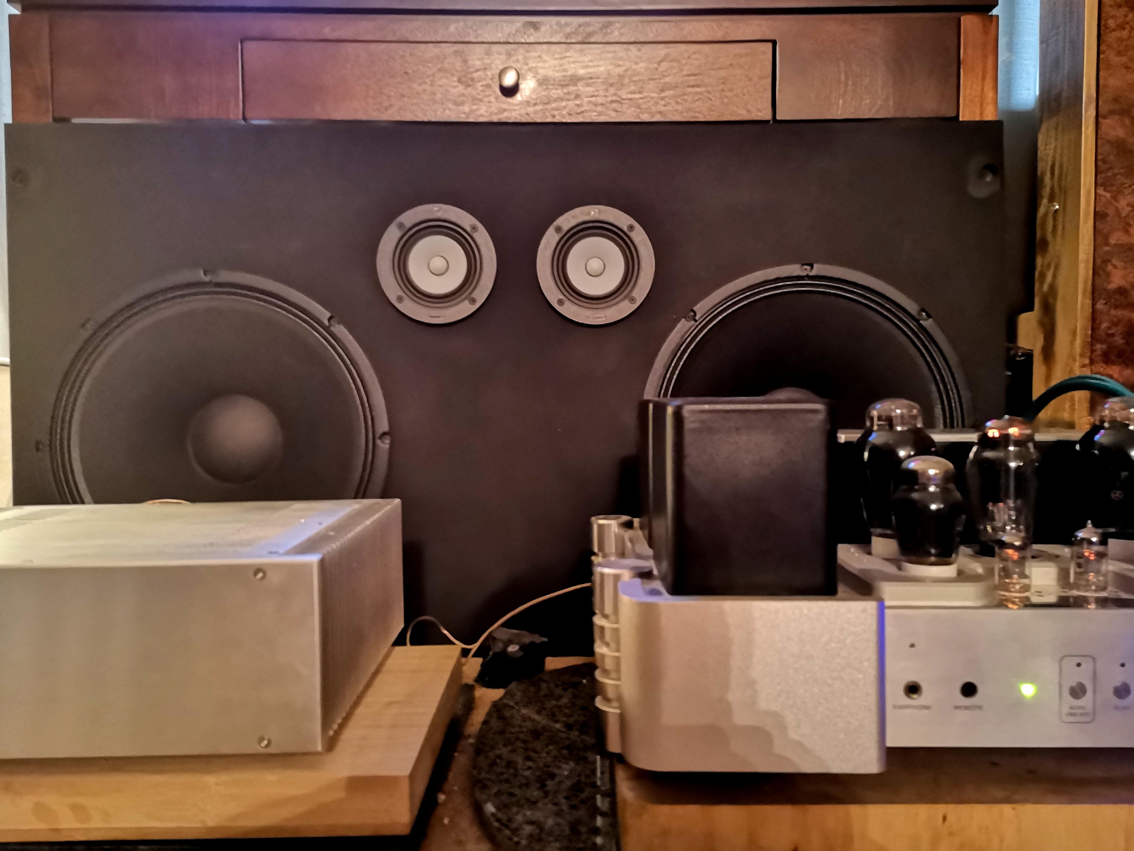

E2
Serving bass, two ways
A simple open baffle, 44x24", mounted under my TV, on the front of a writing table.
Two 15" 1525e, filtered each with a 12mH coil, powered with a 300B amp, which also powers my open baffle hybrid horns.
Having the woofers so close to each other gives them enough boost to play bass nicely louder than the same efficiency satellites, filtered first order at @ 150 hertz.
Those are two MA Alpair 7P, doing centre channel chores.
They cross with my processor's 130 hertz set digital 4th order filter, and work very well with the two 15" being so close.
With a mighty 10 watt stereo amp feeding each driver, together they keep up, and needed to be trimmed down 3db relative to the main speakers level.
As good as I need, but I still have 6 more 15" cluttering up the place, I'm thinking I'll do 2 in a sort of transmission line enclosure I've been imagining and tweaking in my head for about a year.
It should extend these drivers output to about 25 hertz, I think.

How do you like the A7p? How many hrs on them?
That is not going to be small :^)
dave
I like them a lot. Probably the 7s have a couple hundred hours on them, but we're only exposed to about 2000 hertz and up.
In this use, they're doing 130 hertz and up.
They manage to be lively sounding, without sounding bright.
I'd hoped two with 10 watts each would match the level of a single 12P, and in fact they exceed it.
I'm shocked at how fast the woofers go, and stop, with single ended tubes, instead of a bigger solid state amp on them.
I guess my plate amps will be for a different project.
