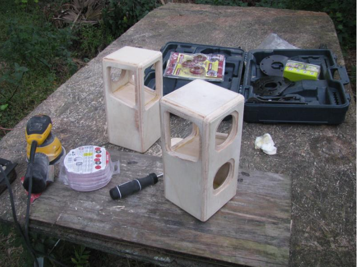

The back below the carlson resonator and the bottom of the cabinet are open. That is not so small but smaller than only a baffle of course. I do not use the grill cloth anymore, it sounds better without.
I've been intending to try a Karlsson resonator, but have no clue on tuning them with Thiele Small parameters. Just treat them almost like a u Frame rig?
I use the karlsson resonator for another purpose; it diffuses standing waves in the outlet. The karlsson cabinet is more of a bass reflex cabinet with an exponential opening.
Giving Pm6a's a try with a -3db HP is all.

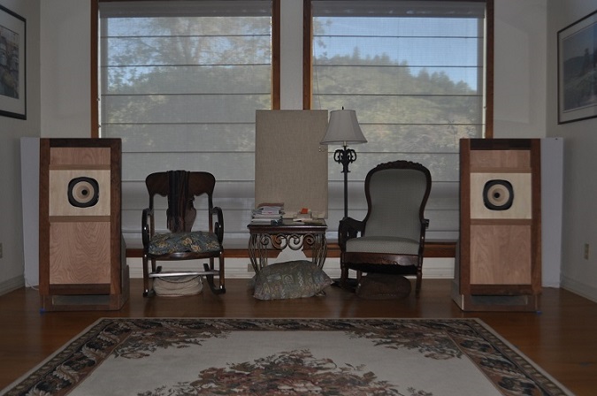

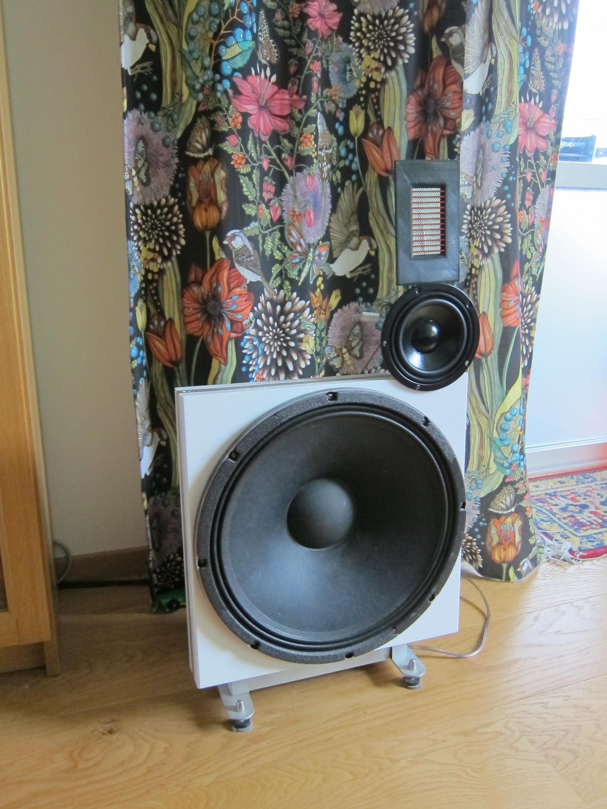

Maybe like this "WAFY" speaker, 40 cm wide, 75 cm high, 25 cm deep...
Eminence Neo 15 inch +visaton 130 mm and a low distorsion home built treble planar.
Sensitivity is around 90 dB and this speaker is the only one that I'm happy with after testing many speakers, through almost 35 years, factory made and Diy.
I can also provide the very simple but optimum 6dB cross over schematics.

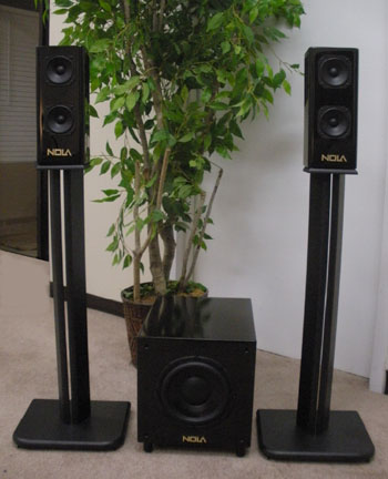

Then, do not do real open baffles.
Unless you are happy having small tiny sound and no bass.

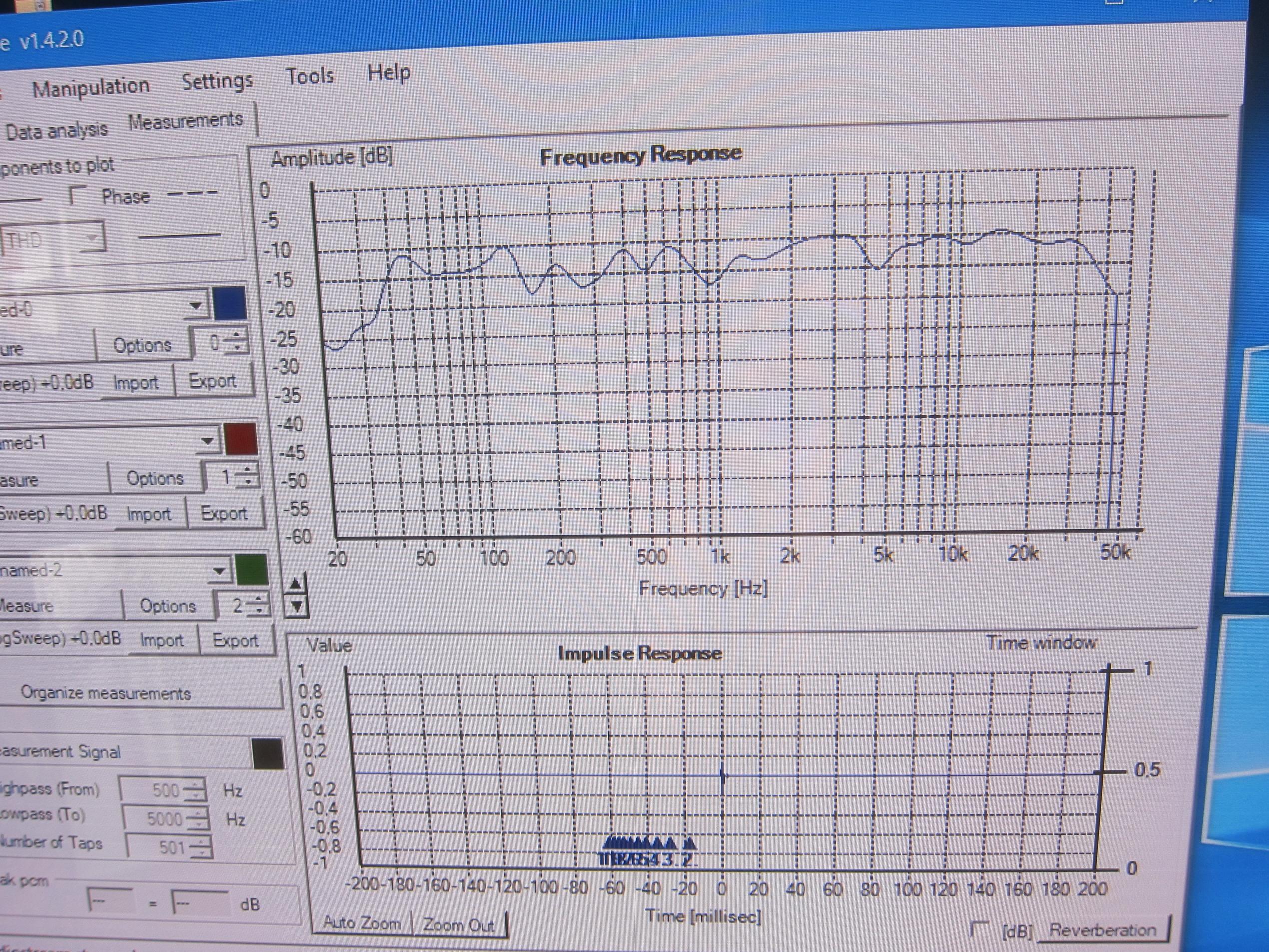

Here's another option combining small and OB sound.
The Nola Brio Trio.
Two small enclosures, two drivers per side, one is vented, the other is OB.
They will need one or two subs that you can hide somewhere in the room, under a table, under the couch, etc...
There's a thread to DIY them here:
Need help building open baffle/bass reflex hybrid
Just paint them white instead of black.

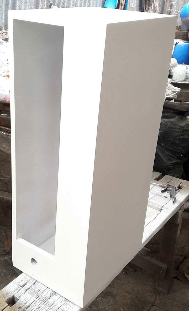

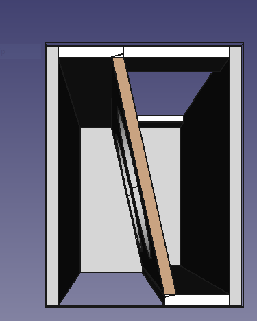

I have built a pair of N-Frames, 2 12" drivers per side.
They are symmetrical (left and right are mirrored), easy to build.
On top I have JBL 308 monitors (no time or skills to do a complete speaker.).
Only 25cm wide is quite small, but you could make them smaller.
The photo is from the rear side btw.
