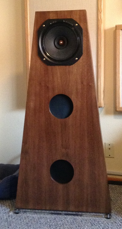

Here is my Yield OB project.
Uses Audio Nirvana Super 10 and a pair of Alpha 15's.
Dave
412168d1397364749-ultimate-baffle-gallery-img_0055-jpg
Dave,
How tall are these speakers? What is the width at the base?

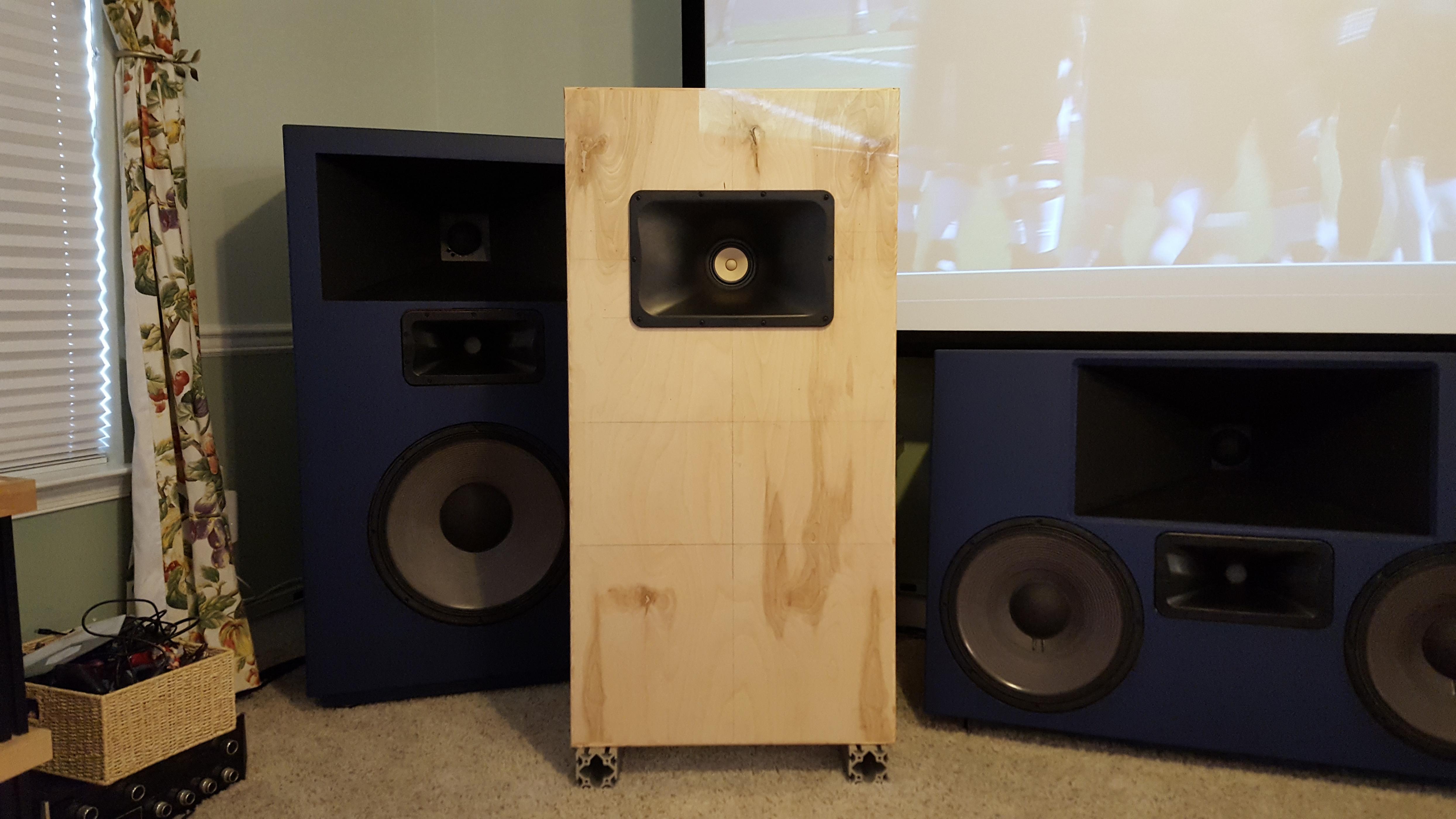

Building my first pair of open baffle speakers. For testing I am starting with the following:
1) MarkAudio CHP-70-P Gen 2 Natural
2) JBL Pro PRX700 horn (4" throat)
3) 24" x 48" x .75" plywood
4) JBL Pro 2123H 10" midrange
5) Eminence Delta-10A 10"
6) JBL Pro 2226H 15"
7) Pi Speakers H290C HF horn (1" throat)
8) B&C DE250 compression
Items 2, 4, 5, 6, 7 and 8 are leftovers from previous builds.
Have played around with Basta program over past few weeks, will see how models compare with reality.
I really like horns, my main home theater speakers have horn HF and Mid, crossed over to a JBL Pro 2242 18" driver for bass. Each speakers weighs around 250 lbs. The Auto-tech horns look really nice, lots of builds with them paired with Lowther drivers. Since no one in the US carries the horns I decided to use a spare JBL midhorn with an inexpensive full range driver.
Here it is so far....

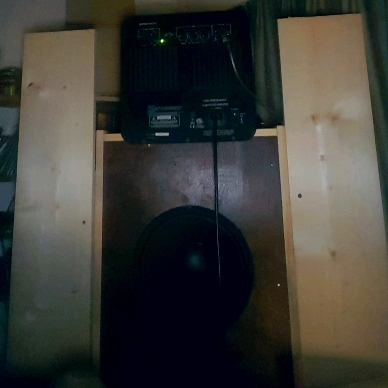

Ive gone back to Onkens with midrange horns, for the most part, but still prefer dipole bass.
This past weekend, I swapped out 4 Dayton RSS265HF-4 sub drivers, medium qts of 0.44, for some inexpensive GRS 10PR-8 polycones, with a 1.15 qts.
I know a higher qts should give better bass on an open baffle, but I had not expected this much.
At a lower volume setting on the plate amp, and wired for an 8 ohm load, rather than 4 ohms, even.
With the lower Qts Daytons, I could see the drivers moving a total of a half inch travel, with less audible output than the cheap GRS drivers, which barely move at higher volume levels.
What's going on? Shouldn't larger displacement play louder?
The drivers are in a u frame, 11.25" deep, 16" wide, 72" tall, with 7.25 " wide extensions on each side, making a wider baffle.

Keep listening. Once you get over the "free" extra bass provided by the high QTS drivers, you may notice that it's less defined and more one-note bassy. I certainly did and went back to a lower Q driver, but I'm only trying to get to 60Hz solid, not all the way down.
Greg
Greg
I really agree with you. In my room the room gain also helps me, making low Qts go deep and with much more definition and dynamics. I'm currently using 15" PHL audio woofers with unknown TS parameters, but I presume very low Qts (for what's commonly seen as OB drivers). I'm very pleased with both sensitivity, bass output and dynamics. The membranes barely move even when I play very loud, witch I do.

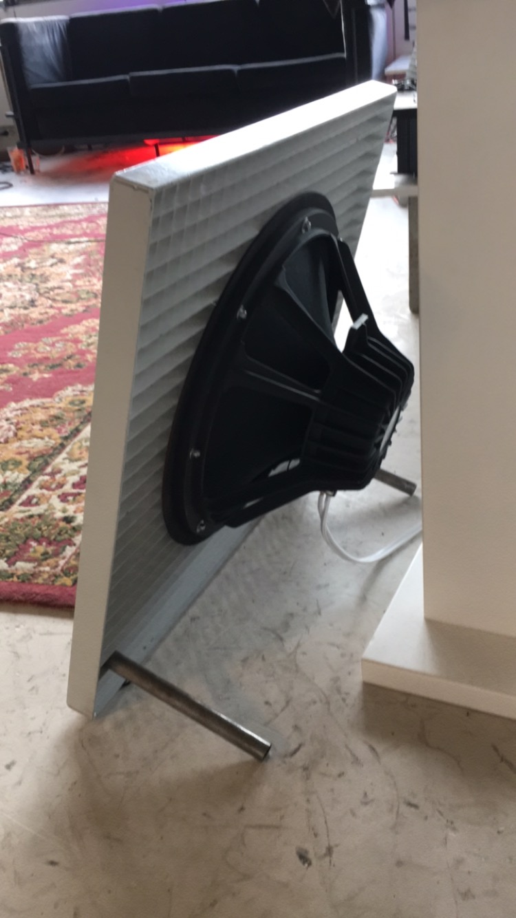

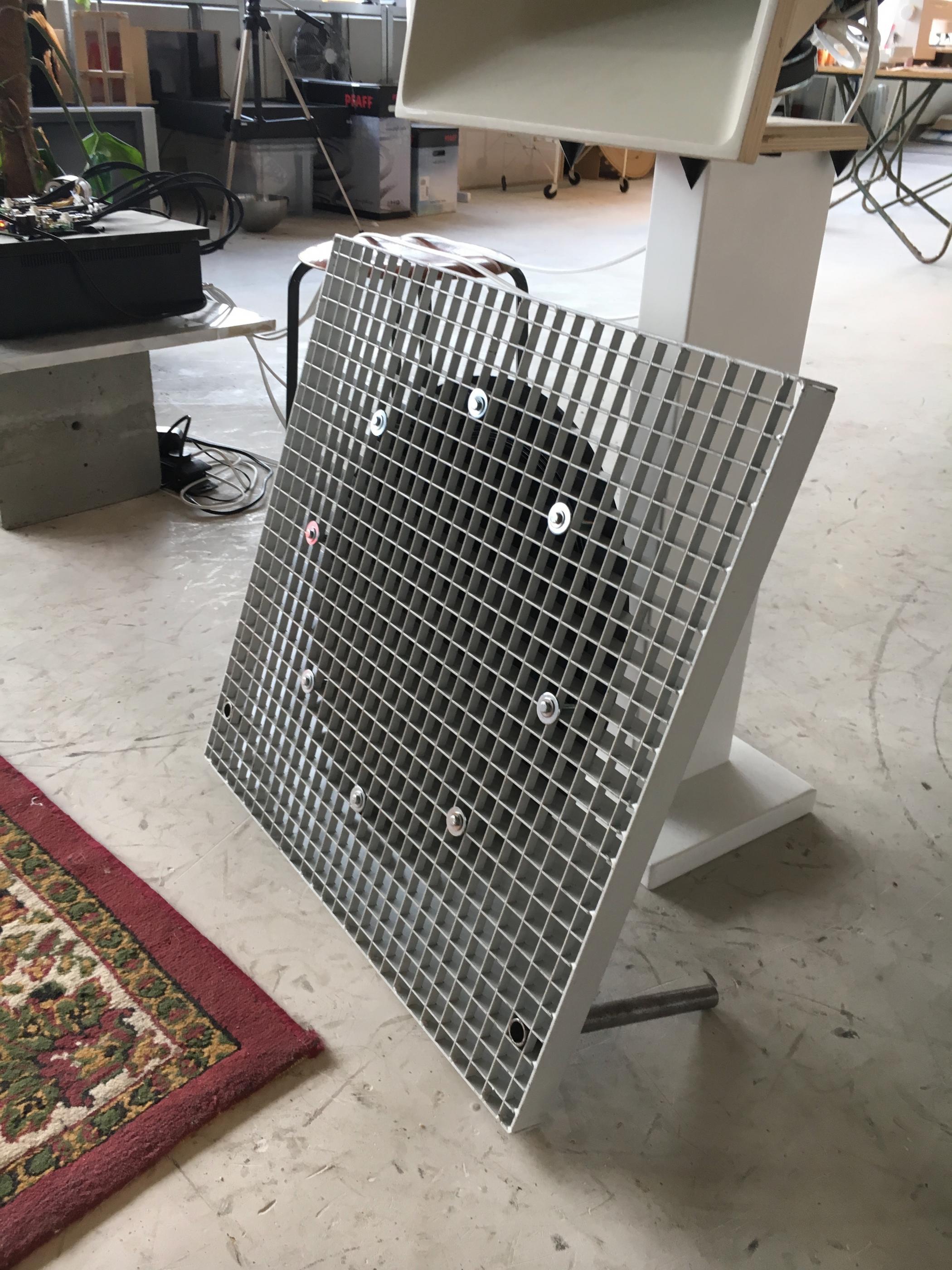

I recently build these for fun, but I think they sound better than my H-frames.
Driver is a faital pro 15pr400 mounted on a steel ventilation floor piece I found. It's pretty heavy and there is not a lot of resonance of the baffle. I lasercutted a spacer so the conus doesn't hit the steel.
I like the idea!
With a higher frame you can test different drivers without having to make a new baffle! You can also do diffraction experiments with square plugs (maybe 3d-printed) that fit into the square holes!
When you're happy with the sound, just pull a sock over it!

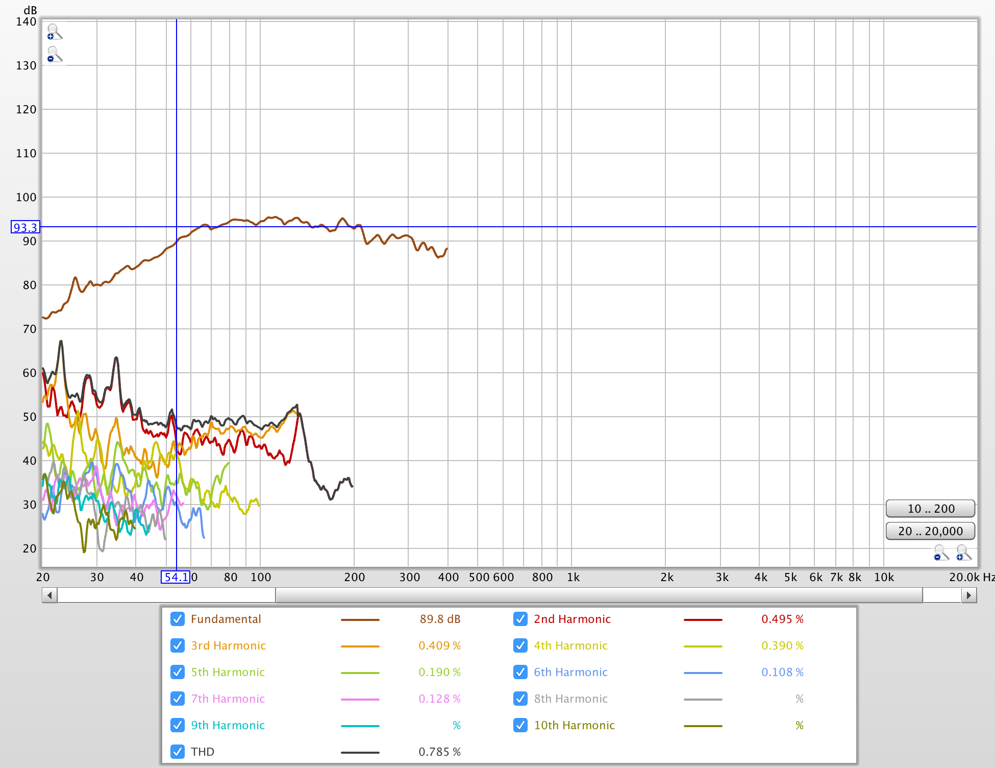

I also tried the Alpha 15. Also sound very good.
Weird thing I hear now when listening louder is a kind of bottoming out sound while I don't get the idea it is reaching x-max. Also could be the tin leads hitting de cone.
The distorion is also pretty low this way!
