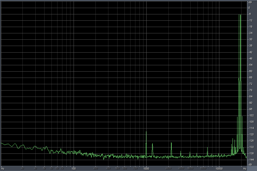

Demonstrating a single tone without noise modulation artifacts does not guarantee no noise modulation with a typical D-S DAC. What's the DAC chip used in your soundcard?

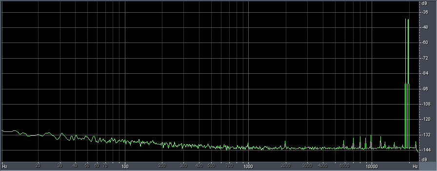

Here are two results with 19kHz + 20kHz signals. Full scale signal and then with -35dB applied in DAW:
My posted results are using E-MU 0404 USB soundcard. Output DAC is based on AK4396 and input ADC is based on AK5385A; Delta Sigma all the way.

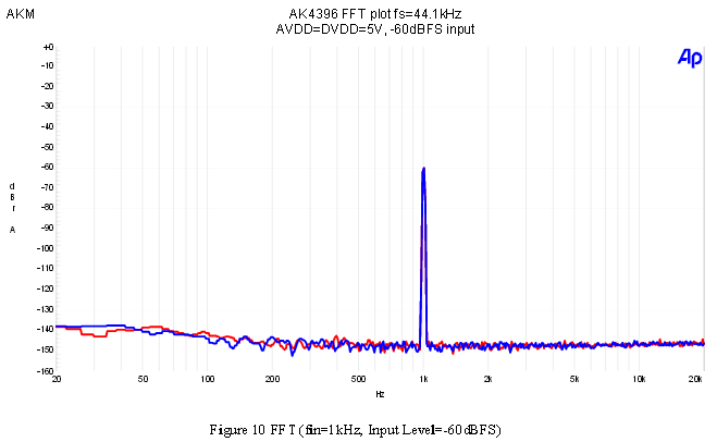

From what I recall AK4396 shows around 15dB noise floor modulation with full scale sinewave wrt -60dB stimulus. Not what I'd call transparent. When you've done your homework on FFTs you could put your new skill to work on the plots AK provide in the eval board notes : figs 9 & 10 pertain.

http://www.akm.com/akm/en/file/ev-board-manual/AK4396VF.pdf, p13 fig10:

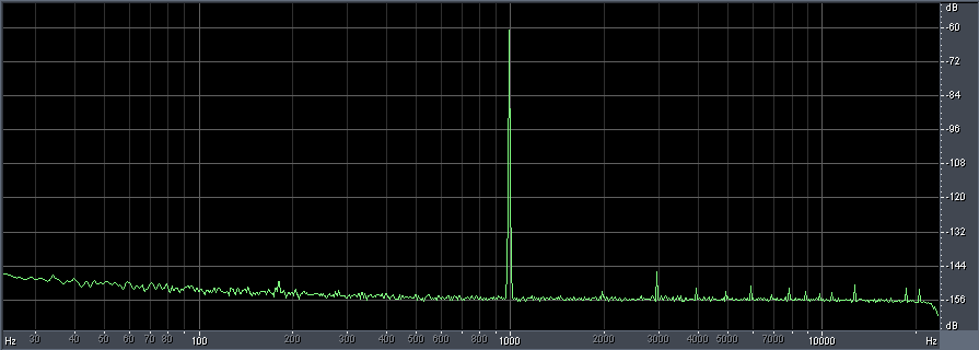

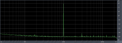

Here is my result:
The above is captured by adjusting volume of output and gain of input between DAC and ADC, making better use of 24bits. Based on AKM plots with AP gear, the AP gear isn't all that special.

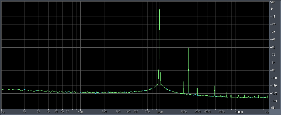

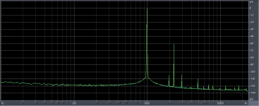

Here is 1kHz at 0dBFS with 2.333kHz at -60dBFS:
Vast majority can not pick out secondary signal with ears, let alone the really small signals and noise.

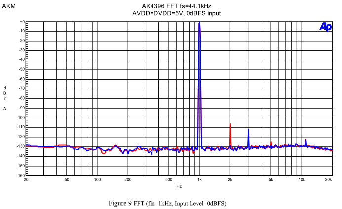

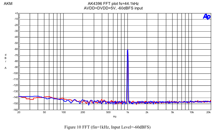

I referred to figs 9 and 10 from the evaluation board document for AK43966. I've reproduced them here - compare noise 'floors' between them.
What of thee noise floors? Essentially they show large v small signal behavior. How do they compare to other circuits; and what are audible differences?
