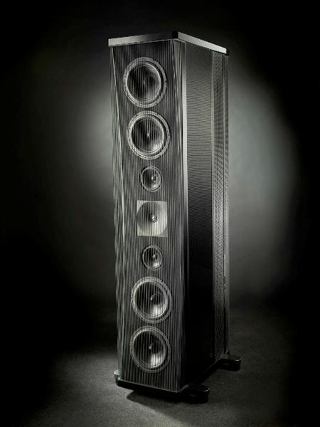

I'd just like to mention that I build something like this for myself last year... 4-way active, digital linear-phase x-over (computer software solution). They are big, but dont need a big room. I listen to them at 2 meter distance only.
Drivers are:
2x Beyma 18P1200nd
2x Seas W22EX001
2x Seas W15CH001
1x Mundorf AMT2340
Oh... and here's a picture:
Drivers are:
2x Beyma 18P1200nd
2x Seas W22EX001
2x Seas W15CH001
1x Mundorf AMT2340
That looks great, very similar to what I have as my vision for my upcoming build, except JBL2225, 2123 and BMS 4590/2+oblate speriod flare. TH subs below 60Hz. Still sketching and modelling before I get into my mate's workshop to build them.

Dear All,
first I want to build this loudspeaker:
http://www.rockporttechnologies.com/ arrakis.
I have acess to the driver and the crossover.
My problem is do not find anybody which is able to design and build this cabinet. (HDF and Hewaphon).
Maybe anybody knows somebody in Germany?
Josef

Alright, don't take it the wrong way, but come on: "...the Arakis transcends the boundaries of believability."
But it looks doable, aside from the half-ton swoopy carbon fiber and billet (guessing?) cabinet. I suggest building it in MDF (and concrete) first, and then improving on it later if you still like it.
Mind you, Shin had to convert his amazing design from 3way into a 3.5way coupling out one midrange doing midbass only...Shin solved it in his own way, but a minor detail that need to be solved before copying
This is not as straightforward as it may look

I have a nodisclosure with the builder of the Line Array. So I cannot tell you which driver we use but it is a driver very close to lowther but from germany...
My first idea was to build the Arrakis. But with the problems of the cabinet I change to the Line Array which is much easier to build.
If I found anybody which can build the cabinet of the Arrakis (in MDF/HDF and Hewaphon inside) perfect but the solution from StogErik looks very nice.

I thought money was no object. Cabinets for Arracis could be building by any experienced cabinetmaker. CNC capability would make it a 1 weeks job. 3 days to draw and program, and 2 days to cut parts. Arracis is sold for $34000, meaning the manufacturer gets at list $15000 per pair, Meaning each speaker has a budget of $3500 or less to produce it. Can’t do it without CNC on the commercial bases.
