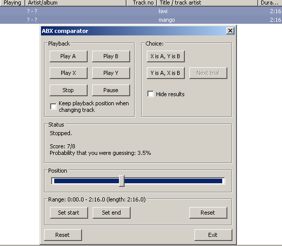

Wow!! kiwimango test?
Thanks. Listening on the Acer laptop and Sony MDR-V7 headphones.
Files are misaligned by 183 samples; mango starts later.
Not sure what intended tweak was; dither? Spectra are virtually identical; gains match to 0.05dB.
ABX transition is like small fast rewind/ fast forward. Slight delay becomes discernible. For me positive trigger was switching from kiwi to mango.
removing 183 samples from mango reduced me to guessing status with ABX.
Yes, it makes 0.0038 s time difference.

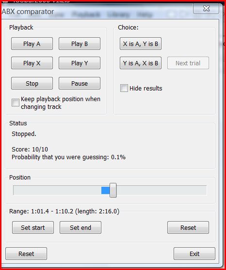

No one else here had used Multi Track to catch the 3.8ms shift, which I was unaware off. The only positive ABX result here, except of yours, was sent by Mooly, before you. In a PM he had described to me in detail which part of music he concentrated on and found the audible difference. I tried the same part as well and got 5/6 success.

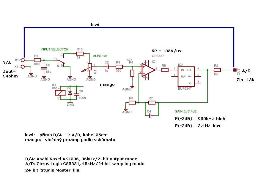

BTW, attached is the test schematic.
Thanks So, another attenuate/amplify configuration.
All these tests seem remarkable in that we can pick such slight audible differences out. I take it the square wave performance is exemplary on the active side... course it is, silly question If you were listening via speakers and without the luxury of the ABX comparator I would say that the differences would go unnoticed. The real and big sonic differences seem to come with the power amp stages and the amp/speaker interface.
These are very interesting tests though.
Mooly, you are the one to be awarded. There were no positive ABX results before yours. Only after you told me where you ABX - ed the difference, I was able to repeat it and received 5/6 score. I gave the same test on our local forum. Again, no one was able to get positive result. Then I gave them a hint and it resulted in only 2 positive results! So, this test has been pretty difficult.
On the other hand, I have received 11 positive ABX results from the 16bit x 24bit test, much more than I have expected.
