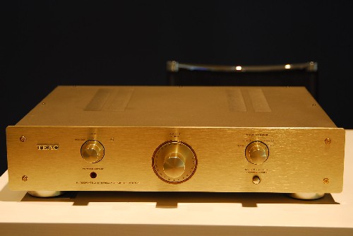

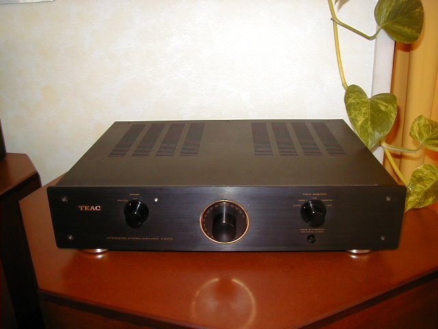

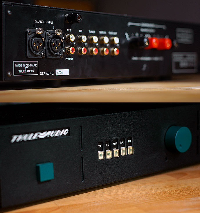

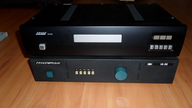

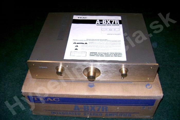

Teac Made in Denmark by Anders Thule

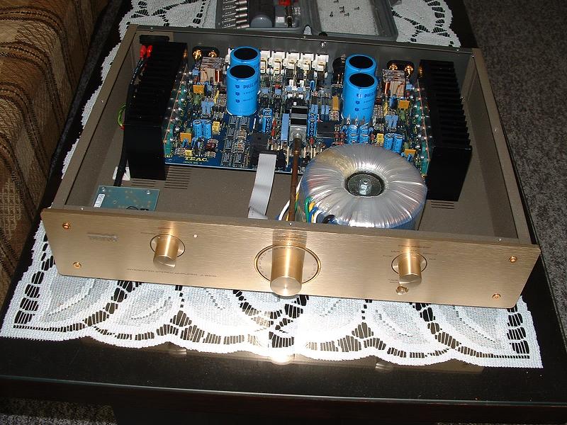

Anders Thule from Thule Audio not only developed for Teac. He even produced for Teac at least the model "ABX-10" from previous post and the A-BX7R (ABX-7R, see pdf attachement)
The A-BX10 ii seems to be close by Thule's model IA-100 (the predecessor of the IA-100 from the "Spirit"-line); and the ABX7R? this I don't know (perhaps the unbalanced and unbridged version of IA-50). Thus I can also offer service for this models and all the other Teac's stereo devices, where Thule Audio components are inside.
  • Thule Teac A-BX7R open + front (IA50).pdf
