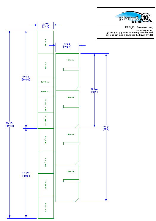

Thanks for your reply. I intend to make some uFonken speakers, so the smallest amount possible really.
I'm ideally looking for a suggestion for a shop (on-line or otherwise) from where I can get this stuff from *whenever* if you get my drift. But I am not adverse to asking you for some. How wide is your roll so I can get an idea of what I can ask you for. Off the top of my head I'd guess I'd need 1 Meter sq....

For a uFonken you need a strip 72mm wide x 852mm long and another 105mm x 674mm (this is using the 15mm cotton/denim felt we are now using).
dave
