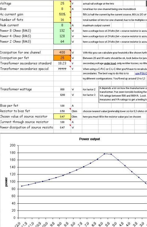

Hi Kram well i am working on 16 mosfets per side and I hope to get the bias to approx 8A.....see enclosed diagram....therefore min 32 req. to give 100w performance
I am ordering 50 just in case + I will have enough to do a mini Aleph for rear channels.
Check out.......the thread with latest calcs.....using excel.....I have enclosed ...... a view......

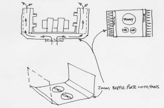

Just a thought, I am thinking about using forced air ducting.....to
increase the airflow through the heatsink fins.........do you recon that would improve cooling effeciency dramatically.
My plan is to use 2 120mm computer fans at low speed and create a light airflow over both sinks....have you any thoughts/ideas?????

I would sujest getting yourself some of the fanse first and run them whilst you are listening to your curent setup to see if you can cope with the extra noise (at the moment, I normaly have my PC on all the time in my room here at university, and once the music gets past very quiet it becomes very dificult to hear the fans in opperation, and I have six 80mm fans - all be it very quiet ones - in there).

BP thanks great thread.............I have experimented with std pc fans and simply installing a pot in the supply allows you to slow down the fan & still get say 25% airflow but then the fan is almost silent.
What I am unsure of ...is ...the ammount of cooling that will be provided by forced moving air.....over the heatsink fins.....
by my gut feelings ...it should be alot more efficient.......what do you think???
I am also thinking of installing a temp sensor that can increase fan speed if overheating occurs.........

I guess it is quite hard to say exatcly how much extra cooling you will get by adding the fans, however I recal some people have reported anyhting from a doubling in capacity up to fife or six times the efficiency (which I guess must be believable, as the heatsink on my CPU can dissipate about 80W of heat from the tiny chip die, with only a ~20 degree rise in temp, and that measures only 80 X 80 X 30mm).
As far as the fan controler goes, because this will be on a class a amp, the sinks should stay roughly the same temperature all of the time. So, the only benifit of this circuit would be for when the temperature you your room changes, or during start up, as for the the rest of the time notthing should be changing. So, you may be just as well off using a manual control that you can turn up a bit when it gets warm in the summer and back of in the colder winter months (assuming your room tepmerature will actualy change much at all with your heating and things being taken into account).
Actualy, I just went back to conrad to have a look at their forced cooling heatsink (the MF18), and it looks like you could use one or two of these to create a very compact chassis still giving very good cooling.
For example, if you took the 151.1 section with a thermal resistance of 0.46 deg/W in free air. This drops right down to 0.11deg/W with a 27cfm forced air stream, whihch would be about average if you tunneled all of the air from one of the 92mm fans from the above link running at 7V over it. So, if you put two of these sinks in your chasis, allong with two of the fans runing at 7V, you would have a combined thermal resistance of about 0.06deg/W, which should be more than enought to cool one chanel of your proposed specifications.
