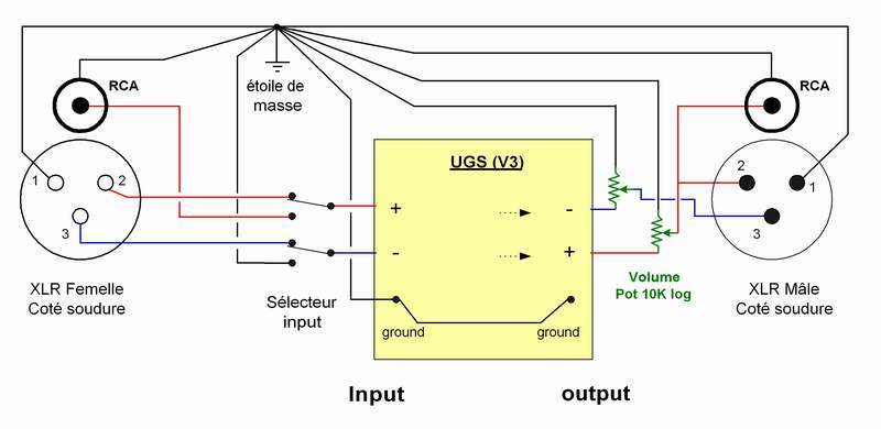

Maybe this could help.
Thanks to the (French) author
I disagree with the schematic.

Sorry for that wayne325, I've posted what I've on hand about UGS project.
You're certainly right for the wiring, secutity first.
The schematic doesn't show if the RCA are isolated or not.
The question was : where stays the pot and which value to use.
UGS is a preamp, not an amp.
