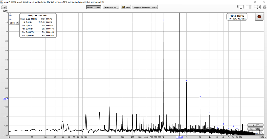

Another brief update for those interested in understanding circuit development.
As already mentioned, the proto according to Post #1 has the right distortion spectrum but some 12dB too high in level.
Measurements and analyses were done to identify where the lack of NFB came from.
And a series of experiments were carried out to identify recovery means.
We have now a solution for the front end that allows us to recover 6dB H2 without changing the ratio of H2:H3 (in Spice).
Verifications by measurements are currently limited by the Alpha Tester's equipment (0.012% H3).
So he needs to improve that by another 10~20dB first before we can go further.
Will take quite some time. But we know pretty sure how to get to 0.035% and 0.035%, as in the J2 measured by Stereophile.
Patrick

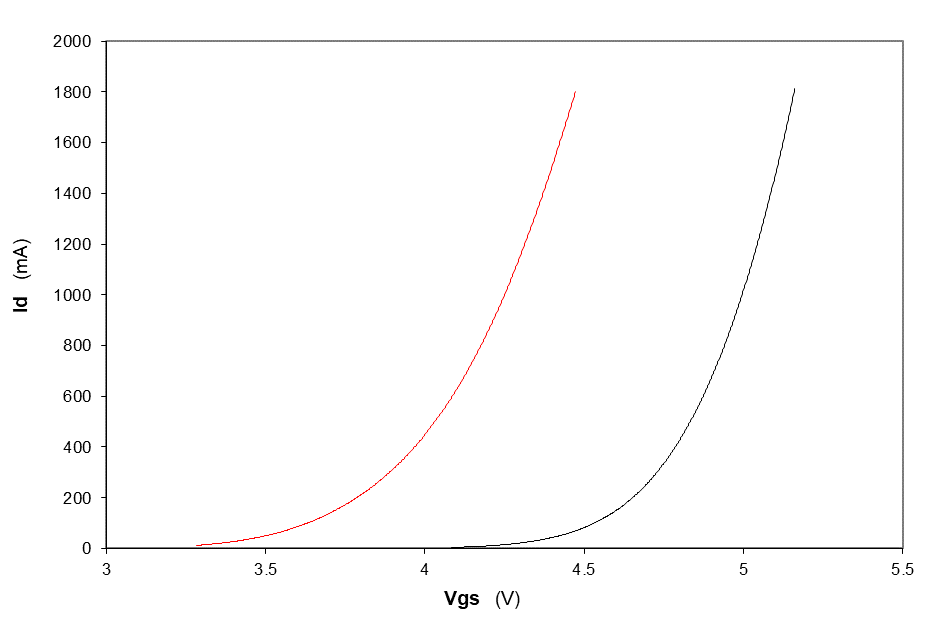

Patrick,
Would you consider trying a version using dual LSK170B? Those seem to be available, even though in limited quantities.
LSK170B-TO-92 | LINEAR SYSTEMS | NAC Semi

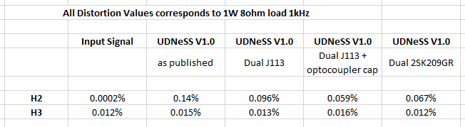

After playing with lots of circuit variations, we managed to get H2 under 0.03%, but not yet H3 to 0.003% while retaining good stability.
Still some more variations to investigate, including alternative power devices.
Once the picture is complete, we can then recommendations, depending on your objectives.
Patrick

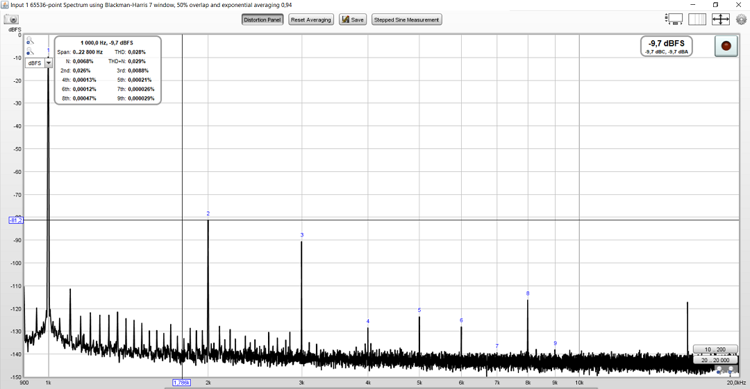

In case you wonder why there is no news, it is because the post is on strike (until December) !!!!!!!!!!!!
Postal workers extend strike until December | Yle Uutiset | yle.fi
As a result, the 2x FQA9P25 that the Alpha tester ordered for test is not arriving any time soon.
We test what we can without those.
For example, raising rail voltage from 21V to 24V brings another 2.7dB on H2 and 4.5dB on H3.
The best we have till now is 0.022% H2 and 0.005% H3.
In the meantime, patience is called for.
Patrick

Again, the mission here is to develope a circuit that can built using readily and widely available FETs,
while at the same time resembles a similar distortion spectrum as a single ended Class A amplifier,
such as the FW J2.
This mission is, apart from a few more tests, essentially accomplished.
Patrick
