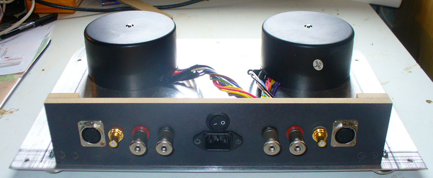

The case for the new amp was made by a colleague and friend, Thomas, who is a very skilled designer, but also handyman.
The bottomplate is a alu plate in 4mm, the back panel MDF in various thicknesses, and painted in black.
All coonectors are screwed on the wood panel: Neutrick XLR connectors, some Teflon insulated goldplated RCA sockets, WBT connectors for the speaker output.

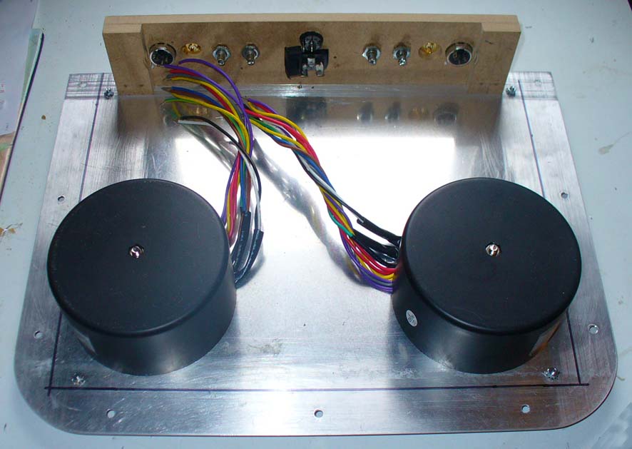

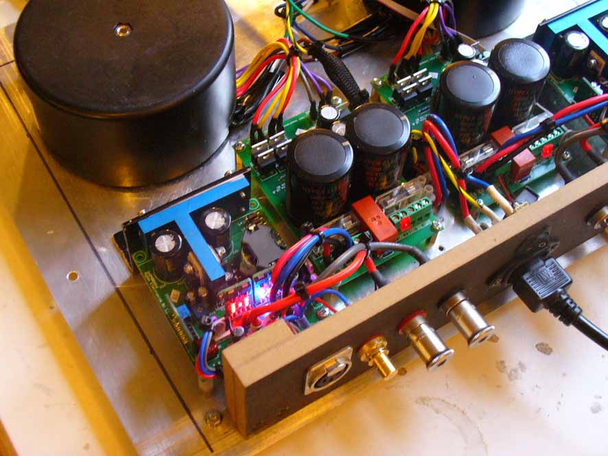

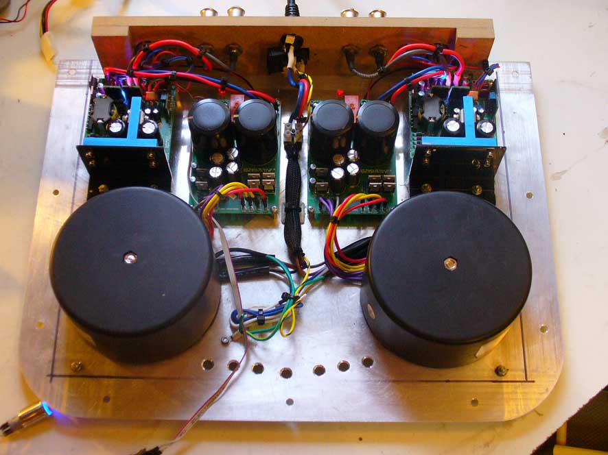

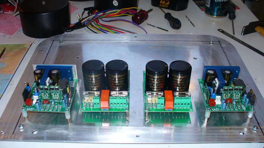

Here all components are mounted and wired. The flat wire which is going out to the front is the to connect the Mute switch, which is a circular blue Led type. You can see it on the left rounded corner; it's actually on. I put a connector, because this switch will be in the front panel (see some pics later).

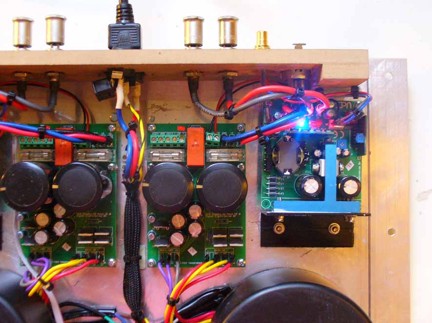

A detail of the modules: the UcD power amps are mounted with an alu corner, actuall not very thick (2.4mm) - I'll see if it's enough to tranfer the heat to the bottom alu plate, which should be enough to dissioate the calories (I'm not using the amp for partying...).
Wiring is very short, high quality speaker cable, and teflon insulated, silverplated single wires for the input, w/o shielding.
nother view of the mounting and wiring. I didn't used the provided faston connectors, everything has been soldered with 4% silver solder; all wires ahev heatshrink tubes to make it look pretty neat.
Observe the red SMD Leds on the regulators, together with the blue Led on the UcD board - kind of weird color combination, but looks interesting. I might make some holes in the top plate in that area, if the amp heats up, and will make the lights easily being seen from outside.

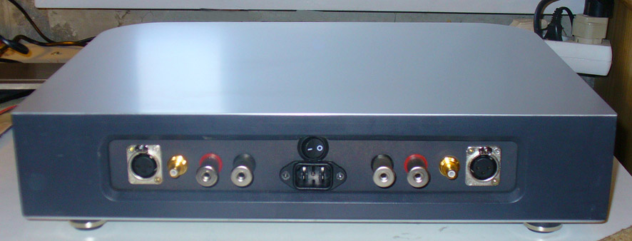

Now the cover is on, and the back looks clean and simple - no need to writ who is who.
As explained, the main switch is the one in the back (since I leave the amp on constantly, except when I'm on holidays or so).
The UcD modules have a mute function, which is been done by the front switch.

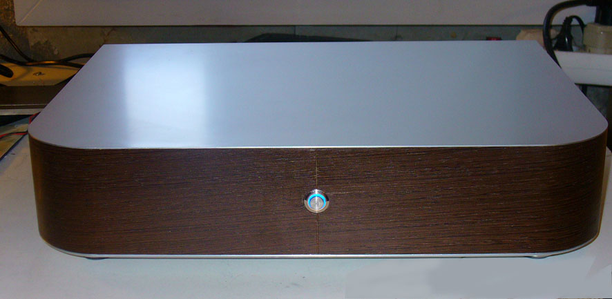

Front view of the amp: it's again wood (MDF), rounded and with a real Wenge wood veneer. Top plate is an anodised alu plate. It's simple and very classy.
The switch is off here. Actually it's broken... it was an on/off switch, but my iron heatd it probably up too much, now it doesn't work anymore. It became a pushbutton. I have to change it (see if my supplier will replace it, for 8 € each he can do this!!)

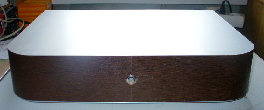

this is the same pic, but the LED in the switch powered - it needs 24 volts! Which I'm taking from the additional +/-12V supply on the Hypex HG mone PSU.
Some parts, such as the feets, connectors, and the circular LED switch came from Audiophonics.fr, who also can provide the Hypex modules. They have nice cases too, but not as mine!

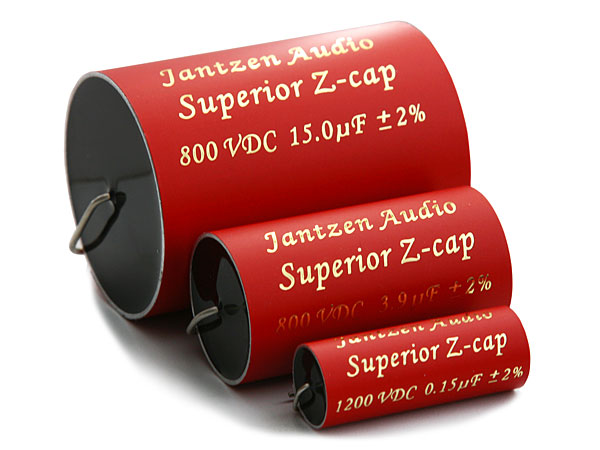

If the combi Panasonic / Roederstein isn't enough, I replace them with Jantzen Audio Superior Z (or even Silver Z) caps, one of the finest caps on the planet. Beat even the so praised silver/ gold stuff from Mundorf.
Since I mounted the modules in a way that some caps may be mounted from below, even 0.68µF will fit easily.
