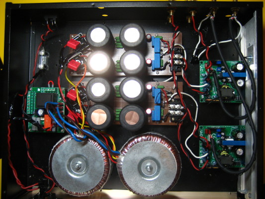

Grounding clarifications - UCD400hg
Just finished up my UCD400hg today. Slight hiss on my speakers - audible only when i put my ears about 3 inches from the woofer. Any idea what's the problem?
Currently, I am not using the hypex grounding scheme as I am not very clear on the overall schema - I am basically using a star ground to the chassis, and using a ground uplift (2 ohm) connected to the mains earth. This it with RCA inputs
Now, I am thinking of redoing it according to the hypex scheme, and would like some confirmation on my understanding. According to the documentation, and my interpretation of the circuit diagrams, I need to:

Re: Grounding clarifications - UCD400hg
Fixed the problem. Left both power and supply ground floating. Dead silence. I am very happy with my setup now. Still running it in, but I am getting great detail, very very good treble and my bass is coming back.... Extremely happy with it. Only problem is that it gets a bit hot in the enclosed space where I put my amp - I need to figure that out. the heat sinking is pretty minimal at the moment, just a sheet of aluminium added to the inside of the chassis. Here are the pics:

transformer noise
Hello All,
I recently built an amp with TR501/SupplyHG/UCD400HG.HxR. Soundwise, I'm very satisfied.
However, when finishing the chassis, I noticed, that the transformers are making some generating hum. This was not really disturbing when the chassis cover is removed, but I guess this is amplified if the cover is in place.
Although I do not feel vibration if touching the transformers, it definitely seems that they're making the noise.
I checked for DC on power the line, but the multimeter did not show anything.
Any hints solving this problem?

Re: transformer noise
This will sound odd, but put a cloth on the chassis cover then a couple of heavy items such as bricks. If the noise is reduced, it's likely the chassis, especially if it's magnetic material like steel, could be reacting to the field around the transformer.
Something like this might help:
http://www.partsexpress.com/pe/showdetl.cfm?&Partnumber=268-010
You don't have to get this all the way from the States, as car audio places in Europe are very likely to carry something of the sort.

Re: Re: transformer noise
Thanks for the help! It's a standard 19" rack chassis, front and back plate is alu, the rest is steel.
I experimented a bit trying to push each side with my hands, it makes a small improvement, but still far from the open top version.
It's quite interesting, because otherwise the chassis is much more rigid with the cover on.
I'll play with it, but probably it's time to build a chassis using those 4mm thick alu sheets I have in the workshop (I wanted to avoid that, that's why I bough the rack).
