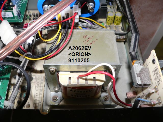

A small question on the side...
Included is a photo of a part of the Akai AM55 - For the moment I'm using its transformer to feed 2 UcD400's as my audio budget is recovering
This part has a power switch, and some more parts. On top the mains comes in, the plugged wires go straight to the transformer primary.
I believe (a) is a kind of thermistor or am I wrong?
what are (b)? Are these resistors to do some kind of current limiting or is it something else? Is this "bad" ?
R on the (b) parts is 0.3 ohms
(a) did have some indications on it, but it became unreadable, sorry.
On the "output", voltage is identical to mains input, 230V AC
Thanks for the info,
Yves
Yves
Yves,
A) A capacitor, used as a spark supressor for the mains switch.
B) Coils used as a mains filtering to avoid switch noises.
Leave these parts as-is, as they're there for a good reason, which is spark and noise supression from the switch.
Best regards,
Sander Sassen
http://www.hardwareanalysis.com
Best regards,
Sander Sassen
OK thanks,
Can't thank you guys enough, I'm learning at geometrical rates here
This is a fun way to learn things, from practical things to theoretical instead of the other way around...
Does anyone have references on this transformer?
I'm afraid it's a custom job...
Secondary voltages are perfect for UcD's. I'm getting 55V DC on the caps.
Is it possible to "eyeball" the VA rating based on the size of this thing?
On the backplate of the Akai "220V 650W" is mentioned - but there are other secondaries on the transformer for the "pre" part of the integrated amp.
