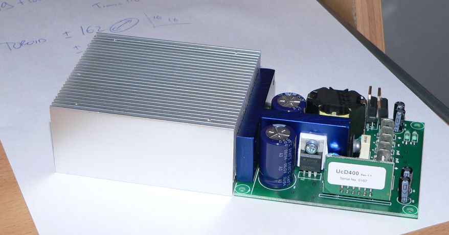

Is this enough cooling for 2 Ucd400's? It's an old alu heatsink for Pentium IV.
Would it work if I mount the Ucd400's on the side of the fins like in the picture, or would the "massive" side be better?
I've read to mount the modules vertical with the T shape towards the floor, but how can you gain anything from a heatsink this way?
Thanks for the help...

There is some very exact notes from Bruno I think on heat sink sizes somewhere in this or the 180 thread.
However, that heatsink looks way more than needed, but you would have to make sure heat transfer from one to the other was adequate.
Personally I have mine screwed to the sides of one of those audiokit2000 case wall and the alu wall barely gets warm to the touch.
In contrast I have an almost identical amp using a pair of Zappulse 2.2SE board and the side of the amp is quite hot to the touch...
Basically screw the heatsink to a lump of alu about the size of an A5 sheet and it should be plenty. Sides of the case or the bottom of the case (if it's alu) should be more than enough.
The only thing which gets hot on mine is the output coil and so you should mount the board so there is some airflow around that bit of the board, ie make sure there are air holes above and below the board.
