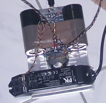

Use (e.g. 150W) electronic halogen lamp transformers, they work great with my ZAPs! As you can see in the pic I use quite big caps, as the smps doesn't rectify and filter the mains. So output of the SMPS is a 50Hz sine with 100kHz sine over it. You have to rewind the secondaries, which is not so hard (5 windings for 11.5V on my ones) as it sounds, or you're as lucky as I was and there are several windings in parallel which can be put in series.
BTW, those tinies drive a Scintilla (1 Ohm FR ribbon speaker) here!

I got my SMPS here: www.reichelt.de , art# EL-TRAFO 150VA
They ship internationally, but they are only available in 230V input.
Conversion:
Check if and if yes how many secondaries are put in parallel. If you have 4 or even 6 you're lucky. Otherwise you have to rewind them. In my SMPS was a cap from prim. to sec., unsolder it.
Use high speed rectifiers, use big elkos as the halogen SMPSs are built up as cheap as possible and use DCed (had another look on a spare board I have) but unfiltered mains.
When I changed from toroidals to those there was no big difference apart from the fact, that these transformers don't hum!
