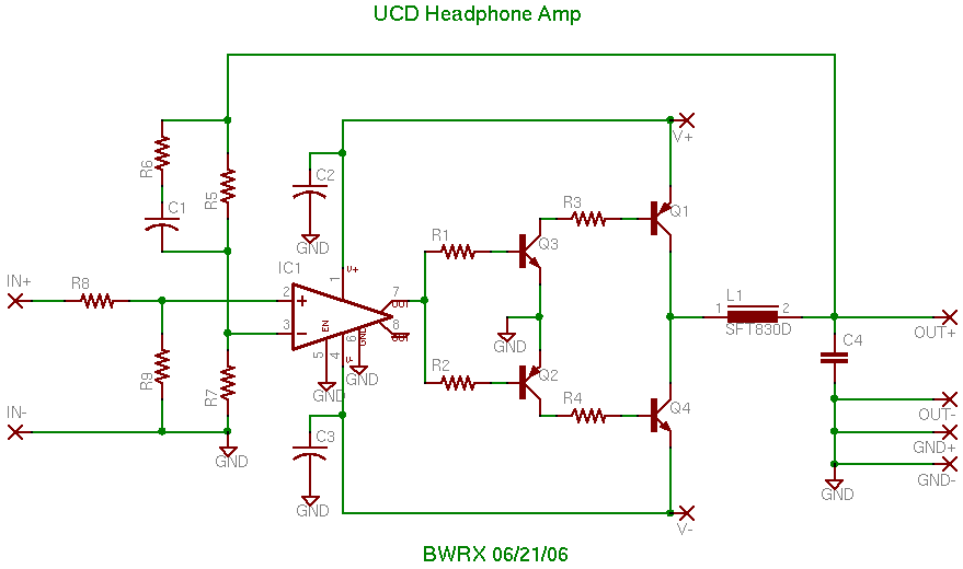

classd4sure said:
You don't need an op amp buffer at all, just drive the comparator directly.
You dont' need a 4'th order filter, just more junk to pollute the signal path. Keep it simple, keep it pure, keep it clean.. it'll pay off. That's alot of the magic behind the UCD in the first place, remember?
Like coupling caps, a buffer is something that we'd like to do without!
We may not need a 4th order filter, but if it were inside the feedback loop then it wouldn't pollute the signal path. I'll draw up my idea for the 4th order filter w/feedback and post it here to see what you guys think. For now, here's a schematic of what I had in mind. If anyone has suggestions for improvement, or suitable devices, please say so. I used the LT1016 part for the comparator because it readily available in eagle and would probably work ok with this design. Any other comparator could be used, and with the way the output stage is set up, it doesn't need to have high voltage supply capability. In fact, the comparator just needs to be able to work with split rails that could even go down to +/-2.5V as long as it can drive it's output close to the rails and sink and source a couple mA of current. You'd just need to change the base resistor values for R1 and R2. Furthermore, the +/-12V rails could easily be regulated down to the correct voltage levels for the comparator. That would also help reduce noise getting into the comparator through the supply.

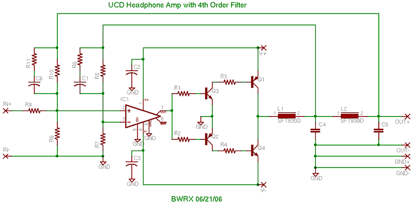

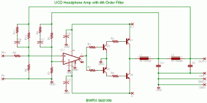

Ex-Moderator
Joined 2005
Here's the schematic with the 4th order filter implementation. I have no idea if this would actually work though.
The other interesting thing to note with this design is that the bipolar transistors could easily be replaced by FETs, which would lower the power dissipation in the base/gate resistors. Then again, the power dissipated in the resistors would depend upon the required base current which depends on the current gain of the transistors.

Administrator
Joined 2004
Hey Brian,
Looks nice and simple. I don't know enough about the UCD stuff to know how well it would work.
The 4th order filter will remove a lot of the switching carrier, that's good. The Super-T uses a 4th order (two 2nd order in series, actually) and there is very little RF on the outputs.
Don't forget that this filter will not do much to attenuate AF noise - and there will be LOTS of AF noise. Just connect a pair of headphones staight to a T-AMP if you want an example. (Beware your ears and the phones!!)

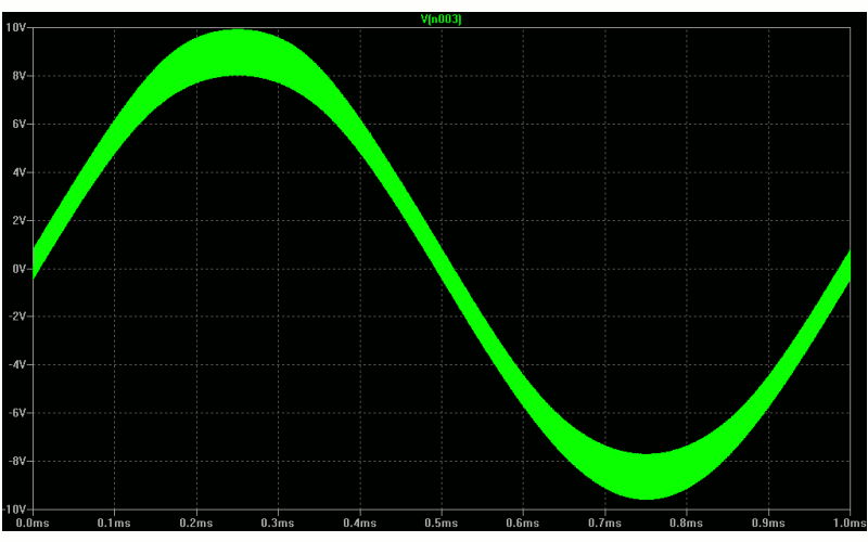

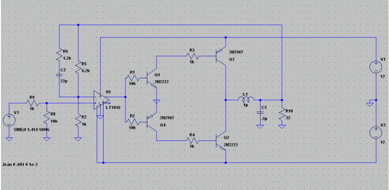

Ex-Moderator
Joined 2005

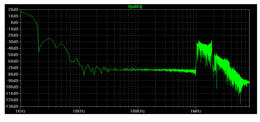

This is the FFT of the output waveform shown above.
Not bad for a very simple UCD implementation! The supply rails were 12V and the load was 32ohm. You can see that the switching frequency is right above 1MHz.
Ex-Moderator
Joined 2005
Actually, the switching frequency of the comparator output is closer to 3.5MHz according to SwCAD. Is there any way to obtain better resolution with the FFT plots? Any suggestions on better component values? I just kind of picked generic values and tweaked them until the amp actually worked.
There is a little bit of cross conduction that is happening so the design could obviously be improved (like we didn't already know that!).
