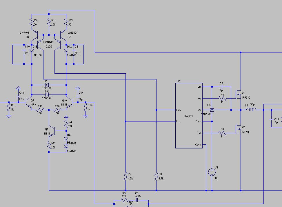

Hi Kartino,
He just wants to use the discrete comparator, or some version of it, with your typical half bridge IC driver.
The usual discrete comparator uses npn's for sinking current from a pnp current source/high side switch, so the level shifting required is in built as part of the driver.
The gate driver IC doesnt' have that, so by inverting the comparator you get the opposite effect, with a few trade offs in the input stage, probably not a very big deal.
The output stage will of course remain dual N - channels, and the IC driver can be made to work at higher voltages easier than the discrete ones can.
As he said, it'll save him additional supplies which is the main benefit to using this as opposed to your usual comparator, it's not a bad option.

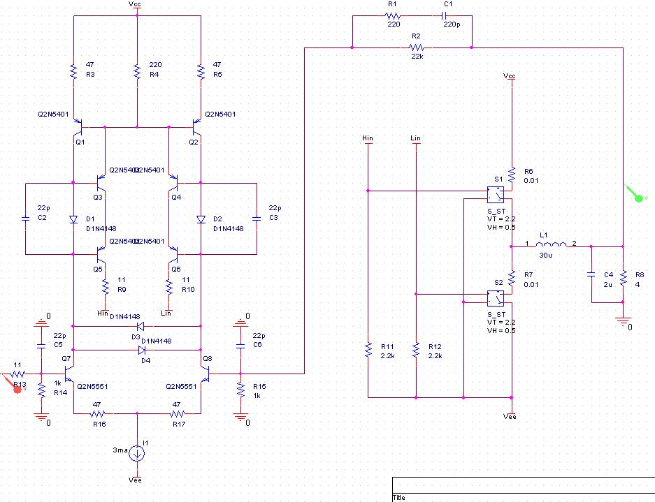

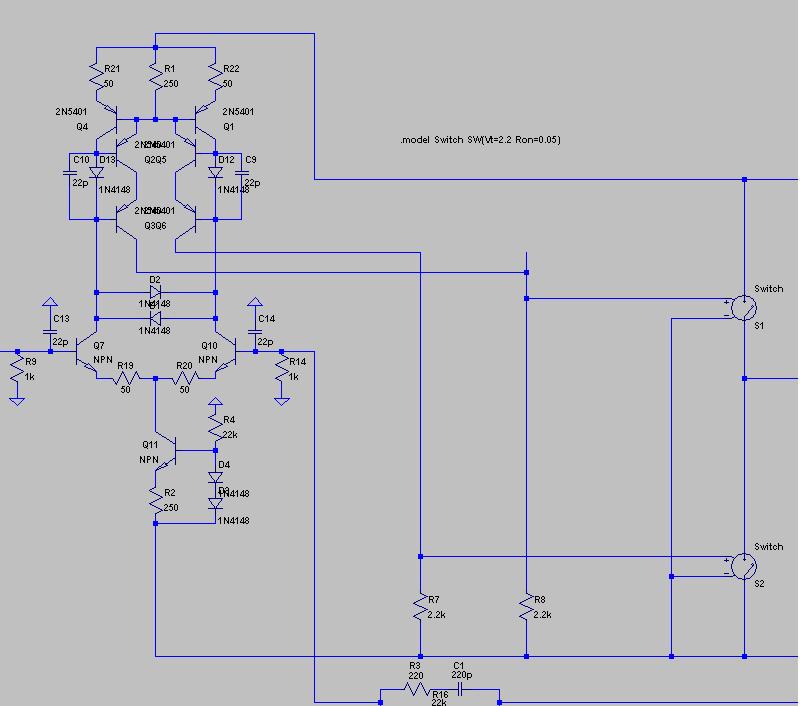

chris, you are correct, as usual.
question tho, on my last schematic where the comparator is inverted, what does those two diodes D12/D13 and Q3/Q6 do?
I took out Q3/Q6 and it worked as well. so why do you have them?

In this case you probably don't need them or the diodes.
The reason they're there is because with the disrete drivers there's more dv/dt for the high side than for the low side driver, since they each level shift to very different potentials, which can lead to a few problems.
So using a cascode transistor for the high side helped guard against the increased dissipation, using one for the low side keeps all things equal (delays), and the diodes are a minimal component count way of keeping the cascode transistor biased. You could use two or three or an LED as well, but I found one was fine.
In this case you're having them both switch to the same potential with the same dv/dt so it shouldn't be much of a problem as long as you have fast enough transistors for a nice clean and fast switch. At higher rail voltages they may be of some use again though.

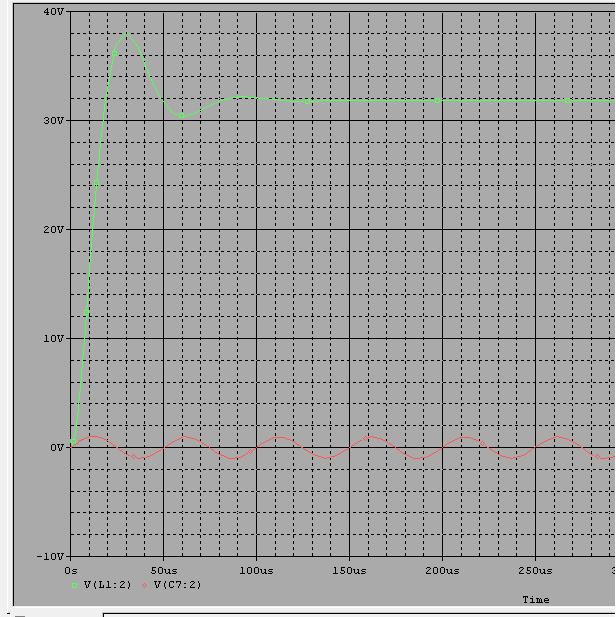

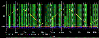

I threw together a sim in pspice based on this, with ideal voltage controlled switches. It's working extremely well and required nothing special.
One thing you may not be aware of is that the ideal switches can use some editing. In properties I changed Roff=1e10 instead of 1e6, Ron=.005 instead of 1, and there's two thresholds, I left Von=1 and changed Voff to 0.5 instead of 0.
I also took out the two casecoding transistors and shorted the two diodes. no impact I can see of. so I am going with the simpler schematic.
What this proves to me is that this concept seems to work. I will just need to work it out in the real world to see how true the simulation is.

Because your circuit similar to quasi, I think that you can not use same voltage VCC level for your driver and your high side FET. Your driver VCC shall over that FET VCC.
Beside that you still simulate with ideal switch. Try with mosfet symbol...
