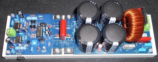

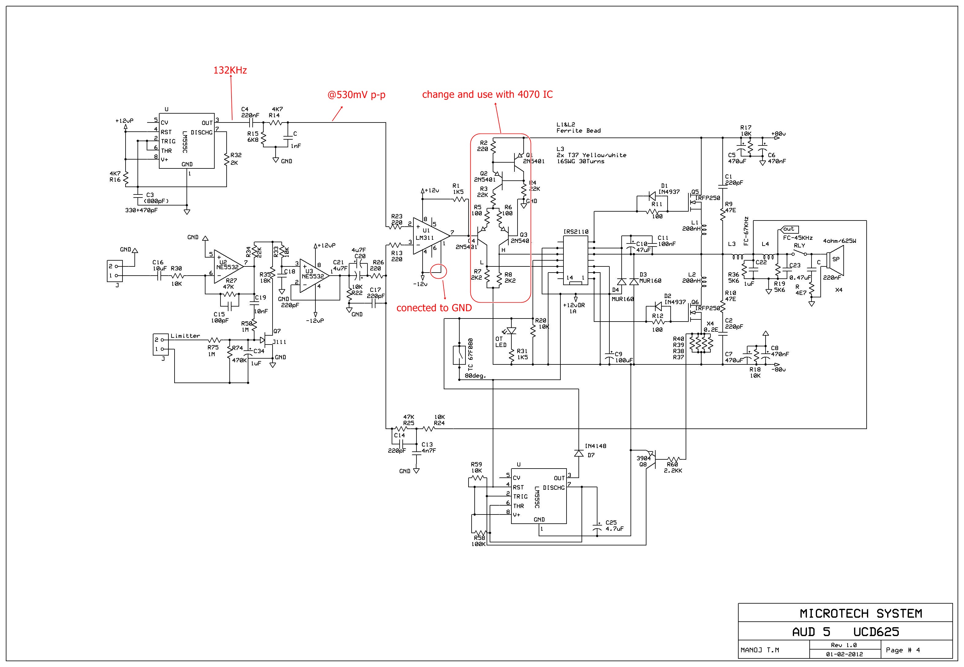

UCD 25 watts to 1200 watts using 2 mosfets
Hi all
attaching my old design again
RGDS
manoj

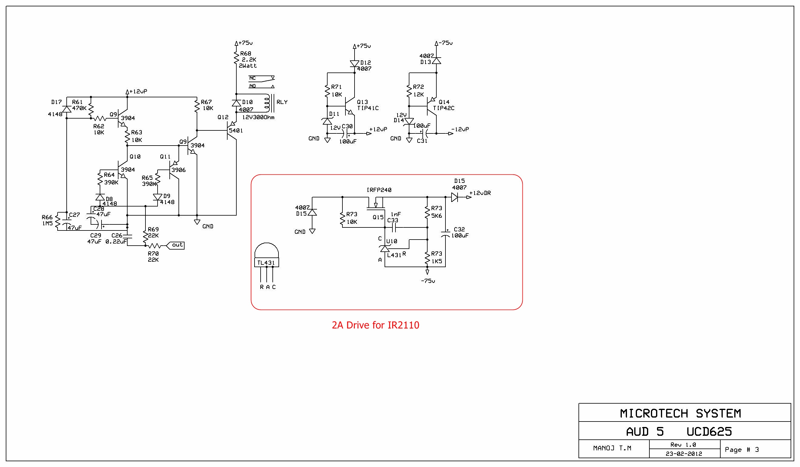

Hi Manojtm

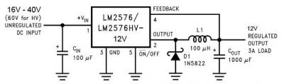

greetings can you give correct tl431 there are so many packages of tl431 which one are you using i also need 2 ampere 12 volts fo IR2110
trying to LM2576T but i cant get 100uh inductor so i try TL431
warm regards
andrew lebon
