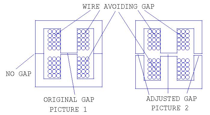

hi pafi and to all, i got an E ferrite core. which one on the picture should be used.
picture 1: original gap ang wires avoiding the gap
picture 2: both side of the E core adjusted to have a gap. how much gap?
regards,
coolet

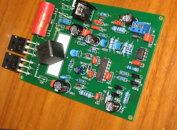

Excuse me
This is my production.
In the test output higher voltage > + - 15V Sine wave (20k hz)
Will appear MOSFET shut out of control.
I wonder what really have the person is tested
Whether it works in default 120K
Or a higher frequency
Why ?
What is problem in your opinion
Let me give some issues:
There is no supply decoupling, you must use ceramic caps as close to the fets as possible, and even elkos if you can. Bus pumping can really serius for this design, since power suply capacitors are really far, the trakcs are really thin. Even the RC snubbers has a long path, and if you look at, you can see, that the tracks form a ring, so pcb inductance is not neglectable, so they will be RLC snubbers as Eva mentioned before.
There is a really long way to the inductor (it functions as a radio antenna).
There are design priorities. The easy heatsinking of the FETs should not be the first, since the fets dissipate so little in a good design (for even few hundred watts output poeer), for testing they can even go without sink. Short driver to gate path is good, but there lots of other factors to involve.
Why ?
PCB looks like it was for AB amp, for D you need a lot better design, and trust me, I have done bad pcb for D, did work, but not really
PCB will have to NOT look like you just drawn schematic, traces like point to point connections. You will need ground planes, decoupling, short traces (as much as element wise possible),...
Pafi or Lorylaci
