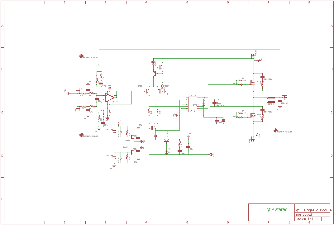

hi guyz about the 106-26 core i managed to add the 1mm gap with a hacksaw . my supply is +/- 70vlts the core gets hot but i've been playing it for like 7 hours .despite of the heat every thing is ok mosfets irfp260 are warm but my load is 4ohms and i'm using a very small heatsink .
but i've noted if i increase the gap to 3mm distortion and crackling in high frequency at high volume disappears ican't explain it scientifically but it works great here are my layout and schema

Why did you make a gap in a powder toroid?
Because it was told. :)
To decrease flux change rate, therefore decrease heat. And to achieve higher saturation current.
Dzony988 said:
P.S I read somewhere about T106-26, that it has 40+10 degrees with 12 turn of 1,85mm wire (15uH) and that's totaly normal
OK, but with what supply voltage? I guess much less than 40 V.

here is my plot but i have another which is stereo and uses droper resistor instead of transistors to power the lm311 .. pls note if you are going to use +/-70vlts change the small transistors regulating power of lm 311, from(2n5401,2n5551 ) to (bd140,bd139)respectively "remember to interchange their pins"and mount them on a small sink . not to forget also to interchange the lin and hin pins of ir2110 . "i was trying to drive the amp in an opposite phase in order to bridge it easily" ;), never got the time to change it but i,ve managed in my another board.

Hi Stewin:
Thanks for sharing the design! What is the maximum voltage can be applied and what will be output (Watt)?
Raj
Hi Stewin:
Raj[/QUOTE]
the voltage i,ve used is +/-70 but i replaced the regulating transistors of lm311 to bd 139&140 and mounted them on a small heatsink the outputs were irfp260 i am not sure of the wattage cause i am not a pro in calculations and i have no clue of how to use a scope . but from my ears point of view the amp is powerful and has lots of power to spare:p stewin
Im beginner for Class D and need more basic information....
cant find instruction guide for this amp
1. How much is the Dead time and how to set different DEAD TIME in this design ?
2. How to set DC Offset in this design ?
3. Is it possibile to drive 2 IRFP 250N Parallel ?
1. Dead-time is approx 30 nS in this design (20 nS from IR2110 + 10 from comparator+lvelshift). You can't change dead-time, but you can change "effective dead-time" by the R + diode network to the fets. Diodes discharge fets fast, and resistors charge them slow. If you increase resistor value you increase "effective dead-time"...
2. So far I had no issue of DC offset in this design. DC offset can be lowered by lowering circuit propagation delay, this can be achieved by other connection of LM311 (see before), and even by using faster comparator.
3. To drive 2 fets per side with one IR2110, you need to increase "effective dead-time", becouse discharge current per fets is divided by two and etc. This will lead you to decrease switching frequency, the minimum should be 200 kHz (otherwise there would be no sufficient filter from LC circuit, or by desigining LC rollof to lower freq, you get huge inductors and capacitors).
To ensure proper driving multiple fets, you should use IR2010, a totem-pole for each fet after IR2110, or use Zetex integrated drive boosters (cheap), or any other equivalent solution.
But if you want HIGH POWER, you should forget IRFP250N-s, use IRFB4227 or any other FET designed for high freq switching operation (IRFB4229, IRFB4228, IRFB4332, FDP2552, FDP2532 lots of them, they worth their price). If you want even HIGHER POWER, you sould multiple these high freq switching fets. (or pray...)

Thanks for your information
1. Ok I hope i dont have missunderstood.....
This means, FETs designed for high freq switching operation like IRFB4229, IRFB4228, IRFB4332, FDP2552, FDP2532.... I can paralleling two pcs. from this fets with IR2110 but without using totem-pole or Zetex drive boosters
otherwise IRFP 250N high freq switching fets can work too but its a bad solution
2. Zetex integrated drive boosters (cheap)
I dont know this devices which is the Model Number from zetex IC ?
3. To increase "effective dead-time" for paralleling 2 pcs. IRFP 250N or IRFB4332 which resistor value would you recommend ?
4. Do you know a good working Short Circuit and overcurrent protection for this amp ?

1) Propably you can parralel two low gate charge devices since 2x70nC<234nC (2pc IRFB42227, 1 pc IRFP260N), if you don't need full-audio-spectra ergo high switching spped. But one IRFB4227 worth about 2pc of IRFP260N, and about 4pc of IRFP250N (with about 1/10th of switching losses!)
2) they start with ZXGD300, lots of them, here they cost about half euro.
3) It depends even on you layout, so I can't give exact values. But you should calculate the time to charge a fet to its on threshold voltage, and to discharge a fet to it, then calculate some safety time, then the normal dead-time... It's complicated, the best is experiment: start the circuit with some power resistors (i use 47r 5W) in the main supply lines... It will protect the amp. If everything is ok, they should be cold, when the amp is operating. If they are hot, you should recalculate you values...
4) I haven't tried any of them yet. The IR application notes recommends checking fet on-voltages after the torn on (+short delay), this what they use in IRS2092, of course you can go that way. Or you can use a shunt (boring) and measure the voltage on it, like on Tripath modules. A protection circuit should connect SD pin to high value, then IR2110 stops.
First you should build a small power one. Two IRFB4227 can get really high power, with extremely low losses. So think about parraleling them later! With my second prototype I turned my dummy-load to water-boiler and out the water I made them glow red. (I measured 200W before clipping to 8 Ohm, from 2x63V supplies, but I'm sure it can go much higher) And the FETs with their small sink even could go to an OldSp*ce advertisement.
