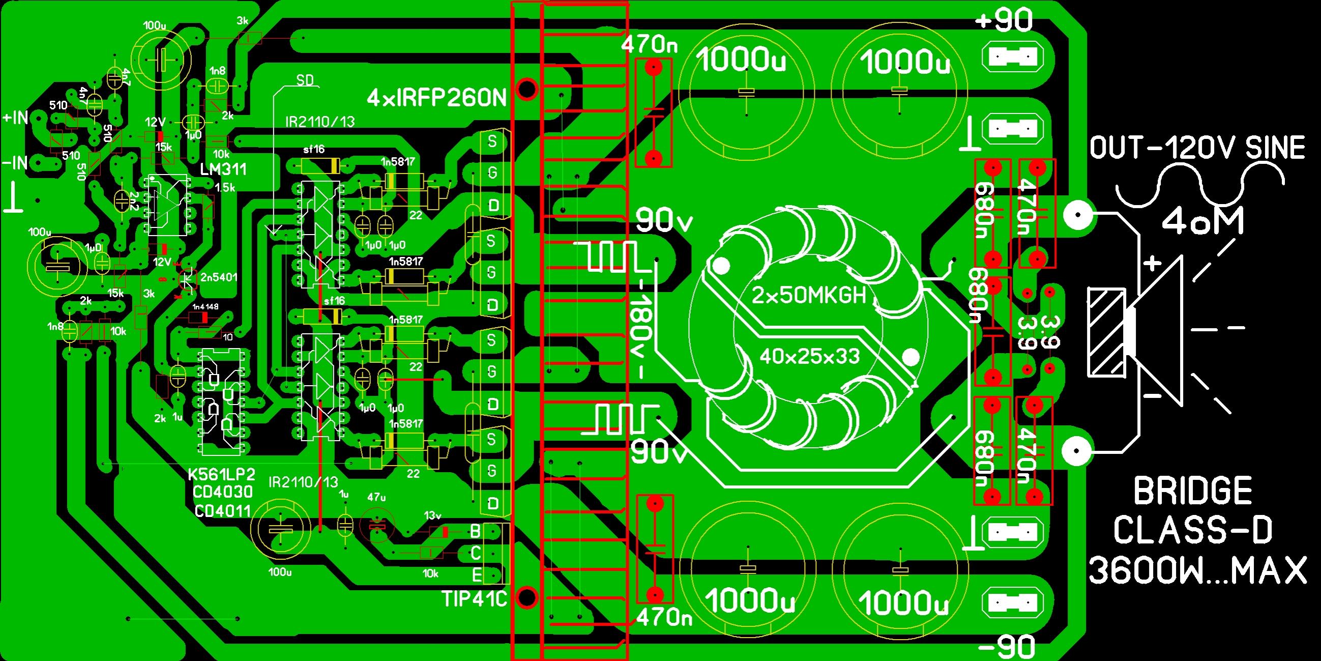

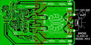

Found the pcb based from the attached schematic..hope it will work. Feel free to comment

hello....i've tried this amp and it work perfectly at +/-30V but at +/-80 the IR2110 has been killed....my questiom is....what kind of protection should i put...thank for reply and sorry for my
english
which output fets did you use and what was your switching fequency??
english
also remove the 12volts zeener diode between vb and vs pins of ir2110 ,if there is any zeener diodes connected

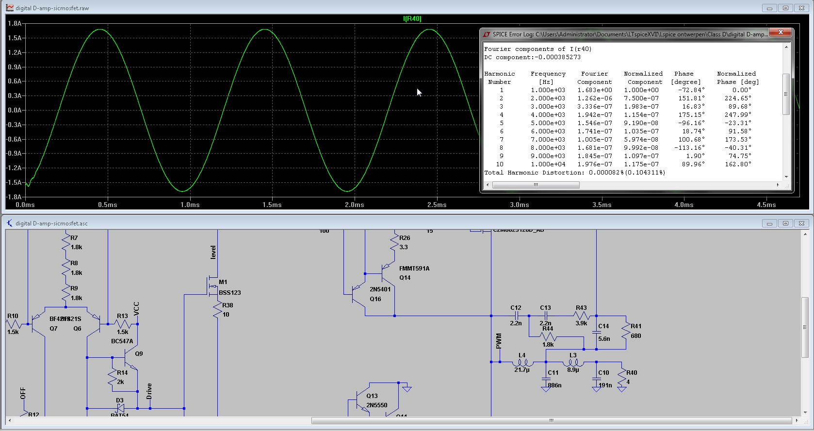

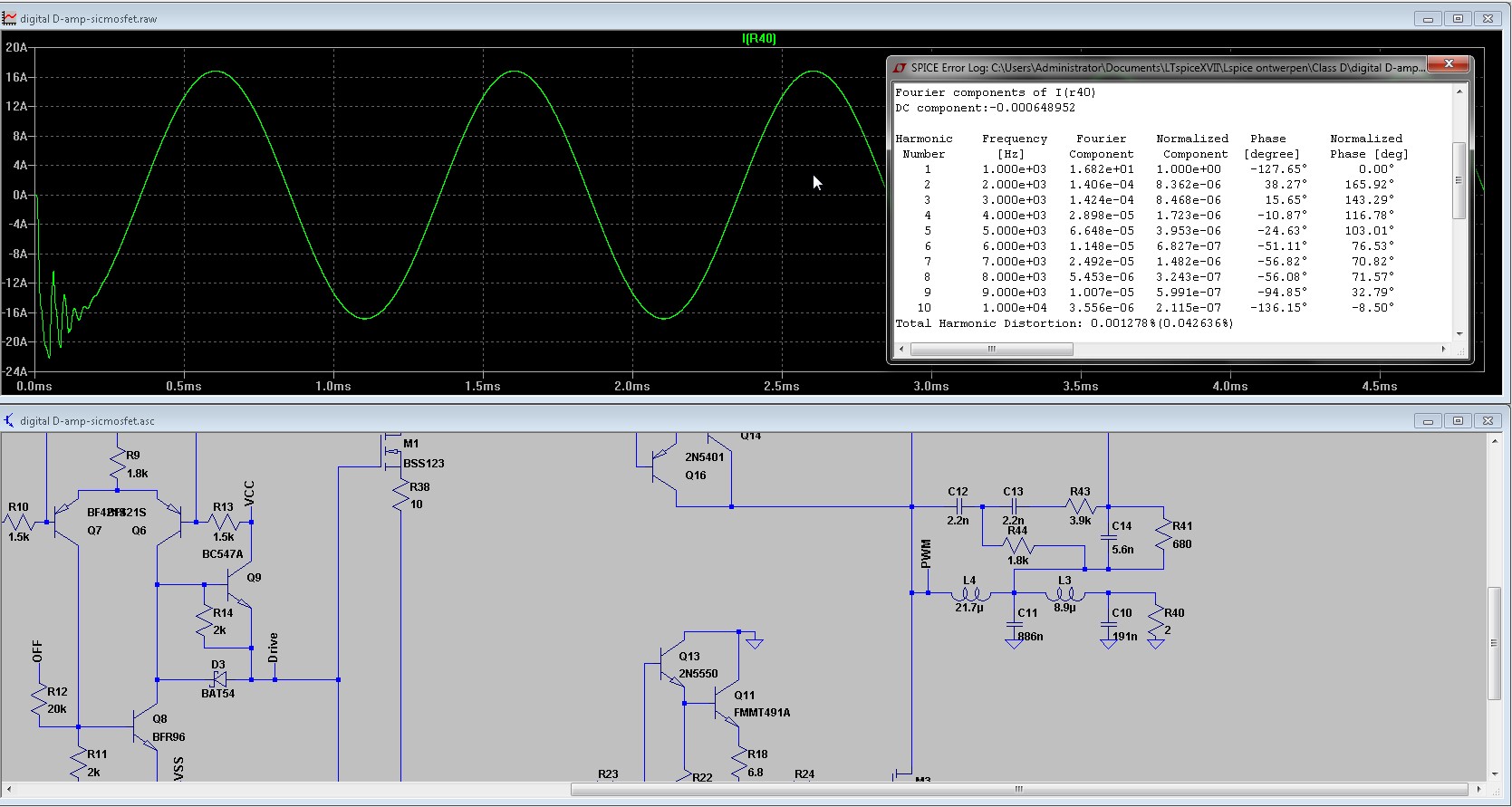

Did you guys tri sic mosfets? these are very fast, like 14-24 49 nS for 90 amps version, but needs a special driver as I did read, needs -2 to -5 bias voltage and 20 volts gate drive, these are as such complicated?
But in sim I get pretty low distortions, even on 8 amps 4 ohms.
with 1.4 amps output it is very very low, for simplicity there is not yet a proper dead time.
The feed forward network on output is quite nice to recover fase behavior for stable oscillation and frequenty setup together with the low pass opamp in input, I did read this stuff and have now sim it, I go try also with the IR 2011S chip, that way I can make better pcb with lower parasitics..
regards
regards
Hello kees52, can you post the .asc simulation file?
