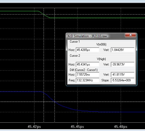

According to simulation i have around 18nS delay from comparator output to amp output.

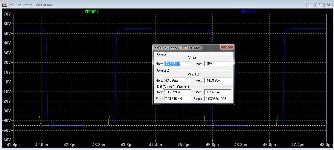

... seems a bit strange as IR2110 is specified at around 120nS .... here is a sim from High input of the IR2110 to High output .......
Ans a sim from LevelShift in to LevelShift out
But maybe you are not talking about IR2110 ..... ??
Ahhh so IR2010 has less than 18nS propagation delay ..... will have to look at that datasheet again ......

In real world, IR2110 with 5V logic supply and 12V gate supply, and at a temperature around 45ºC, will exhibit internal delays around 200ns. The delay figures given on datasheet tables are for 15V logic and 15V gate supplies, which results in shorter delays.
It all started because I was experiencing an overall propagation delay 30% higher than expected (by adding datasheet figures for all components in the signal path), so I decided to measure the actual propagation delays.
Sometimes datasheets from International Rectifier, ST and others reflect too optimistic working conditions on purpose, to obtain more attractive ratings and win on quick comparisons. Lesson to learn: Take some time to read all notes (even if they are put several pages away on purpose) and fine prints.
Same applies to IR2010, good but a bit slow.

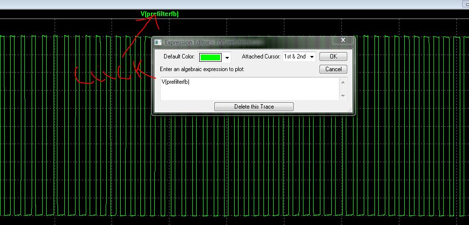

..... wonder how you got the 18nS if you didn't find the cursor
.... Anyway you just mouse click on the "legends" or signal names above trace window ... if you right click you get an option on useing either no. 1 or 2 or both for the choosen signal ....
