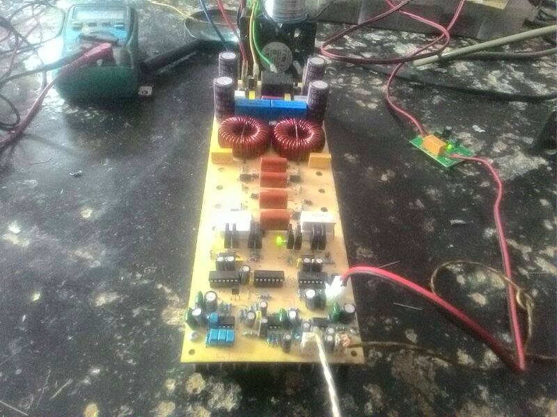

Sometimes people asking very simple circuit. By one input grounded, it cut many numbers of component so more more simple. So then, sometime you need to ask why someone create that amp, what the aim is.
This is most simple UcD Discrete I have ever. PCB Made by Yadi, wong mbantul.

Full bridge 90Vdc supply prototype by our friend.

Anyway, this is not a joke, a real thousand watts output DIY Class D amp.
Powered with Ex Cellular BTS Power Supply, Eltek Flatpack 2000, 4 pcs in series. To get 107Vdc at 37 ampere symmetric supply. Amplifier module is my design, D2KNeo with just one set IRFP4242. The amp can drive 4x18" speaker per channel easily. PWM speed is 300kHz.
