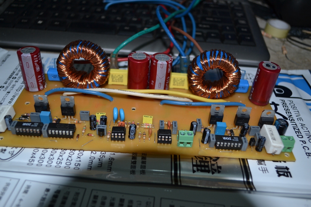

hi all busy perfecting smps and ucd semi discreet .that is lm 311 and ir2110 in ucd amp. all is well the amp is o.k and cool even at 2 ohms but ocp protections are the ones holding me back .i have made lorylaci ucd version with protection ,it works well but trips very soon / early. i think when the amp is 60% loud .
i wanted it to reach about 92% at 2ohm per channel because i wanted to use full bridge +/-70vlts fets used are a pair of irfb4227 per channel any help some one??. the schematic ic below and my layouts are below.

Try reduce your current sensor sensitivity by reduce R18.
Maybe half of it or more.

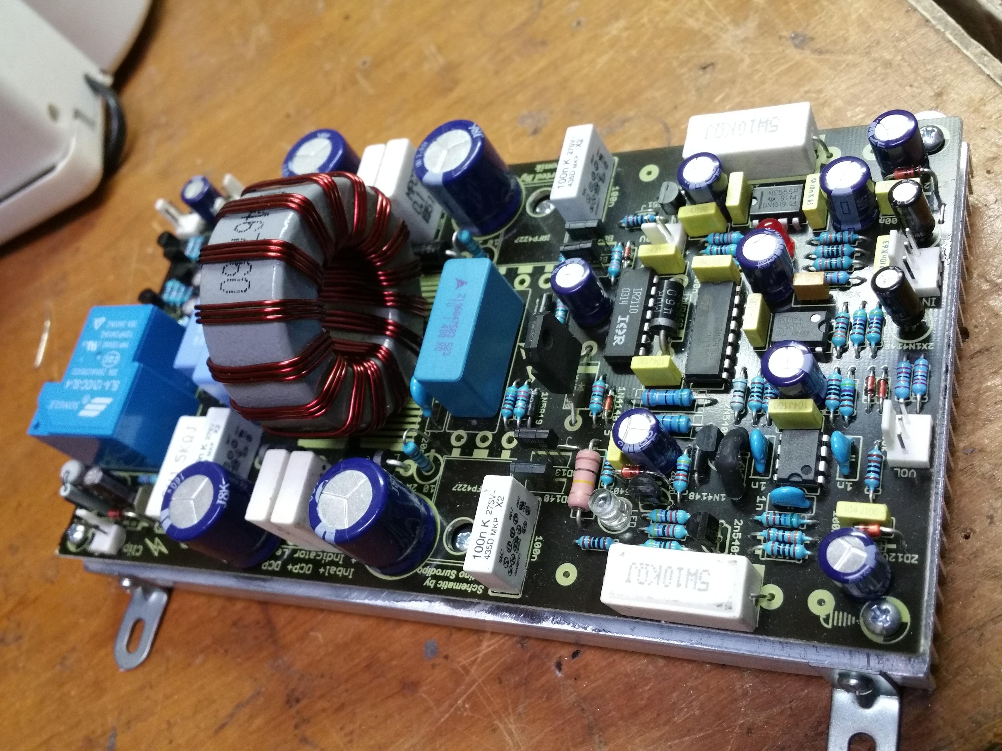

Good afternoon kartino The resistor r31 is burning very fast and does not oscillate the amplifier can help me. And I think the "q4" should not be grounded. View attachment class d 4r1000.BMP
hi all , a low power version class d smd and +/- 45volts maximum ,
i have tested both boards
have fun all

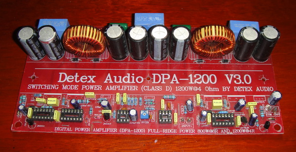

I recently finished my audio smps. With 2 irfp460 I had 1kw in test with resistive load. With 4 irfp460 2kw 5min same test. Big toroidal transformer. 50khz. Why many people say 600w with 2 irfp460 is the limit?
Apex d200 is the best quality and stability. I took the principle of d200 I added a fast protection i use irfp250n 100ohm gate m ur1560 parallel to each mosfet 30uh big toroid sendust core. For 74hc00n i use 4 inverter not 2 to increase dead time. 10k 2w resistor serie 5.6v zener. 7812 extra bias 12v. And it works wonderfully with + -95v 4ohm load resistive 50hz frequency. Sound is very good. frequency is 200khz

congrats protech , any photos ?? how long is your amp been operational?? please share your schematic with the modified inverter
