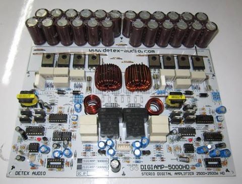

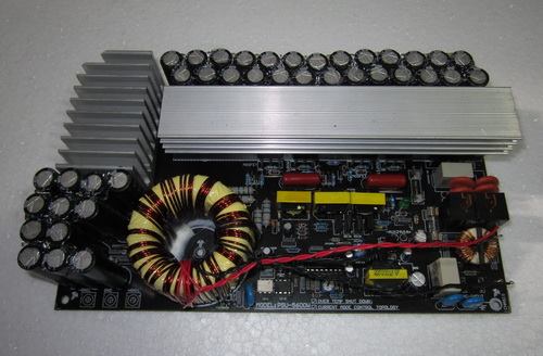

dETEX AUDIO FULL BRIDGE SMPS
https://www.facebook.com/photo.php?...3690158.49717.100002145681469&type=1&theater;)
here you go . lukas smps is great and many others below to choose from

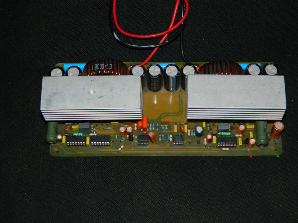

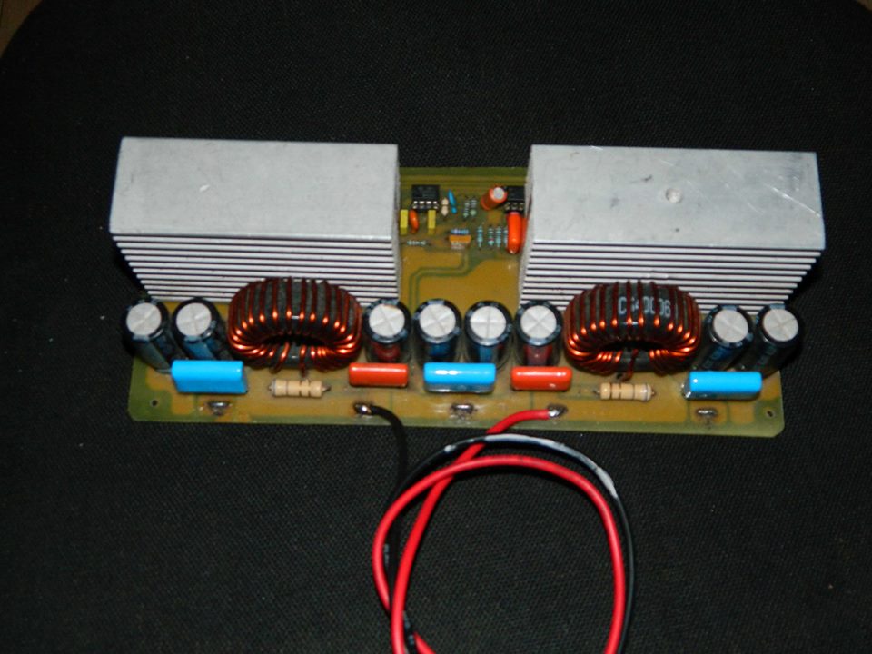

Hi Pergo
greetings finished dclass bridged amp will try your dc protector
warm regards
Andrew Lebon

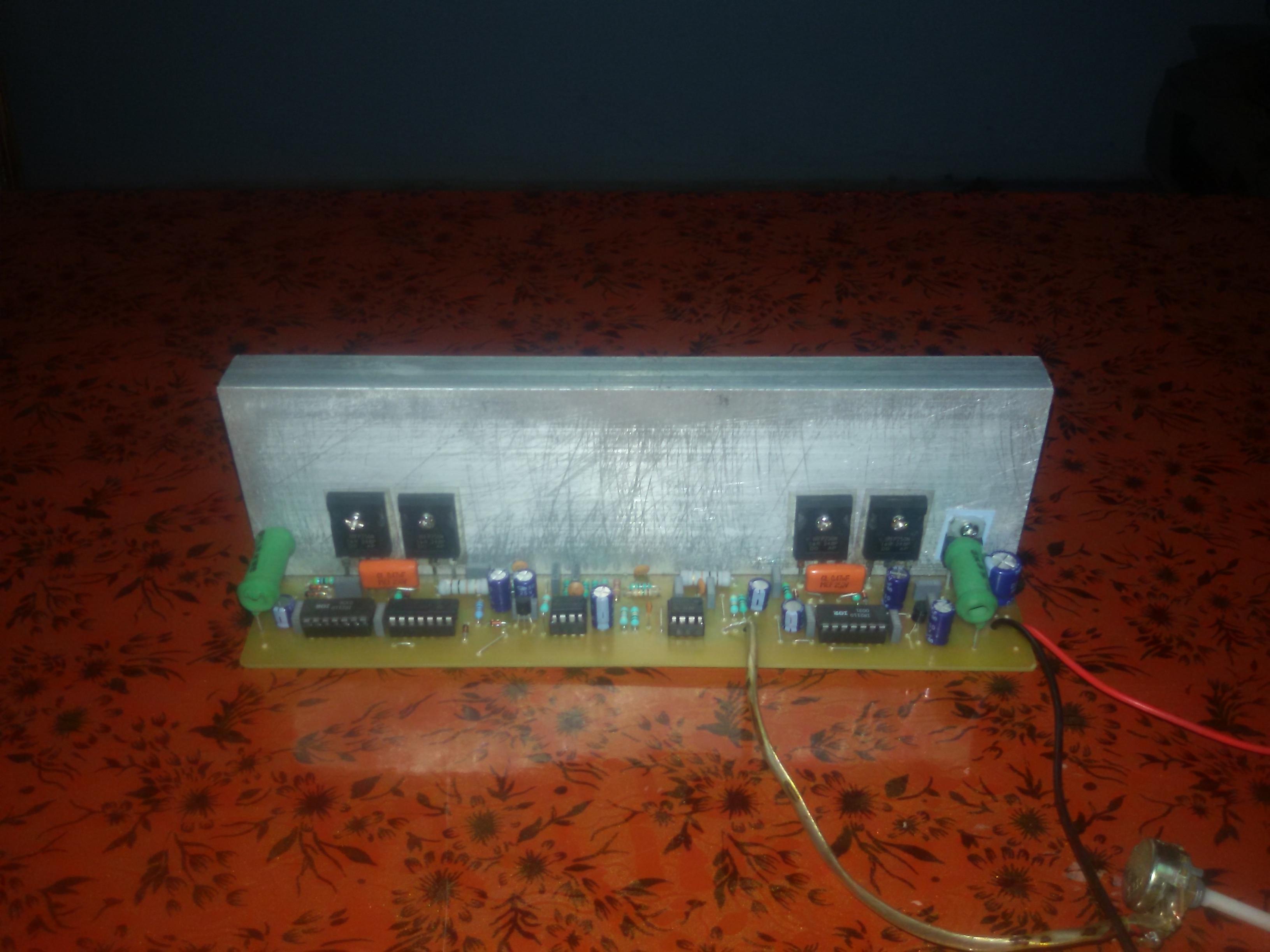

Hello sir.
Today i tested my dpa2400 d amp.
But have a dc at OP at 1 side. Wht is the problem............?
