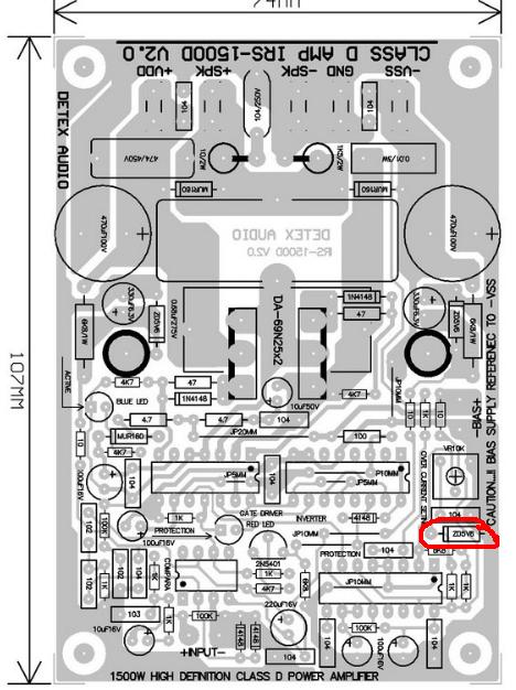

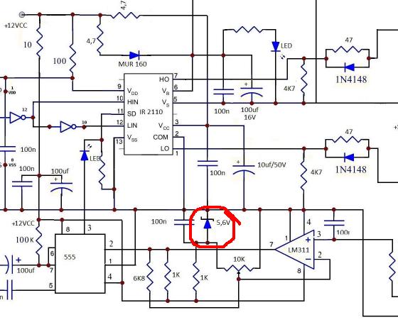

well as on the board or as a diagram? I apologize for machine translation.
правильно как на плате или как на схеме ? Прошу прощения за машинный перевод.

AUD600 PCB IRFP4768 Mosfet and AUD600 PCB with 2 Mosfets totem pole driver
Hello Guys
Nobody want give or share PCB files for supplier, often same with schematic, people make big secret
Detex Audio Thailand dont sell IRS amplifier Boards to me and friends,
he say, dont sell for foreigner and Thai People have foreigner friends,
crazy this guy !
I get angry this week and design AUD600 PCB by myself !
I accept to share files for PCB supplier and schematics with other DIY
Only manojtm share AUD600 schematic with me....
Have design double Layer PCB for AUD600
- add DC protect Crowbar (thanks to APEX)
- add Led for Power - Signal and Clip (thanks to APEX)
AUD600 PCB IRFP4768 Mosfet with Crowbar and LED Power - Signal - CLIP
AUD600 PCB with 2 x IRFP4768 Mosfets with totem pole driver, Crowbar DC protect and LED Power - Signal - CLIP

Hi Insomnia,
Thank you for using AUD600 amp
I am not discouraging you, your PCB design is not good for class D big GND loop will create more EMI in to the input and it will create cross talk when you using 2nd CH. Using Ground plane for reducing EMI
2. Use c18 close to the MOSFET for reducing EMI & RF
3. I am not suggesting crowbar for class D b'cause any issues causes in your PCB/components will create -Ve supply comes in SP line and it will damage 7414,2110 and MOSFET.
Regards
MANOJ
