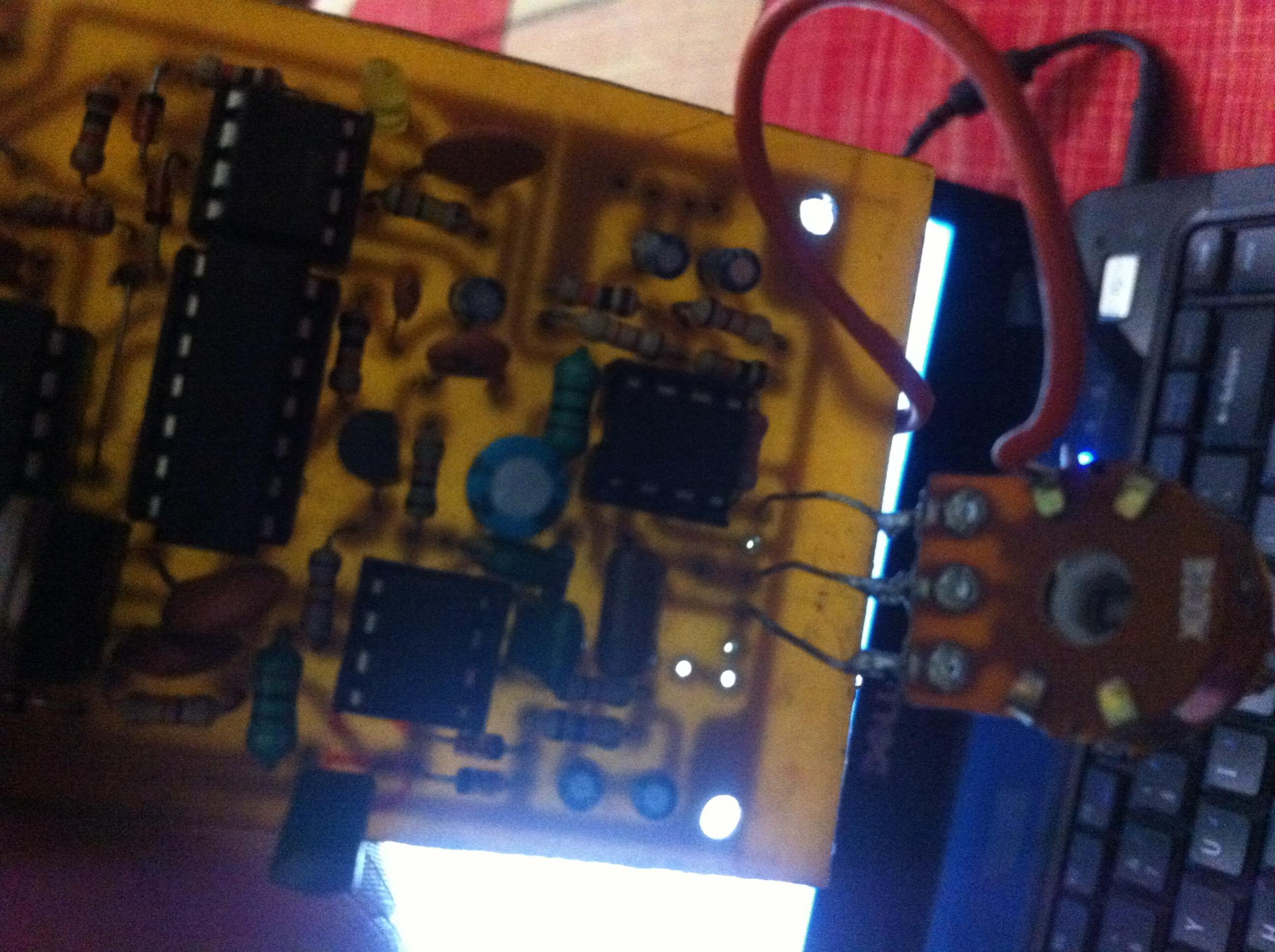

Hi Manoj:
I tried as you mentioned, given input to both -+ points one after another with respect to gnd. Still no sound from Spk.
But if I connect Pin-2 (tl072) to gnd through 220n or resistors like 1K then I get output.
Managed to prepare output inductor as per your instruction. Improved a bit, I used EE cores 24turns 19SWG wire. How many turns for emi reduction coil?
Raj

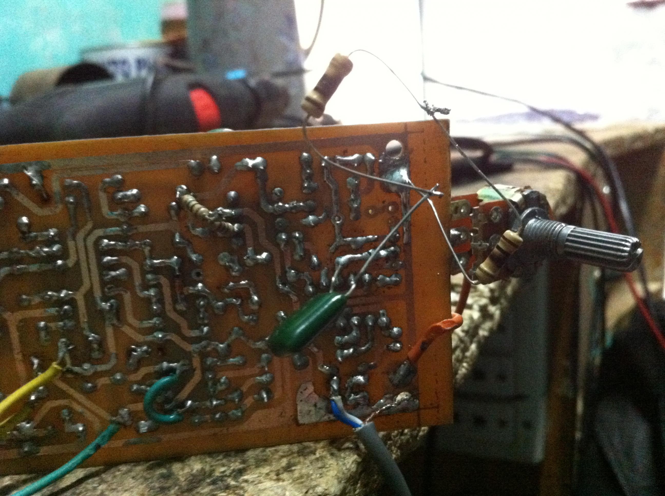

Hi Hadi/Manoj/Stewin:
I completed aud600 ver1.0 it works but has some problems. Now trying to solve them
1. If I give audio input to - or + sign with respect to gnd (giving any -/+ to gnd) then there is no output until I give gnd through cap/resistor to pin 2 of tk072 then I get output. Why?
2. My 47ohms resistors are burning instantly, HF is too high but how to control that?
3. I get choppy sound at higher volume.
NB: resistors in pic burned (value is ok) when I used them in 47ohms position.
Have you faced any of such problem? And how you fixed that?
Hi Raj,
VOLUME control(100K or 50K) side pin connected to 33K resistor from Pin-7 of TL072, center pin from Pin-2 of TL072 and another side from Pin-1 of TL072.
Regards
MANOJ
